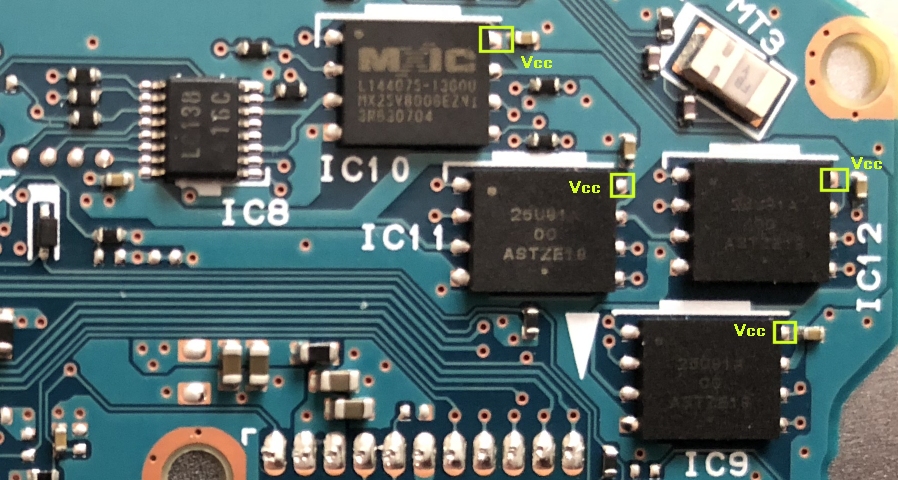

Just for completeness, there are 4 serial flash memory chips on your PCB (IC9 - IC12). The MCU uses two pins to select 1 of 4 at any one time.
The order of selection is IC10, IC9, IC11, IC12. I have no idea if all 4 chips need to be transferred to a donor PCB. Perhaps IC10 is sufficient?

There is still a problem at 5Vout. Is the same 82.7R reading present in the Vcore circuit at the point I have labelled as "+5Vout (from IC17)"? If so, then I suspect that IC7 (BD91364) has also failed.
V2 is shorted to ground (4.5 ohms). What voltages do you measure at V2 and V1 on the good PCB? I'm concerned that V2 may supply the power for the serial flash memories, in which case one or more of them may be damaged. If so, then even professional data recovery may prove impossible. :-(
What resistance do you measure between the Vcc pin of IC10 and each of V1 and V2? Note that all the Vcc pins are connected together, so you need only measure one of them.

The surge damaged the motor controller (IC2), passed through inductor L600, and then clobbered one or more components on the V2 supply (2.5V).
V1 (1.7V) powers the SDRAM (IC3), while V2 powers IC8 - IC12.
Vcore powers the MCU only. The MCU also requires a Vio supply, either V1 or V2 or both. Therefore it is possible that the MCU is the source of the short on V2, in which case there is still hope for the flash memories.
In short, you could try to dump the flash memories and establish whether they are OK. Then you could transfer them, or their contents, to a donor PCB.

You won't be able to read the flash memories in-circuit (because their supply rail is missing). You need to remove them and read them in an external programmer. Make sure the programmer is set for a +2.5V supply voltage. You must not damage the chips.
Alternatively, you could cut through the Vcc traces adjacent to pins 7 and 8 of each IC (with a scalpel?) and then retest the resistance betweens pins 8 and 4 (Vcc & Gnd) and 7 & 4 (Hold & Gnd). This will enable you to confirm which, if any, of these chips is shorted. Then you may be able to read the chips in-circuit with an SOIC clip and external progammer.
SOIC 8 Clip :
http://www.hddoracle.com/viewtopic.php?f=110&t=85
Re: Power Supply mixup has killed all my hard drives!
January 29th, 2018, 15:12
This would be my plan.
Cut the power traces to each of the flash memories.
Read the non-shorted flash memories in-circuit.
Upload the dumps to http://files.hddguru.com
Compare the dumps between drives.
If any dumps are identical, then these will contain no unique (aka "adaptive") data.
Only those dumps which contain unique data will need to be transferred to the donor, assuming the donor PCB is identical in every other respect.
