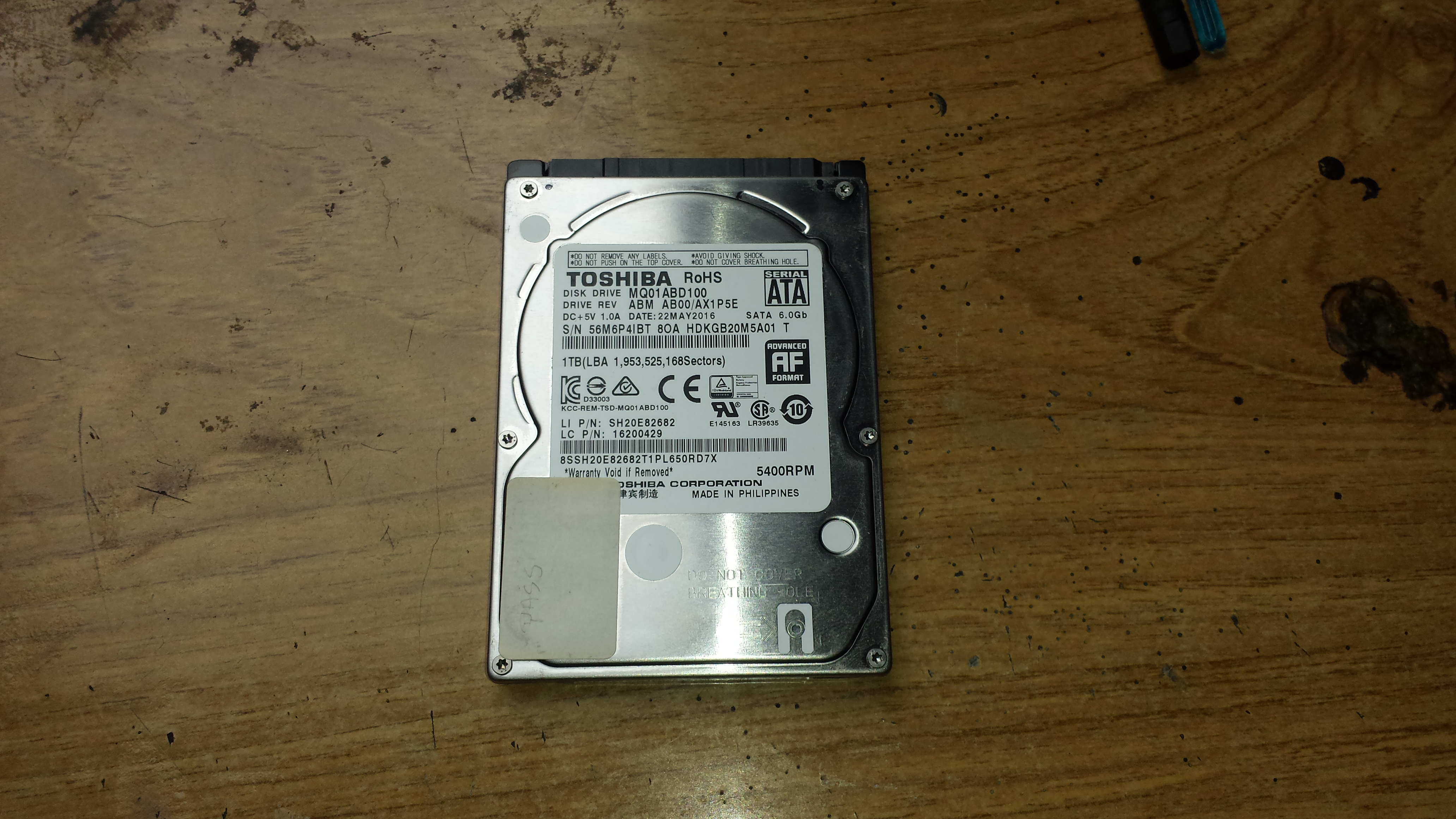

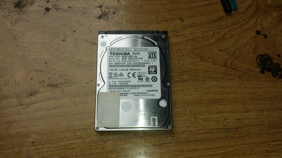

Moltke friend yes change this values. And change also power on time attribute. BGman fw on label is ax1p5e but in rom code is axg5e also I see. But everywhere my Toshiba detect with fw ax1p5e. Later attach picture with my disk.
 Post subject: Re: Toshiba MQ01ABD100 - Master password changed, locked by
PostPosted: March 24th, 2018, 6:13
Posts: 428
Here is label my disk.
PostPosted: March 24th, 2018, 6:22
Posts: 428
Ok, but not have PCB G003235C, only G003138 from older ABD and ABD Vs Series.
I can resolder ROM chip to other PCB like G003138 and see reacts, if block is in ROM or Security Sector.
