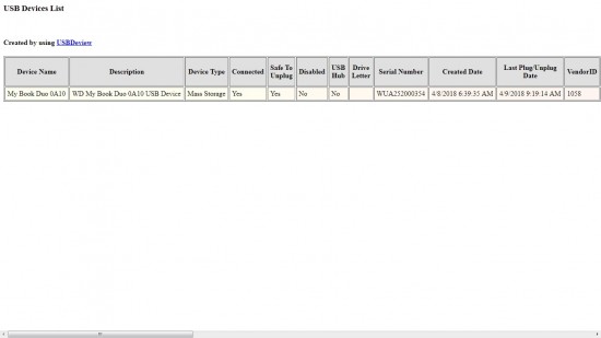

@metafizx, does your working My Book Duo spin up its HDDs if its USB cable is not connected, or will it only do so when it detects a USB host?
If you connect only the working PCB to the USB port, how does the OS see it?
You could use UVCView or USBDeview:

yes that is correct. The unit only powers on when the USB is connected.
I'll try it with just the PCB

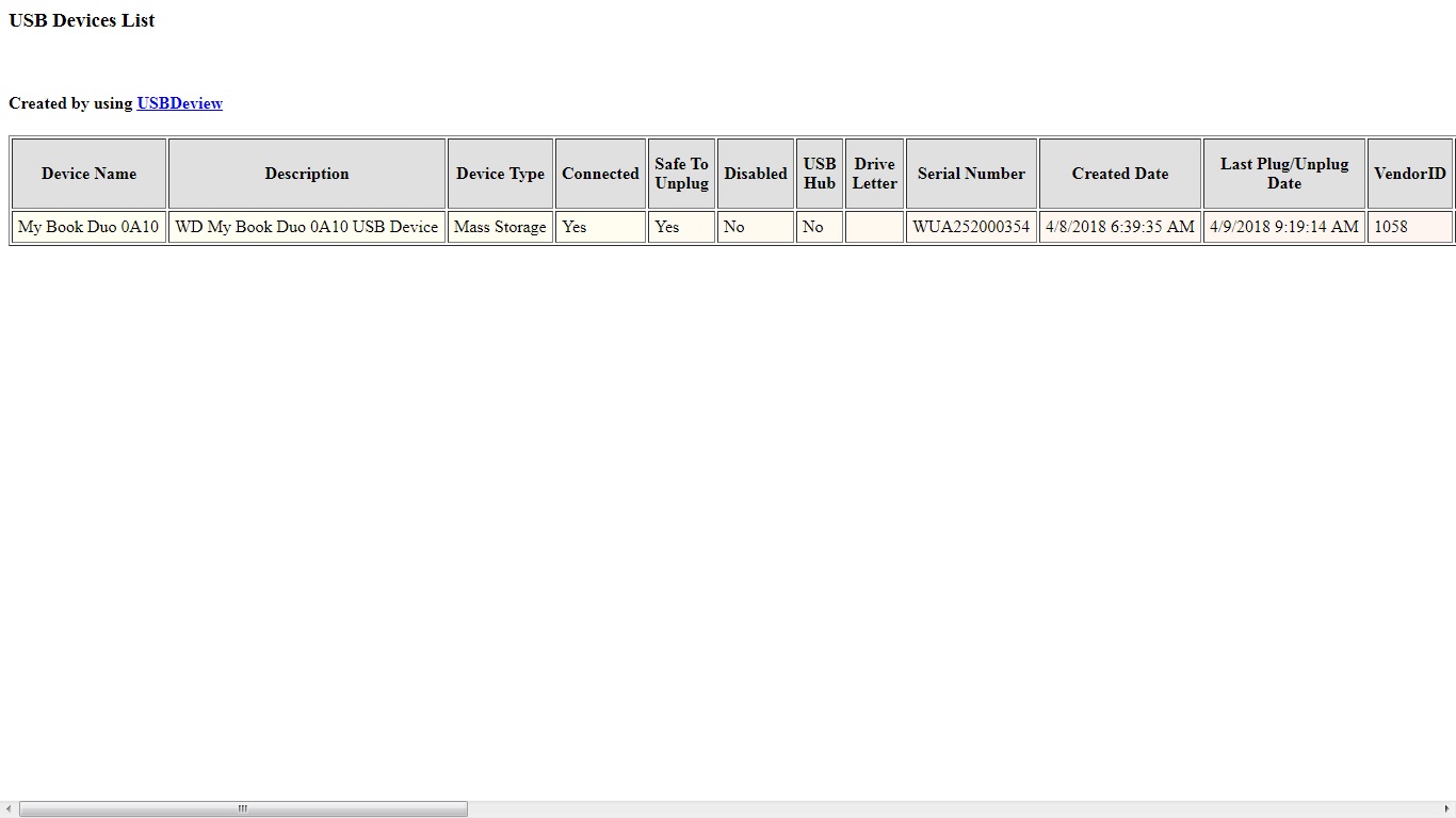

working PCB with no drives is shown connected in Windows.
 Post subject: Re: WD My Book Duo controller failure
PostPosted: April 9th, 2018, 15:19
Posts: 17342
Your results would suggest that the fault is with the JMicron or Asmedia chips, or the USB3 connection. Can you communicate with the PCB via a USB 2.0 cable or USB 2.0 port? USB 2.0 uses different signal wires.
Your next test would involve shorting the HOLD pin to ground (on the bad PCB), as explained previously.

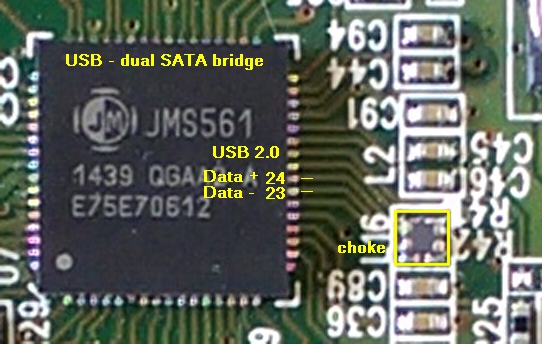

To eliminate the USB hub as a potential culprit, one could possibly remove the choke at L16 and then connect a USB 2.0 cable to the bridge-side pins of L16. I believe this would enable direct access to the bridge via a USB 2.0 port.

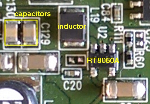

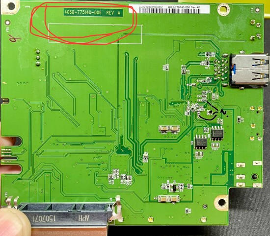

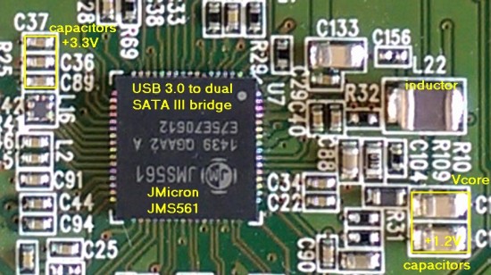

Hello guys,
i have also a problem with this controller.... I have the same mainboard.. maybe someone can halp me?:
I checked the caps C37, C36 and C89 for the 3,3V line by theJM Chip... C36 and C37 just have like 1,2V..... (see IMG 1)
I also could check a short on the caps + inductor on the image with the RT8060A.... (see IMG 2)
I am not recive the 3,3V on the SATA.. I realy couldnt figur out why :( Maybe someone can help me?

I checked the caps C37, C36 and C89 for the 3,3V line by the JM Chip... C36 and C37 just have like 1,2V..... (see IMG 1)
That's correct. I was mistaken.
Something is wrong here. Either a capacitor is shorted, or U2, or one of the chips that is powered from this supply.
I would try to find other shorted capacitors adjacent to the other ICs. This will identify the possible suspects.

fzabkar, Thank you for the fast reply,
i saw that the U2 (RT8060A) is burned. But i dont know where i can gat a spare part for it...
Do you think i could use another conrtoller and solder the old U5, U4, U11 and U12 on the new board? I am afraid that it will not work because of the encryption.

Try Digikey in the EU:
https://www.digikey.com/en/products/detail/richtek-usa-inc/RT8060GB/3078324
I would remove the IC and retest the PCB for shorts. It could be that the chip died because of a short on the output.

fzabkar, i removed it but there is still the sam short. I even removed the caps und and testet it on the board... both sides are grounded, so i think it is actually a chip?

Each chip will have a small, local bypass capacitor at its Vcc pin(s). It could be that one of these bypass capacitors is shorted.

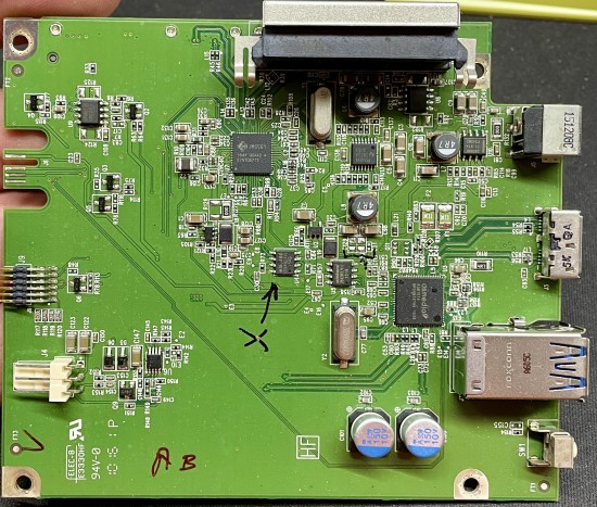

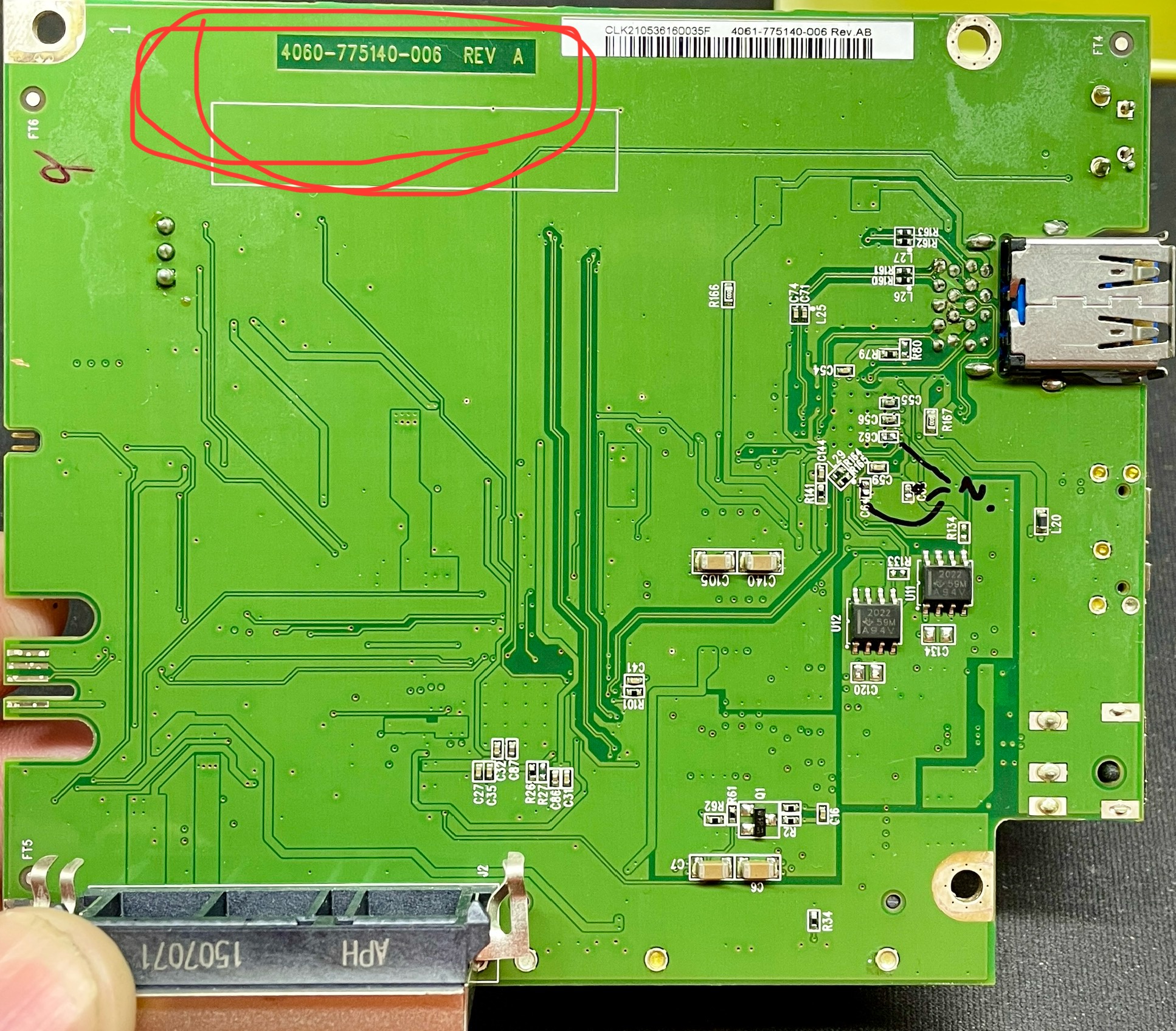

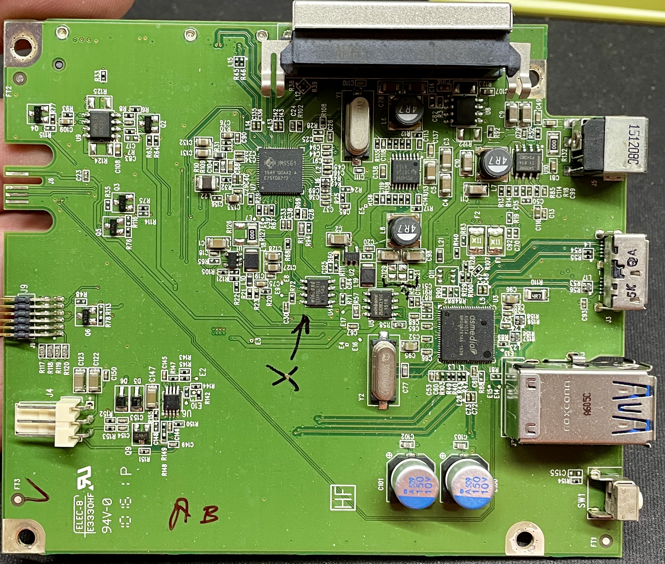

Hello, I have a My Book Duo (2x8TB) WDBLWE0160JCH. It worked fine for 8 years (RAID 1), but a few months ago both indicators turned red after turning on. Then I found this problem with the hardware encryption, because it seems that one part on the board (the communication controller or the part holding the decryption key) is short-circuited.
After discussing with the WD support center. The solution may be to insert my disks into another case of the same model My Book Duo (WDBLWE0160JCH). Different capacity models should also work (WDBLWE0120JCH, WDBLWE0080JCH, WDBLWE0060JCH, WDBLWE0040JCH).
Can someone help me find one of these models (a case will suffice)? Or is there another solution?

If you believe that U4 stores an encryption key, then why would you expect that a replacement PCB, with a different key, would work?

That was the official response from WD support center. I am not sure if this works so I sent the question here. Do you think it will not work because each My Book Duo has a different encryption key on the electronic board?
