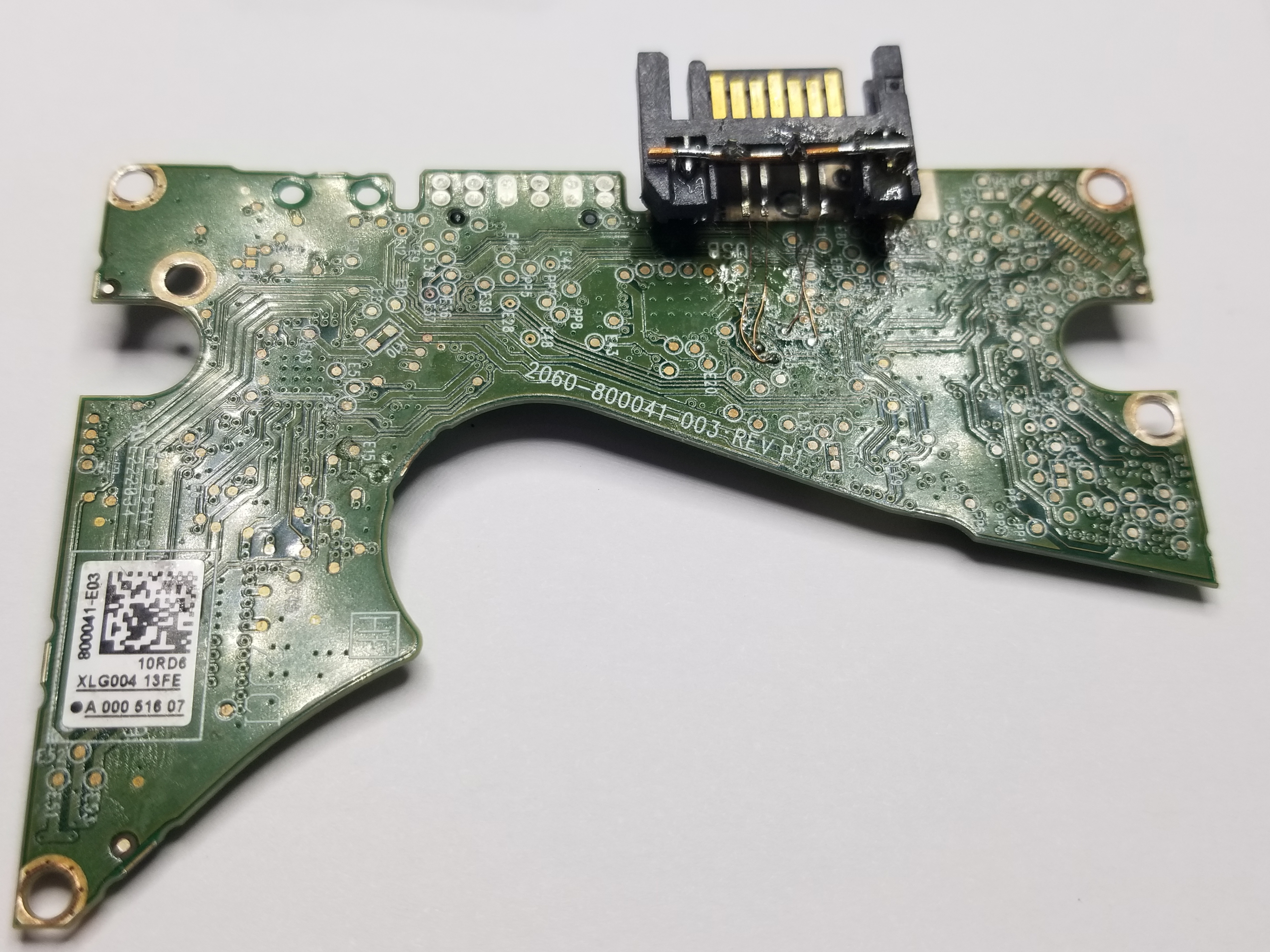

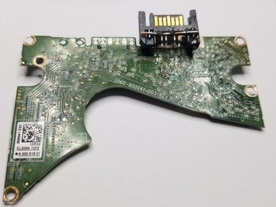

adding to the notes on this spyglass pebble issue:
Put spyglass rom on sata converted pebble
now board just flashes and doesnt spin up.
trying to recover the spyglass
Donor===========
i took a board 800041-000-revp1
C:\PC3k\!Profiles\WDCMarvell\Pebbleb\WDC WD30NMVW-11C3NS2-01-01A01-WD-WXC1E25D0PY3
converted to sata
put it back on the drive and the drive works fine
then I wrote the patients rom to it
now it flashes
It doesnt spin up
cant get into kernel mode
cant bootcode mode either
going to have to resolder the rom to reprogram it.
=============== patient
patient board is same
C:\PC3k\!Profiles\WDCMarvell\Pebbleb\WDC WD40NMZW-11GX6S1-01-01A01-4590_carl\Data\ROM
same exact board number 800041-000-revp1
One is spyglass other is pebble
I could read both roms through the serial port.
if I convert to sata can I decrypt
or repair ?
Can I fix sa slow problems through sata then convert back to USB

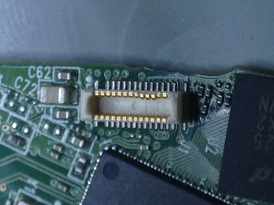

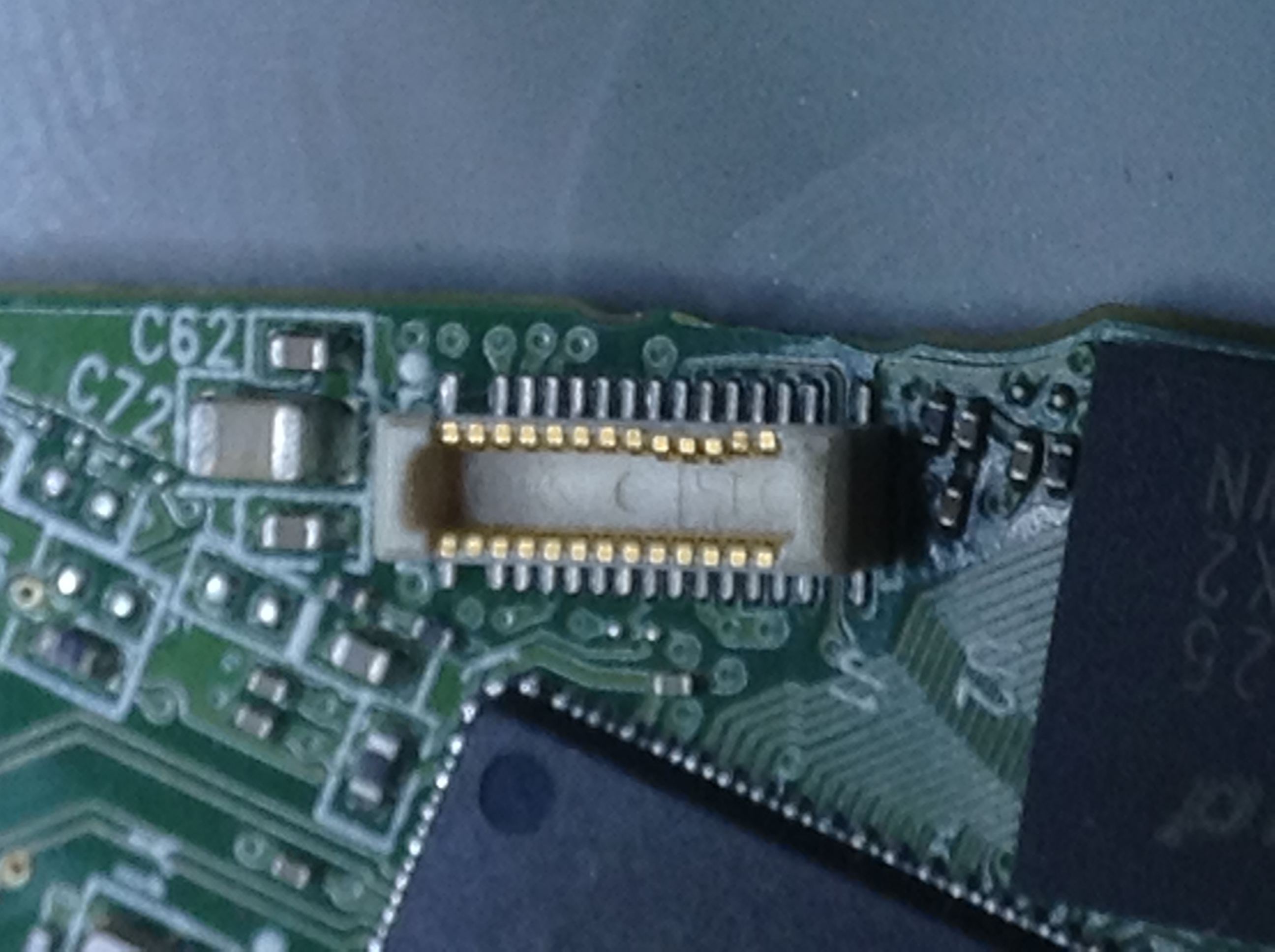

spyglass boards dying....
I suspect that we may be damaging the boards when removing them from the body.
the head connector can be pretty stiff
the pcb is very thin
so perhaps the board is flexed too much and some of the ballgrids get broken.
I have started using a tool to pry the head connector rather than stressing the board.

I have given up trying to use SATA boards for these USB drives. I now have several of the USB boards with SATA connections soldered. Much easier and does not kill the board.

@ddrecovery, for research purposes, do you also agree that the act of removing the board from the hdd is what damages it ? So you just solder a sata connector to it while still screwed to the hard disk ?
or the key detail would be when writing the rom to a new (sata) board ?
 Post subject: Re: WD40NMZW PCB Issues
PostPosted: June 25th, 2018, 20:01
Posts: 1777
Location: Phoenix, AZ USA
We put the SATA connector on the USB board off the drive as you have to remove some caps to do this.
I don't think its heat from soldering that is killing the SATA board as we soldered the patient ROM to the USB board on several occasions as a test and have not had the same issue. The boards are basically the same boards so you would have through the issue would have affected both.
So maybe it is a flexing issue, as @drdoc, we use a pry tool at the bottom of the board just under the connector and the board comes off without flexing. In fact we do a similar thing now with Rosewood drives. So maybe the flexing was the issue before we learnt how to handle them.
I have also had a few SATA boards die while working on the drive SA blocking mods etc, so it maybe its a really bad design or has a faulty chip.
Perhaps equally important is care in putting the PCB back on the drive.
Got a hold of a SATA Pebble Beach PCB and the pins on the connector are loose/damaged.
