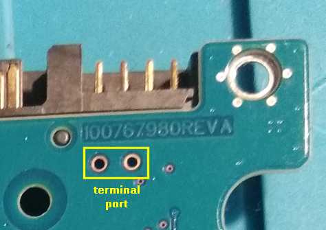

mrDRECula wrote:@fzabkar I am sure the voltage works fine as i tried to read the same model and it reads fine
ISTM that you may not understand what I'm saying.
You stated that you were only able to see "&&&&" at the terminal port. I'm suggesting that you measure the voltages at the port to see if they may be too low for your 3.3V (?) TTL adapter.
Re: st2000LM005
April 26th, 2018, 8:46
@fzabkar sorry for the delay in the answer, I undestood what you were asking, probably i didn't explain it well. As the pcb was successfully readed with the donor rom I doubt the issue is the terminal. If the problem was the voltage then it shouldn't read the donor in first place.
