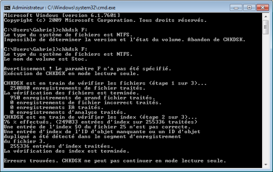

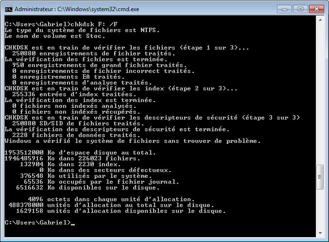

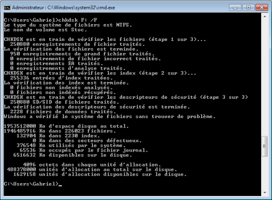

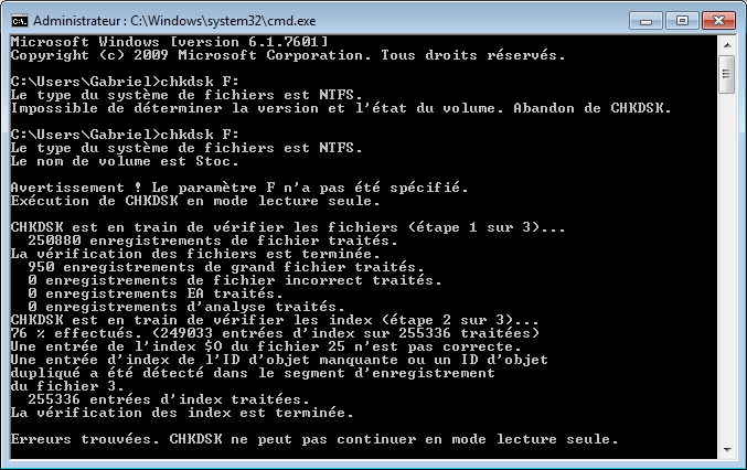

So I did it, I applied my “patch” : CHKDSK worked right away, but (launched at first without the /F switch so in read-only) reported errors in index $O of file 25 (file 25 being $ObjId), and an error in the record for file 3 (file 3 being $Volume). Then, I tried to parse $ObjId/$O, hoping to find the correct value, to no avail. I did find 3 or 4 variations of the first value I had found in “faef7def55a1d4b.automaticDestinations-ms”, which I tried one by one, but CHKDSK gave the same output. Then I realized that there were a gazillion of variations of that very value in “faef7def55a1d4b.automaticDestinations-ms”, differing by the first two characters, so that couldn't be the actual ID. Then, I don't know why, I had the idea of looking inside System Volume Information : on a valid partition, I opened “tracking.log”, and right at the begining there's the name of the machine on that system, followed by the 16 characters ID found in $Volume. So I copied the value from “tracking.log” on the corrupted partition, pasted it into $Volume (in both $MFT and $MFTMirr), launched CHKDSK again... no error this time ! The partition was still not accessible, probably because it had to be properly re-mounted. I launched CHKDSK with the /F switch (which requires to unmount the volume), it found no error as before, and then the partition became accessible again. Ouf ! :)
(The first command was executed before the patching : CHKDSK couldn't identify the state and version of the volume and aborted.)
(I renamed the volume “Stoc” instead of “Stockage” as it was called before, so as to have the same number of characters as in the $Volume MFT record from another partition named “TEMP”, to stay on the safe side and avoid an error due to some unexpected offset, and to be sure that the “used size” value would match, since I don't fully understand the structure of the record.)

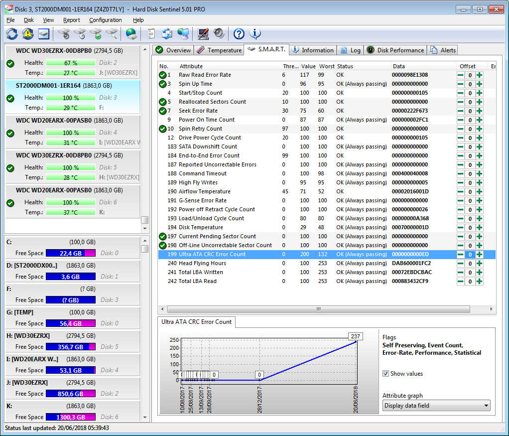

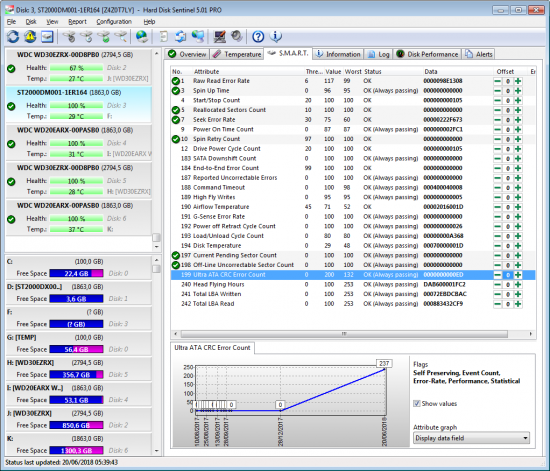

Now, does anybody else – aside from “Spildit” – think that this drive could still have a “silent” hardware issue, despite the fact that the S.M.A.R.T. status shows currently no worrying value ? I know now that this range of drive has a bad reputation, but can I still trust this particular unit, for now ?
ST2000DM001 Z4Z0T7LY HD Sentinel SMART Ultra ATA CRC Error Count.png [ 157.71 KiB | Viewed 18264 times ]

Well, you could show rocky horror pictures from any brand / model of drive, couldn't you ? In this particular case nothing is said about the conditions in which the drives were used, perhaps they sustained vibrations or shocks way beyond their specifications... or perhaps not, but pictures are not enough to tell the whole story. It's a bit like showing a chest radiography from a russian guy who was born in Tchernobyl in 1986, smokes like a mofo since the age of 12 and works in an asbestos disposal facility, and saying, see, russians have bad lungs ! :)
I'm willing to trust the near unanimous opinion expressed on this forum that these drives have an inferior design, are made with lesser quality materials, and are generally less reliable statistically than their counterparts from other brands (although it's not very clear which ones – only HGST seems to have a stellar reputation here, but I've seen one fail badly, and as far as I know way fewer units are sold worldwide compared to the two giants Seagate and WD), but some statements about Seagate are clearly blown out of proportion. Caricature can be funny for a while but it doesn't help in approaching the truth. If all Seagate drives were so bad and utterly unreliable, the company would face a huge worldwide backlash and would soon disappear, if all this is true, if they haven't produced a drive in 10 years that lasted 6 months, how can it be explained that the company is still a major player in this field ?

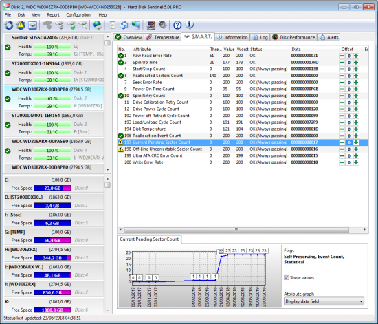

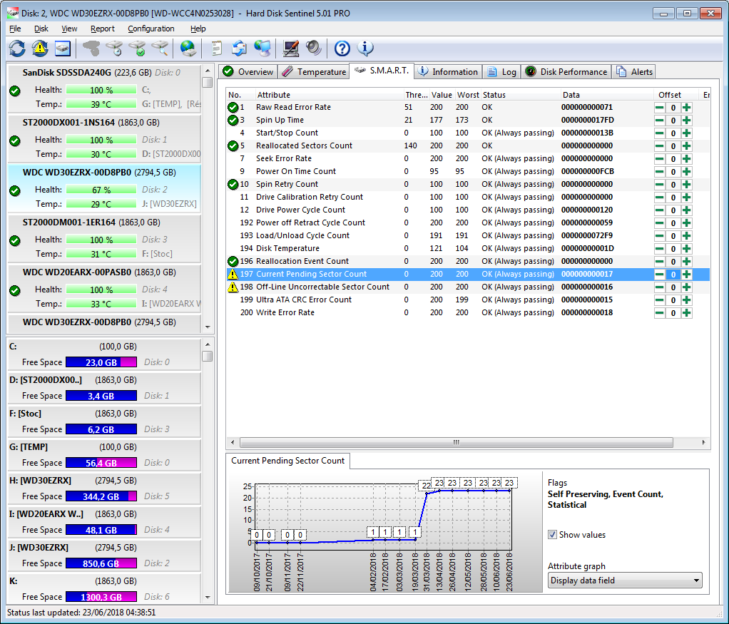

[quote="abolibibelot" And I have the feeling that even among data recovery experts, many would have considered this a lost cause, or at least “not worth the trouble”.)[/quote]
Thats because they are experts, and they work in data recovery. The job is recovering the data. The most trusted way would be to just extract with R-Studio, for example. Why mess with direct editing of the partitions when not necessary , and possibly making another customer wait ?
 Post subject: Re: Weird logical issue (“RAW” NTFS partition)
PostPosted: June 22nd, 2018, 22:50
Posts: 309
Location: France
No they wouldn't.
They would simple hook up the drive to something like PC-3000 DE or even use simple methods like open the drive with R-Studio and directly extract the data.
Yes, nobody would bother to fix the partition by hand because it's a time waste and no-one in it's right mind would even "consider" to re-use that drive even more "gamble" with that chkdsk !
You were very lucky so far and that's it.
What I did was relatively painstaking because I'm relatively new to this, but knowing what I know now I could probably fix a similar issue in a fraction of the time necessary to extract the whole contents (although it's a wise safety measure, especially if there's any doubt about the drive's fitness status) and write it back (if it turns out that the drive is fine). I'm wondering what a “regular” computer repair technician – i.e. not a data recovery expert – would do in a case like this, if a client brings a drive in the exact same state and wants it “fixed”.
