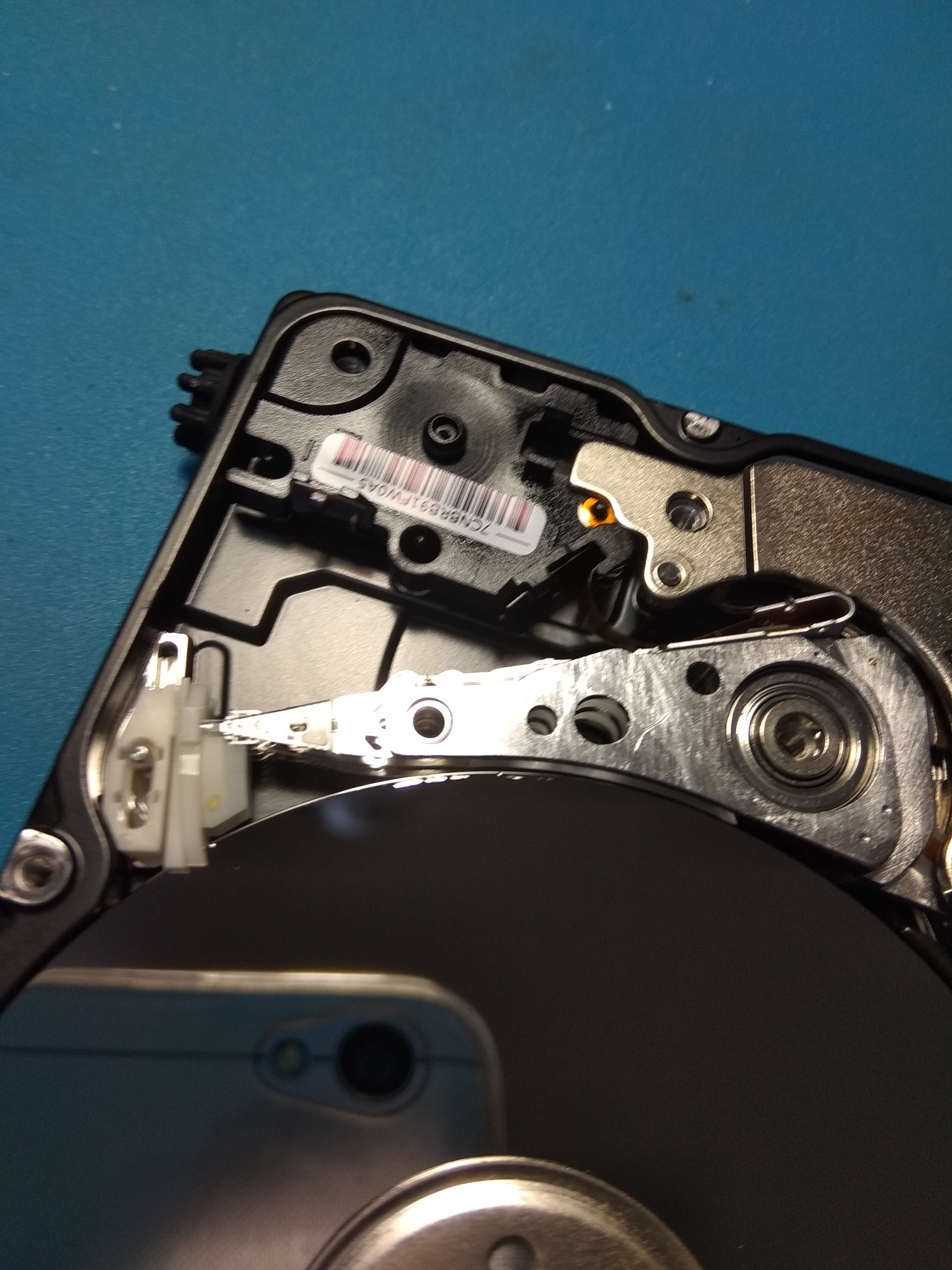

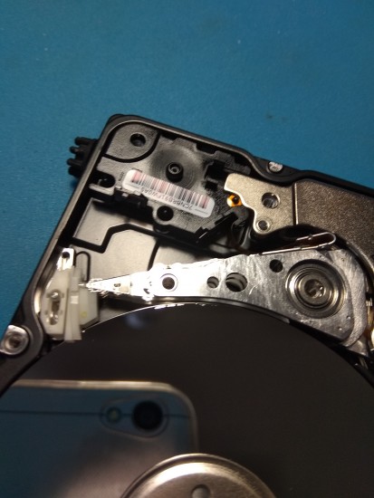

The dishes have scratches as shown in the picture. Right on the periphery.
I have not removed the plates to check the lower ones yet.
I'm looking at how to make housings with transparent slots to see the movement of the components. I'll show you already.

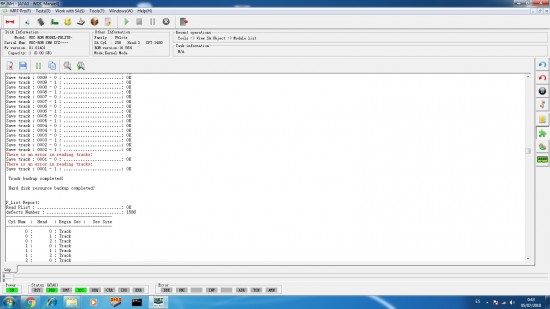

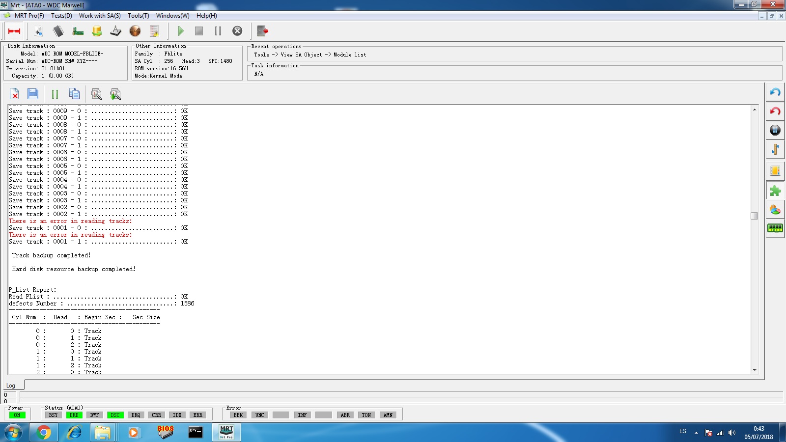

PList seems to be correct.
But the ZONE ALLOCATION TABLE is wrong.

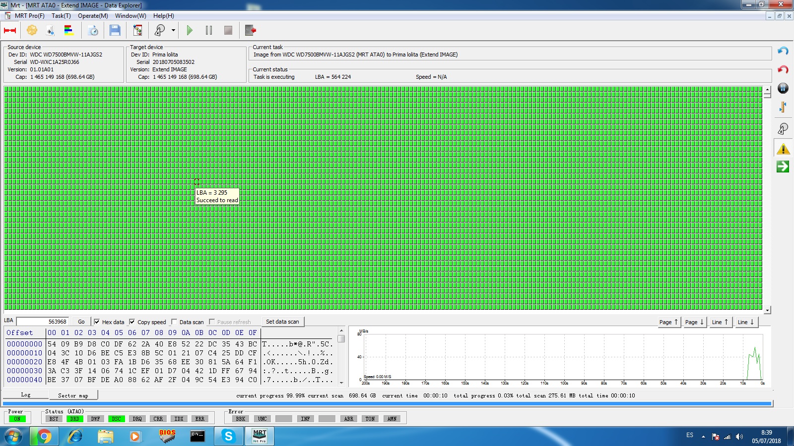

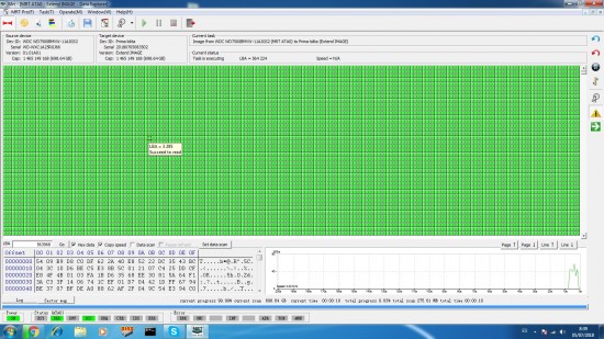

 Post subject: Re: Problem wd7500bmvw-11ajgs2
PostPosted: July 5th, 2018, 2:42
Posts: 474
Location: spain
thank you very much to all.
I'm already taking the data.
