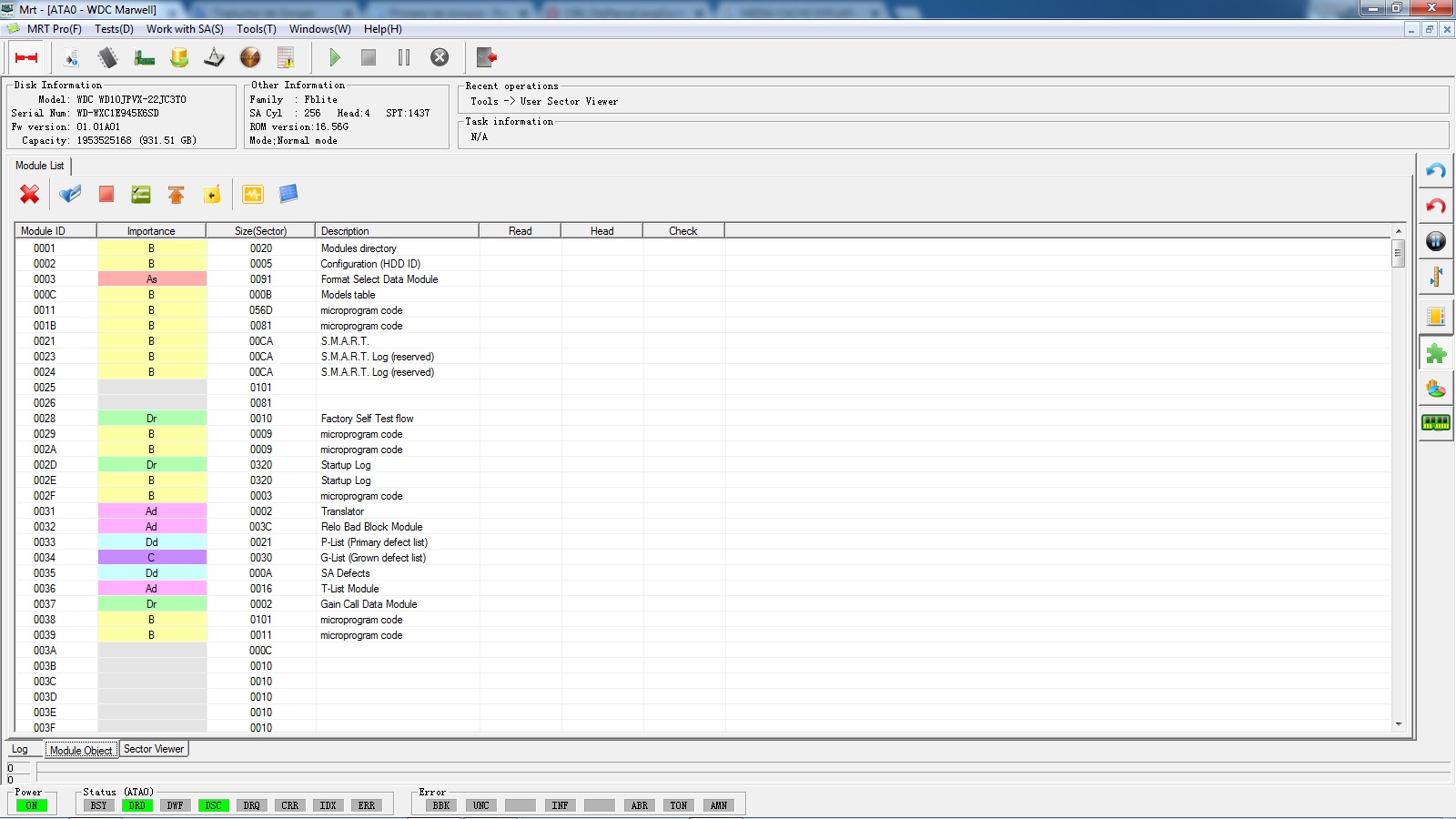

Re: WD10JPVX-22J3T0
August 27th, 2018, 17:17
I modified the module 0x01. When switching off and on, it returned with the same values.
I modified the module 0x01. Leo 0x11 and load the new 0x01.
I open the modules 0x31 and 0x33 and they open with the new size.
Modify the value of the size in the modules and now if you let me record the mod 0x31 that before could not in the copy 0 for errors in the SA.
I turn the disk off and on and read the modules as I modified them.
I check the information but strange things come out (it may be normal because it was a disk with many defects). Disk access is correct.
I think your idea is very good, because at the moment in my case it has allowed me to record a module (0x31) that I could not before.
Greetings.

@ Mr. Frank, I need to relocate Mods. 33 and 31 in 01 If possible.
Thanks in advance.
Modules.rar
(12.4 KiB) Downloaded 775 times
Re: WD10JPVX-22J3T0
August 28th, 2018, 17:55
unknown wrote:@ Mr. Frank, I need to relocate Mods. 33 and 31 in 01 If possible.
The drive has 1437 (= 0x59D) sectors per track, whereas the size of module 0x33h is 0x95C. If the drive has a radial scratch across the SA, then ISTM that relocation would be impossible. The same would apply to module 31h (size 0x5A5).
Why not simply truncate your modules, as explained earlier?
Re: WD10JPVX-22J3T0
August 28th, 2018, 18:38
unknown wrote:Why not simply truncate your modules, as explained earlier?
Yesterday after editing the modules, I regenerated the translator and I had access to the data and the modules 0x01, 0x31, 0x33 followed as they were edited.
I have the HDD working although it is a defective disk.
