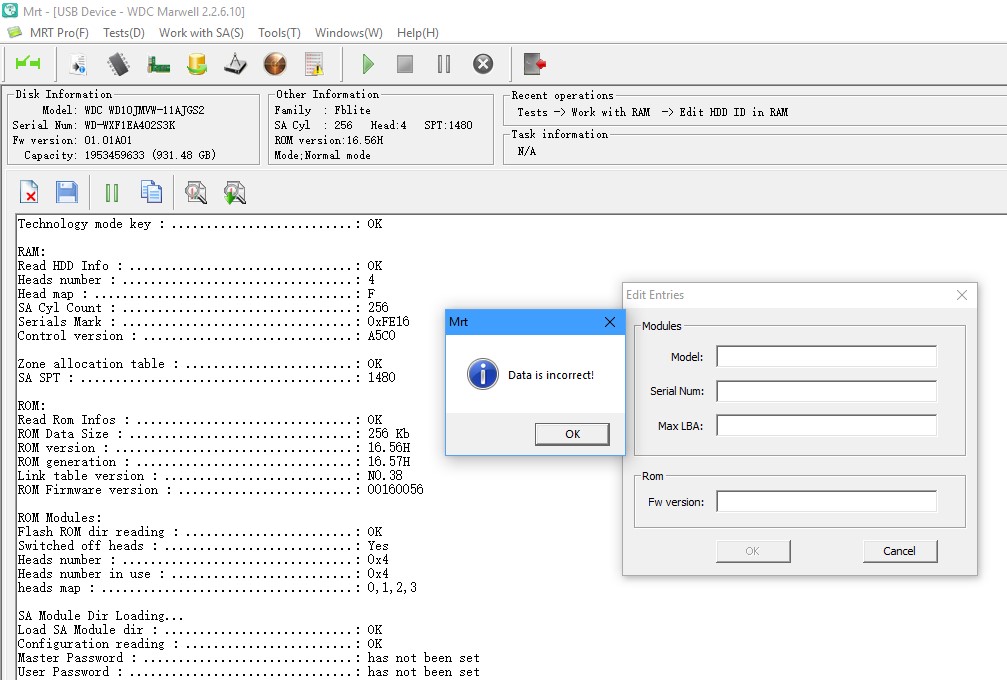

any help to decrypting data ?
BTW i dont access to HDD ID on sata board and USB board , maybe its related with this issue ?
and i check for damaged modules only this modules has error
2D 2E 6F 12D

Can you post sector 0 ?
here sector 0
0-0.zip [665 Bytes]
Downloaded 325 times
 Post subject: Re: How to hot swap WD10JMVW Fblite for data recovery
PostPosted: November 27th, 2018, 14:36
Posts: 1721
Most likely the drive is encrypted. (SmartWare....etc)
Customers always lies. Try to download WD security and run it while the drive is connected (via USB)
And see if the drive is asking for a user password.
