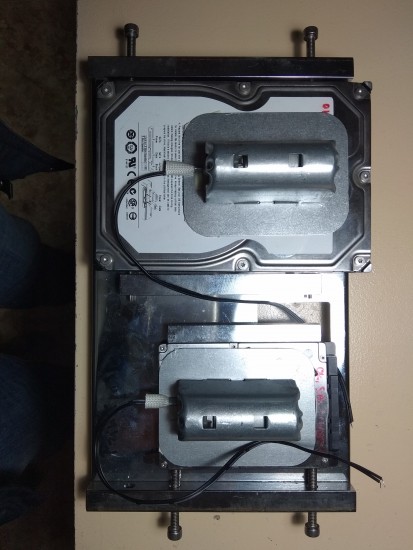

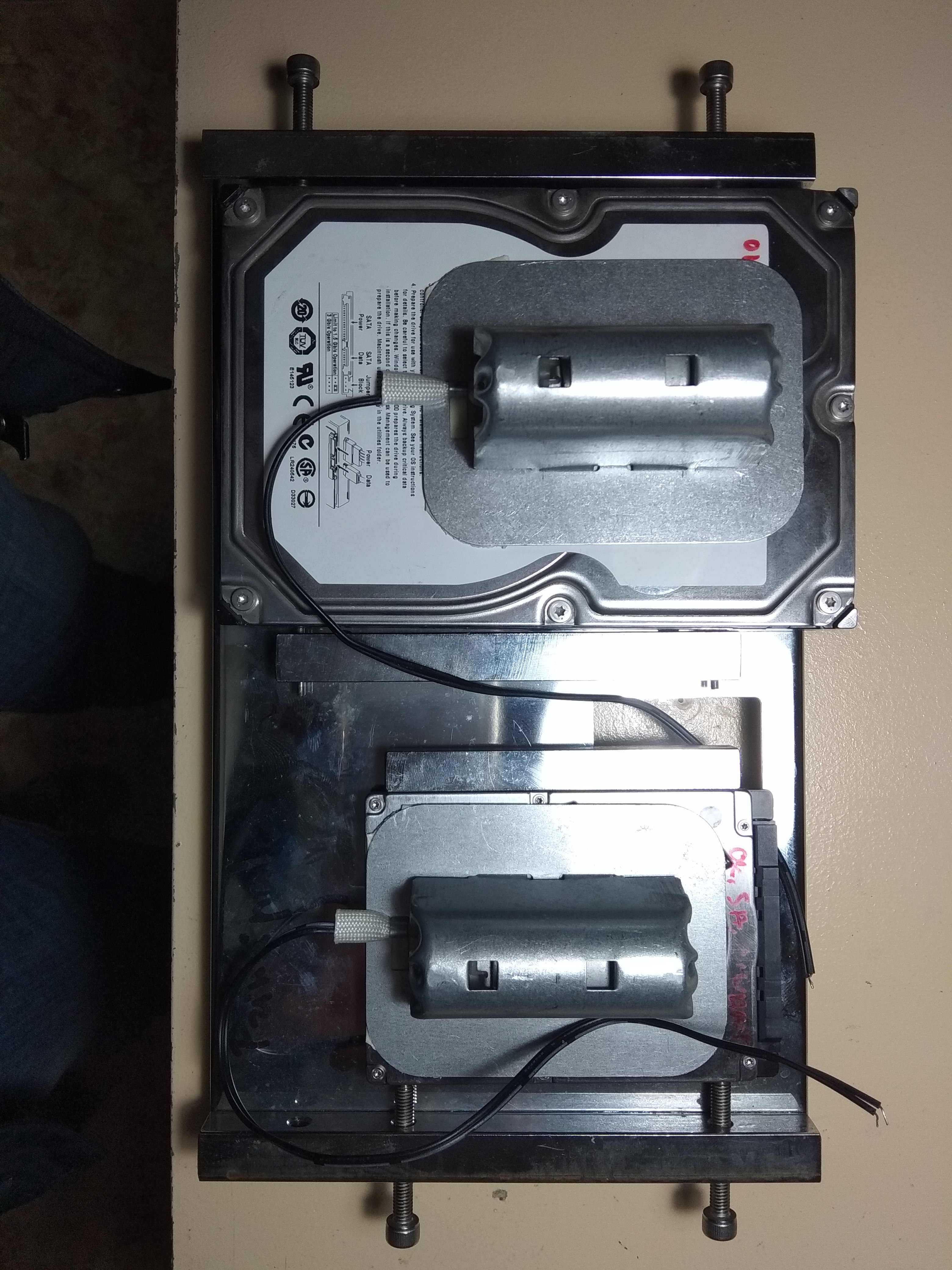

It seems that I am again faced with an HDD that may be that the bad sectors are read with vibrations (I'm not sure, at the moment I'm taking out the information).
I put a picture of the vibrators that I got to perform the test. They are stuck only by the front to the HDD.

@mph666, what were the vibrators removed from or from what were the constructed?

I bought them on Aliexpress.
https://es.aliexpress.com/item/DC-12-V- ... 63c07apijP
I hope to be able to do a test with the HDD that I am recovering, because it has all the looks to be a candidate.

I just tested the vibrations in a HDD WD10JMVW and they do not help me to finish reading the approximately 64k sectors that it reads with errors.
Any ideas to try to recover these sectors?
