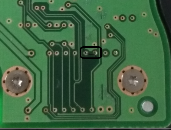

After starting the HDD you have to do an SA STRUCT TEST, and after giving an error in all the modules, you will write the modules and write them.
 Post subject: Re: SAFE MODE HITACHI???
PostPosted: January 13th, 2019, 16:15
Posts: 474
Location: spain
If I have it working. The only thing that takes a second more than leaving BSY.
PostPosted: January 13th, 2019, 18:36
Posts: 474
Location: spain
If after changing the values of the SA entries in the NVRAM, the SA test is performed and if the RSVDs give OK and the others all errors, the modules can be recorded.
PostPosted: January 13th, 2019, 19:20
Posts: 474
Location: spain
Yes, I have recovered the HDD.
I have to broach the access to the copies of SA modifying the NVRAM before doing the test.
I modify NVRAM.
I turn on the HDD and enter RDY.
I charge the LDR.
I do the SA test. (If it gives OK in the RSVD, it is a good signal).
I write the modules.
a greeting

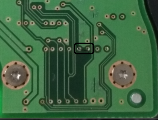

Once the NVRAM is changed you do not have to lift the PCB at all or the HDD will not read the copy F. If you want later in the evening, in our schedule we can make another TV, if it is not any inconvenience for you.
I find a problem after this and that is that the MRTLAB is not able to read the F copy after recovering the HDD, but if it is to rewrite and then read.

If you cut the reading channel at the start of the HDD, you will not be able to record the modules.
