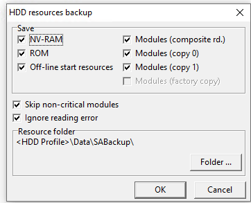

Loader creation is called "Off-line start resources" when you do HDD resources backup.

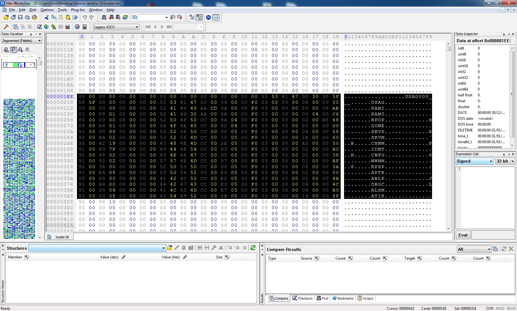

I'm studying the LDR file, you might try to build LDR manually for other hitachi arm drives too...
I attached instructions on how to build ldr manually, but i'm not sure if is correct, in particular i'm not sure about first 200 (hex) bytes

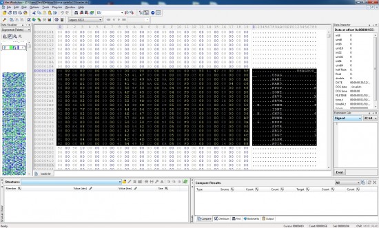

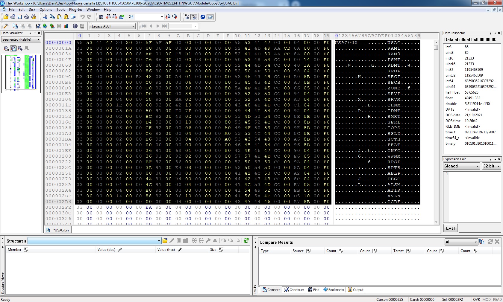

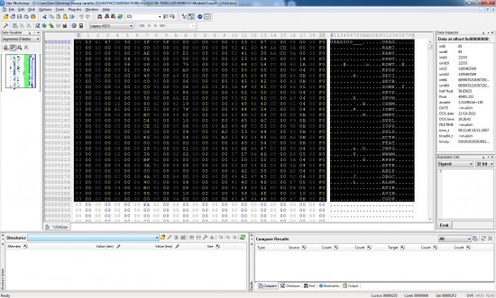

Yes, my USAGE ldr portion studing is wrong due to some bytes that in the ldr are different from USAGE module file!
It's tough for me to build USAGE portion correctly, i don't understand why pc3000 changes some bytes when creating the ldr, the only thing i understood is that inside ldr file created in pc3000 you can read since offset 200h which modules are included and in which order.
Inside USAGE module you can see all modules of service area

The differences between the USAG module in the loader and the corresponding USAG module in the SA are the result of adjusting the individual "offsets" of each component module when the preceding, unnecessary module (eg PSHT) is removed from the directory.

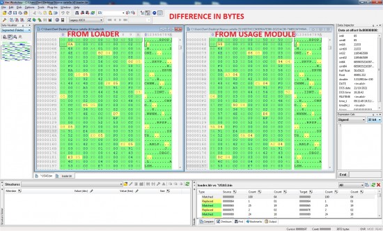

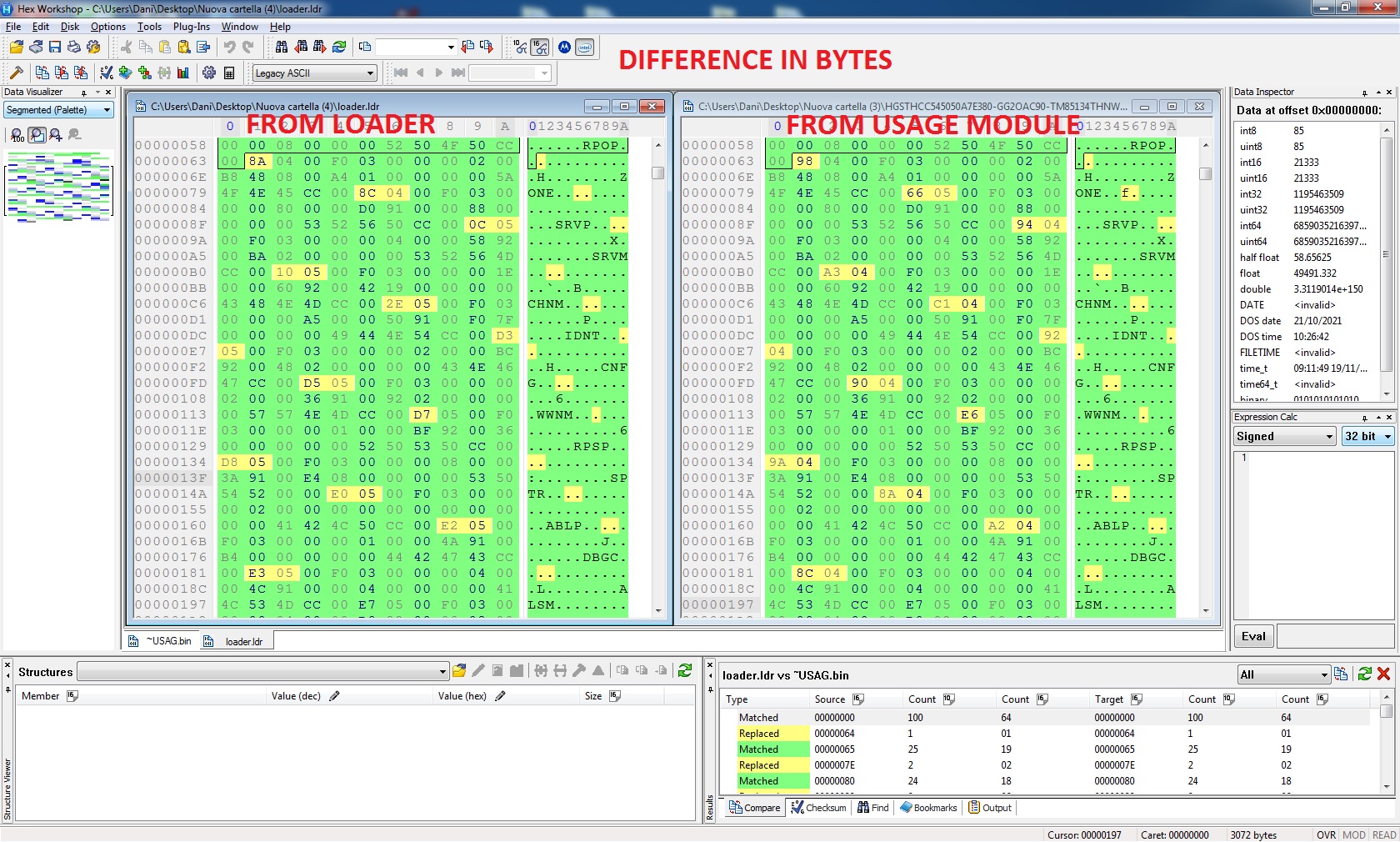

It's not only that, some byte are also different.

I show you which bytes are different, maybe you will find out how those bytes have to be modified.

I noticed that all '04' bytes in USAGE file are swapped into '05' bytes in LDR and all '05' swapped into '04'.

Those bytes constitute a little-endian word, eg 0x052E -> 0x04C1.

Thanks, i still don't understand what they mean this little-endian words and how to modify them correctly to build a proper ldr file.
I compared spildit USAGE file with my USAGE file (i posted in this thread from one of my hitachi fw resource), the are some little difference but all bytes are identical where ldr applys changes :)
Probably we don't need how to figure how pc3000 builds the loader, because probably difference between USAGE and LDR are always the same.
I would be able to confirm that, if drHDD can build a ldr from my fw resource and then i compare it with my USAGE.
AFAICT, the parameters which I have called "offsets" for each module in the USAG directory should be the PBA or sector number in the SA. This means that the locations of some of the modules in the loader's USAG directory do not match their actual locations in the SA. :?
 Post subject: Re: HITACHI-ARM FIRMWARE RECOVERY.
PostPosted: February 5th, 2019, 5:28
Posts: 17323
ISTM that when PC3K creates a loader, it grabs all the necessary modules and compacts them all into a contiguous "virtual" SA which resides in RAM. The layout of this RAM based SA bears no relationship to the physical SA on the platters. AISI, this creates a potentially dangerous situation whereby one could overwrite a physical SA module with the wrong virtual SA module.

   IDNT (partially, from 0h to 400h)
   BA000h to BA400h
ISTM that the tool which was used for the SA dump incorrectly determined the size of the IDNT module as 3 sectors rather than 2 (as specified in the USAG directory). In fact the third sector of the IDNT dump is actually the first sector of the SRVP module. :?
Offset(h) 00   02   04   06   08   0A   0C   0E   10   12   14   16   18
000000EA                                          5352 5650 CC00 9404 00F0   SRVP
                                                                 ^^^^ sector 0x494
00000104  0300 0000 0400 0058 9200 BA02 0000 0000
00000138                                          4944 4E54 CC00 9204 00F0   IDNT
                                                                 ^^^^ sector 0x492
00000152  0300 0000 0200 00BC 9200 4802 0000 0000
                    ^^^^ size = 2 sectors, not 3
