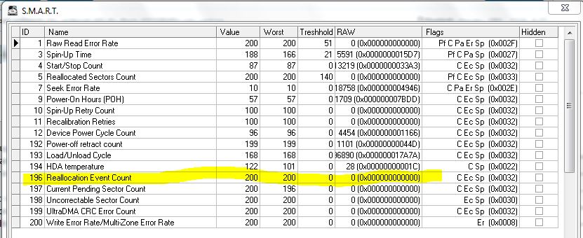

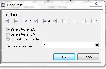

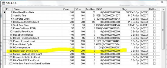

I am happy to report that with MD Marvel I have been able to clear module 32 (RE-LO) which has updated the SMART attributes. Also I ran a head test against SA and it indeed showed a bad head #3.
2/9/2019 4:43:28 PM: The drive WDC WD20EARX-00PASB0                     Disk size 3907029168 - 2000Gb
2/9/2019 4:44:45 PM: P-list read successfully
2/9/2019 4:45:31 PM: Write tracks on head 0 - Ok
2/9/2019 4:45:36 PM: Read tracks on head 0 - Ok
2/9/2019 4:45:58 PM: Write tracks on head 1 - Ok
2/9/2019 4:46:02 PM: Read tracks on head 1 - Ok
2/9/2019 4:46:24 PM: Write tracks on head 2 - Ok
2/9/2019 4:46:28 PM: Read tracks on head 2 - Ok
2/9/2019 4:47:51 PM: Write tracks on head 3 - errors: 9, success: 0
2/9/2019 4:47:56 PM: The drive WDC WD20EARX-00PASB0                     Disk size 3907029168 - 2000Gb
2/9/2019 4:48:02 PM: P-list read successfully
2/9/2019 4:48:38 PM: Write tracks on head 4 - Ok
2/9/2019 4:48:42 PM: Read tracks on head 4 - Ok
2/9/2019 4:49:03 PM: Write tracks on head 5 - Ok
2/9/2019 4:49:07 PM: Read tracks on head 5 - Ok

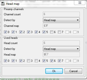

So now my plan is to turn off head #3 and image/clone the drive. I would like to get some advise on how this is best done.
I was planning on editing the head map in ID0A by removing the broken head. Then rebooting the machine into HDDSuperClone Live CD and running an image of the drive. If this plans sounds right, then I have some questions on editing the heads:
1. I'm guessing this head map is stored in module 0A in ROM. If so, I should back it up and back up the entire ROM before messing with it. Right?
2. The head test and edit head map screens have different numbering for the heads. head test goes 0 to 5. But the edit head map goes 0,1,2,5,6,7. Am I correct to assume that the head test #3 head equals the edit head map #5 head? If not, how do I know which head to disable?
3. Any special options I need to enter into HDDSuperClone since I have disabled a head?

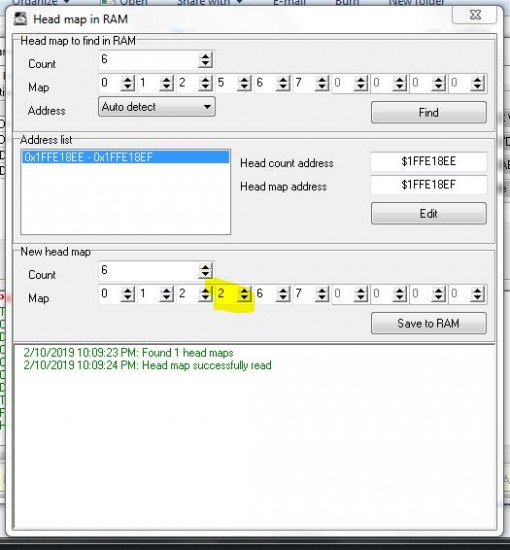

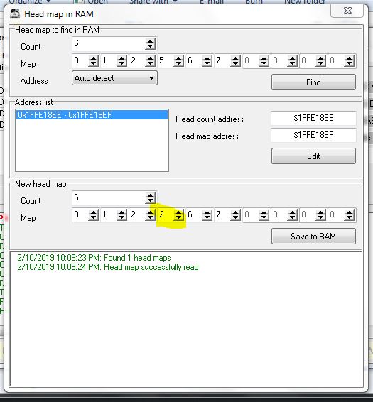

Thanks for your advice once again. I have some amazing news to report. I edited the heads in RAM as shown here.

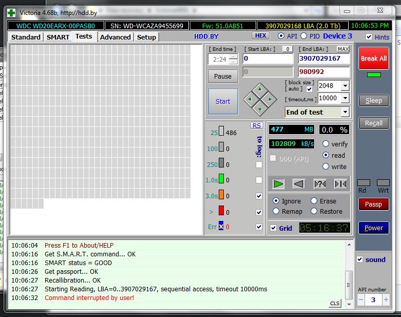

As you will see I didn't delete the head, but copied an existing head number over to the bad head slot. I then open Victoria and ran a scan and it successfully read LBA's until I stopped the scan.
