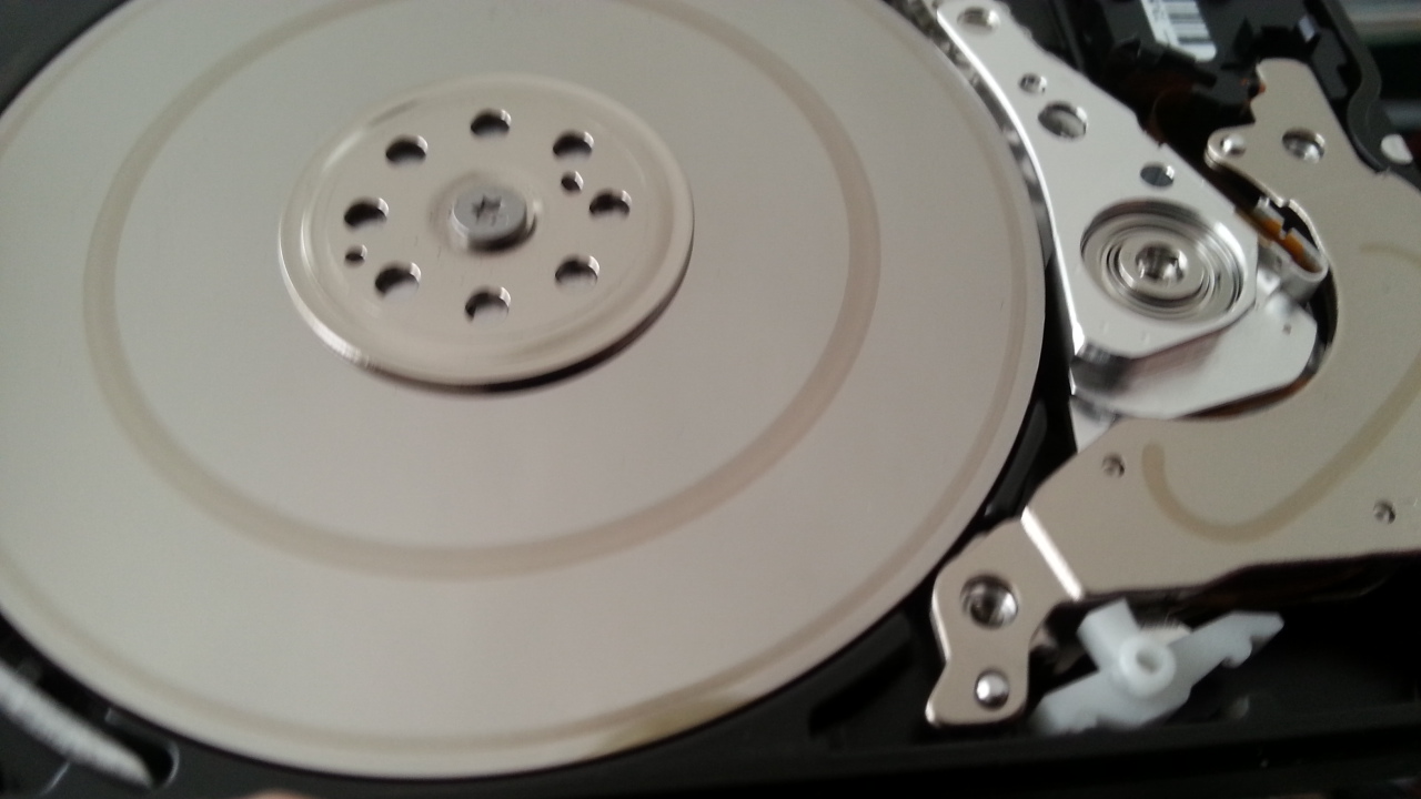

Dananjaya wrote:
i have never used MRT. but i think there will be a option call Service Area bypass ( SA bypass) If you have ROM backup then ok. bec. sa bypass option change the ROM.if bypass Ok and if heads are ok you can see the modules and you can correct them. after correcting you have to write original ROM.

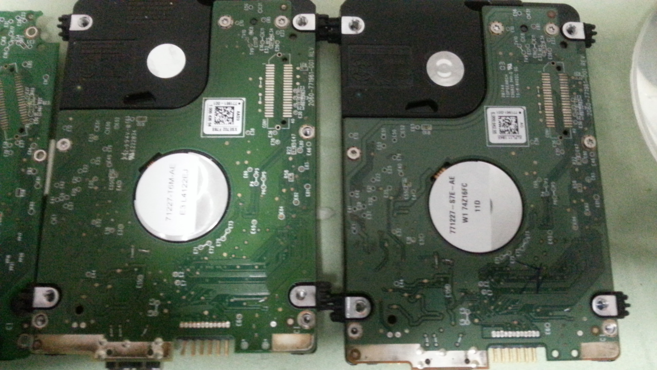

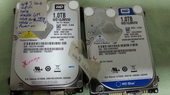

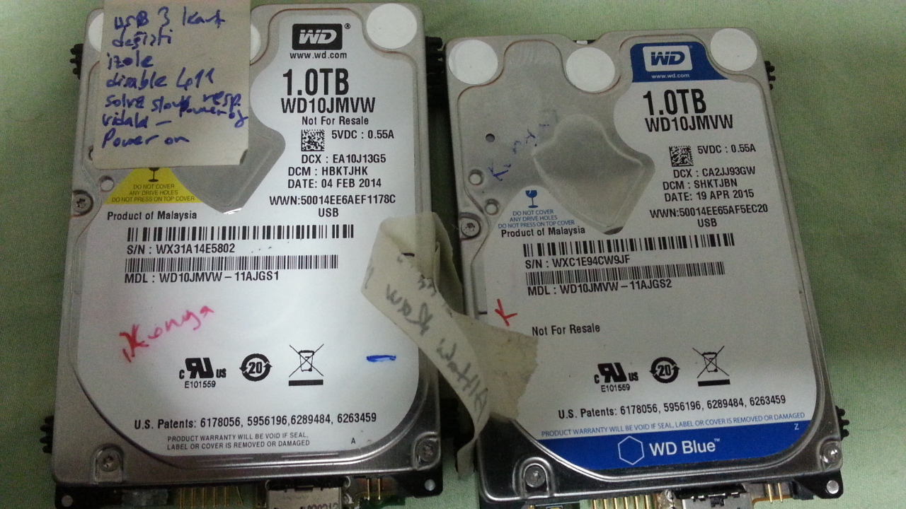

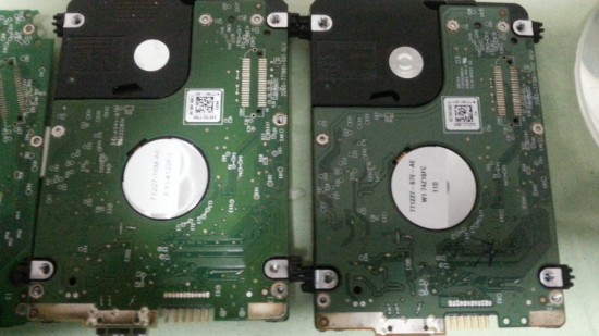

yes. i ask paitent and donor PCB. bec. i am not sure about donor head.
i think 0 _ 10% area of platter has a damage since dropped.
Both originally USB drive. Converted to sata before.
Left donor right patient (blue)

HddDonorMarket wrote:
I don't understand why all 4 heads gone . I am not sure about heads died.
Tried again with LDR and couldn't load mode 1. I load mode 1 from my backup. . Now shows modules list. But cannot read amy modules from disk. When try to open giving error.
Model WDC ROM MODEL Fblite
Serial wdc rom sw# xyz
Capacity 1 (0 fb)
Did you try head test of all 4 heads using cylinder -2 ? The audio file you uploaded sounded like failed heads and not heads that were seeking.
Capacity 1 (0 fb)
Yes I tried head test. Says all heads died.
I guess heads 0 or/and 1 gone. Or g list , p list , zone table corrupted.
I don't believe all 4 heads gone. But MRT says all gone. Anyway I ll try to swap head later.

OK try load LDR and Module list and then try to structure test "By Track"

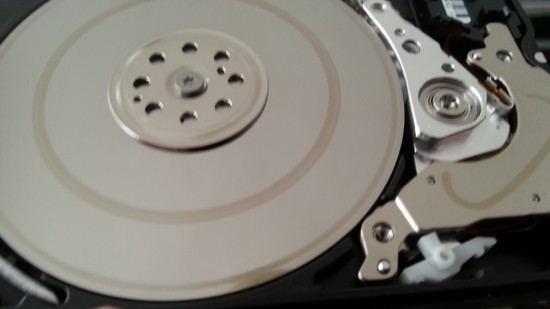

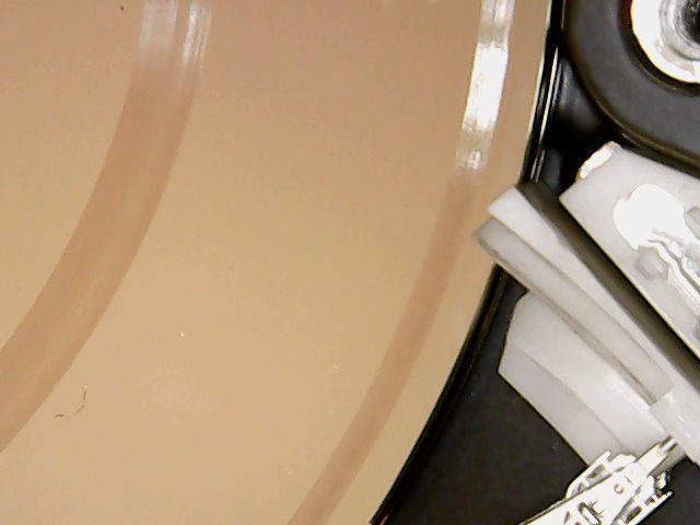

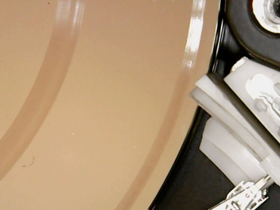

Customer lucky
I have cloned % 98 .
I don't know when happened this damage. Before clone whether when cloning.

Why did you not open the drive before? Seems like you wasted a lot of time
Learning )).
Watt do you mind about head? If I clean could be work for another case?
Learning )).
I can answer my question .lol. if that damage occurred. Heads gone.

 Post subject: Re: WD10JMVW 11AJGS2 stopped when clone
PostPosted: March 27th, 2019, 15:27
Customer lucky
This must have happening during cloning, no way would have gotten 98% clone as it stands now. The heads would have been killed instantly by that damage.
