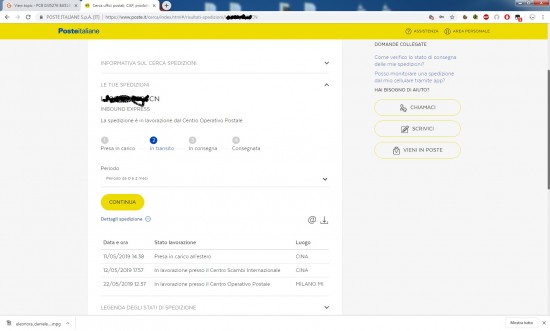

I will receive donor pcb soon.
At the moment it's located in Milan, i'll let you know if pcb + rom swap will work.
Thank you.

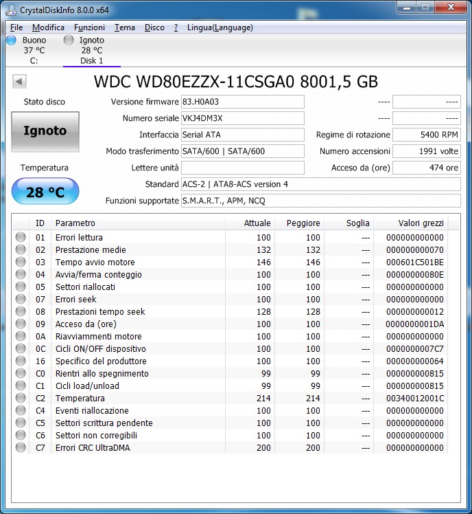

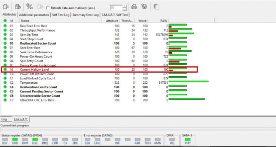

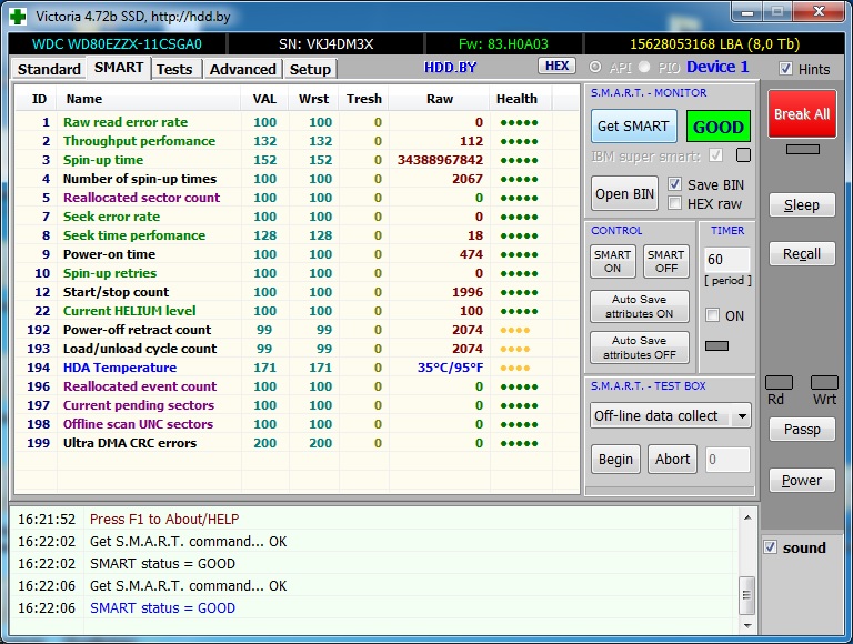

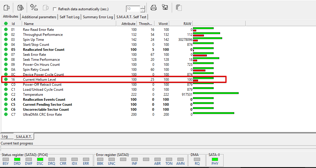

BTW, does PC3K correctly report the helium level (SMART attribute 22/0x16)?

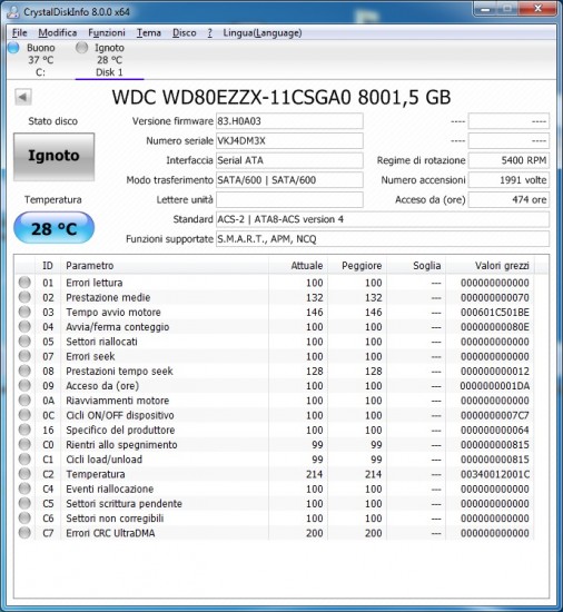

Thanks for the PC3K SMART screenshot. I prefer CrystalDiskInfo because it defaults to hexadecimal raw data. As they stand, some PC3K SMART attributes (eg temperature and spin-up time) are unintelligible until they are converted to hex.

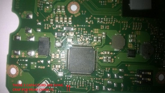

I received donor pcb and swapped the rom.
Now the hard drive spins but it does beep sounds, very likely heads are damaged but it could be something else as helium that is vanishing, some sort of faulty on donor pcb... maybe?
I don't know nothing for sure, this is my first helium drive and all we don't know much how this type of drives behavies.
I want to remind you all that original pcb seem to be fine at the begin (DRD + DSC flags were on and i could misure voltages on motor chip) but motor didn't spin, now with donor pcb it spins but heads are producing beep sounds (i think this could be another kind of pcb issue).
I was thinking to swap motor chip from donor to patient pcb... i don't know if is a good idea.

Is the motor controller hot to touch?
Do you think that the VCM is being driven? You can measure the voltage across the VCM current sense resistor (R22D).

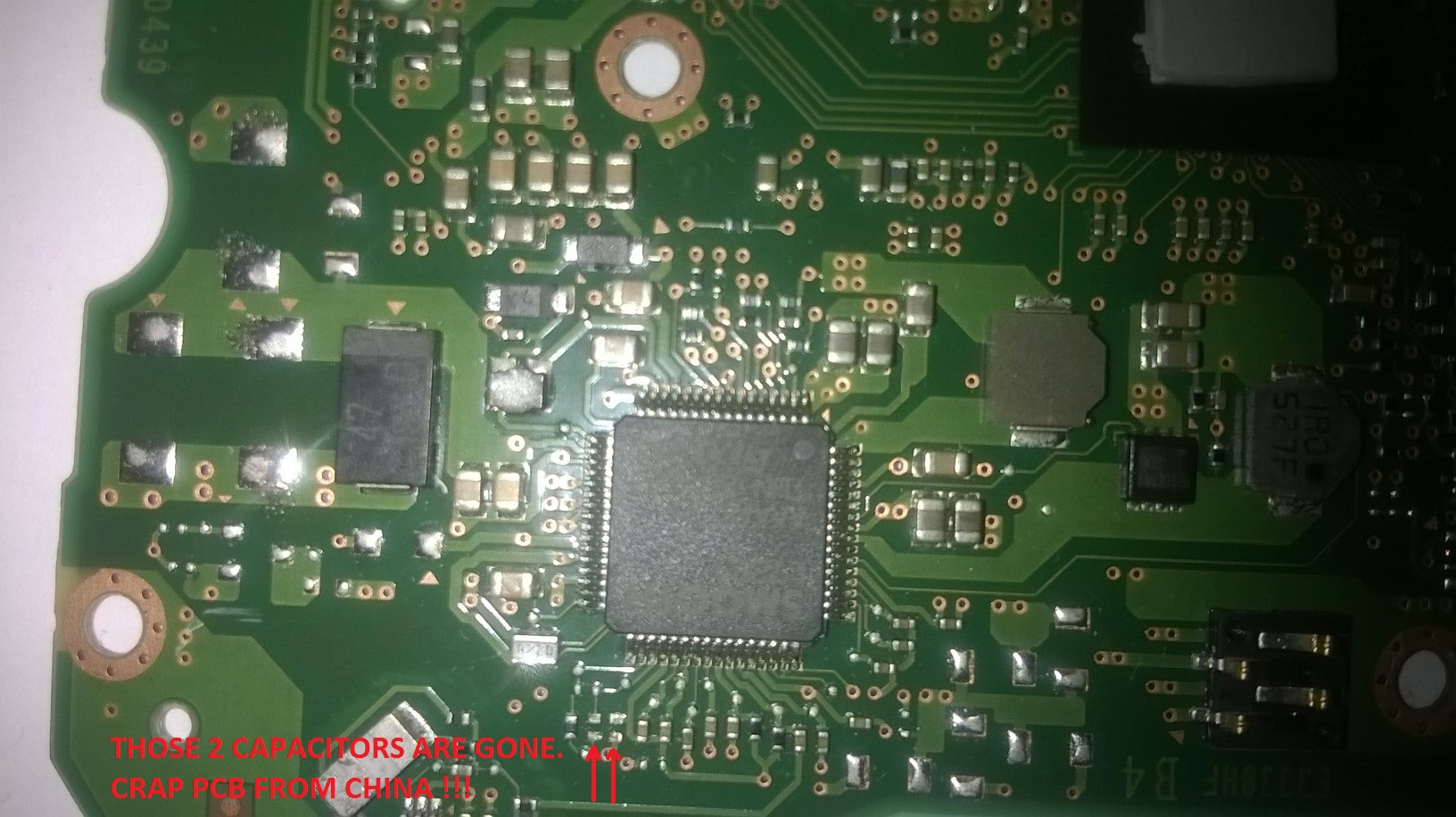

Wait a second!!!
I was going to measure voltages on R22D as fzabkar suggested, when i've seen two capacitors that were missing. :twisted:
This is what we get when we buy from untrested sellers on ebay, spildit warned me.
You were right spildit after all!
Now is very late here in italy, but tomorrow i will try to swap those 2 capacitors from patient pcb to donor and i'll let you know if something changes.

Ok, i've soldered those two capacitors below the motor chip and now seem that drive is spinning properly, listen to audio file

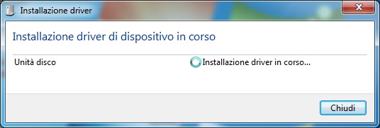

I've attached the hard drive to sata port of my 64bit Win7 OS, now it is identified in device management but only after "drivers installation" message, which takes about 1 minute since i power on hdd.
I don't know if is normal that it takes so long. :?
MRT doesn't support this drive, even for surface scan or simple smart checking.
HD Tune is too "stupid" to show the smart properly, crystaldisk is better but isn't able to show thesholds, Victoria is better because is able to show helium level which HD Tune and Crystal can't.
HD Tune smart.rar [2.24 MiB]
Downloaded 1660 times

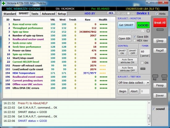

Standing on what Victoria smart is showing, the drive seem to be fine but i haven't found yet a tool which is able to show me sectors on UA.
MRT ---> failed
R-Studio ---> failed
WinHex ---> failed
Victoria ---> failed
I don't know yet if is normal behaving like that when this encrypted type of hdd are attached direcly to sata port, the drive came here with his WD enclosure attached to sata/usb controller which has ASM1151W mcu.
Probably after i'll remount the drive to his usb controller i will be able to access to data, but first i've to find out if controller and power supply are ok. I don't want donor pcb get killed.

The ATA command for reporting SMART thresholds was rendered obsolete many years ago, but HDD manufacturers have continued to support it. I wonder if PC3K and Victoria now retrieve the threshold data some other way. Perhaps the thresholds are included with the main attribute data.
Could you show us CrystalDiskInfo's hexadecimal text dumps of the SMART data? There should be an option to display a hex dump of the output of the SMART Read Data and SMART Read Thresholds commands.
BTW, I'm relieved that I didn't cause you grief with that dodgy replacement PCB. Nice job.

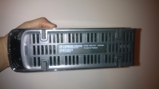

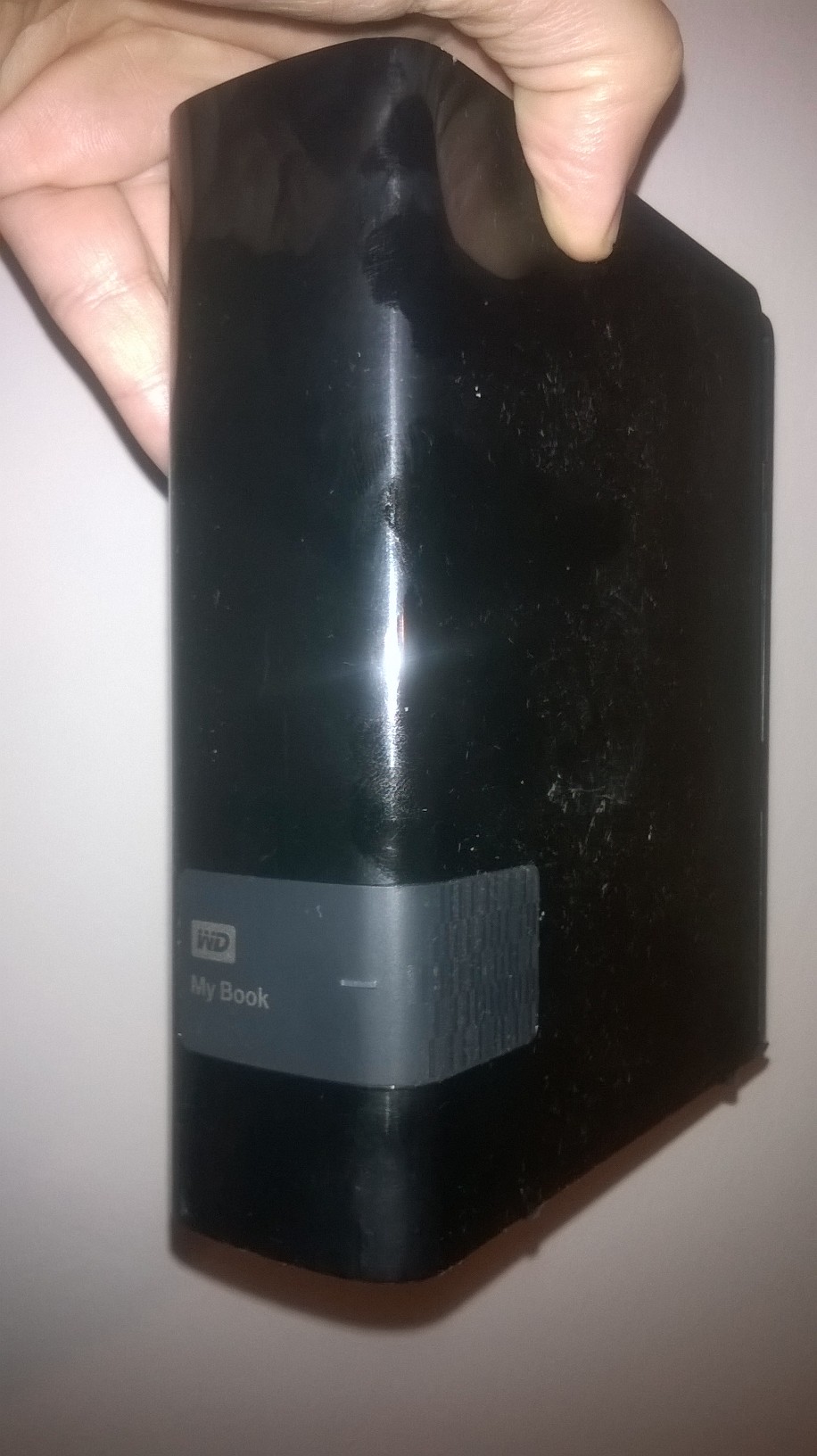

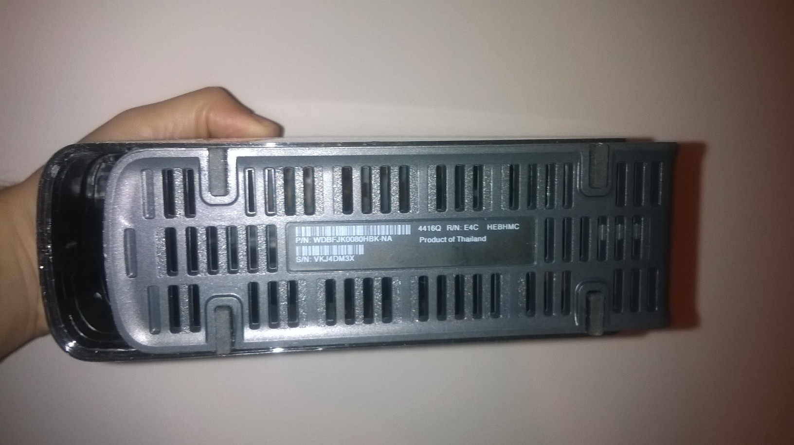

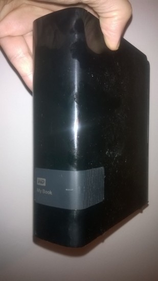

Michael, what model WD enclosure is it, please? Link from manufacturer with picture would be best.

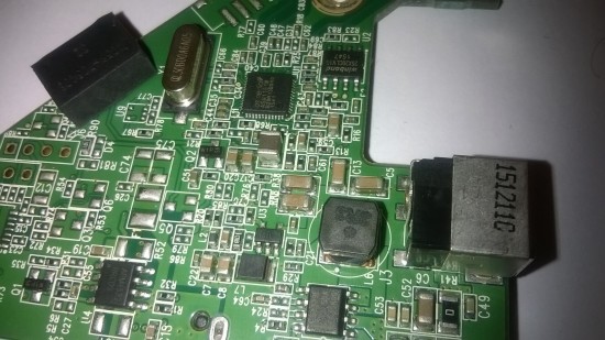

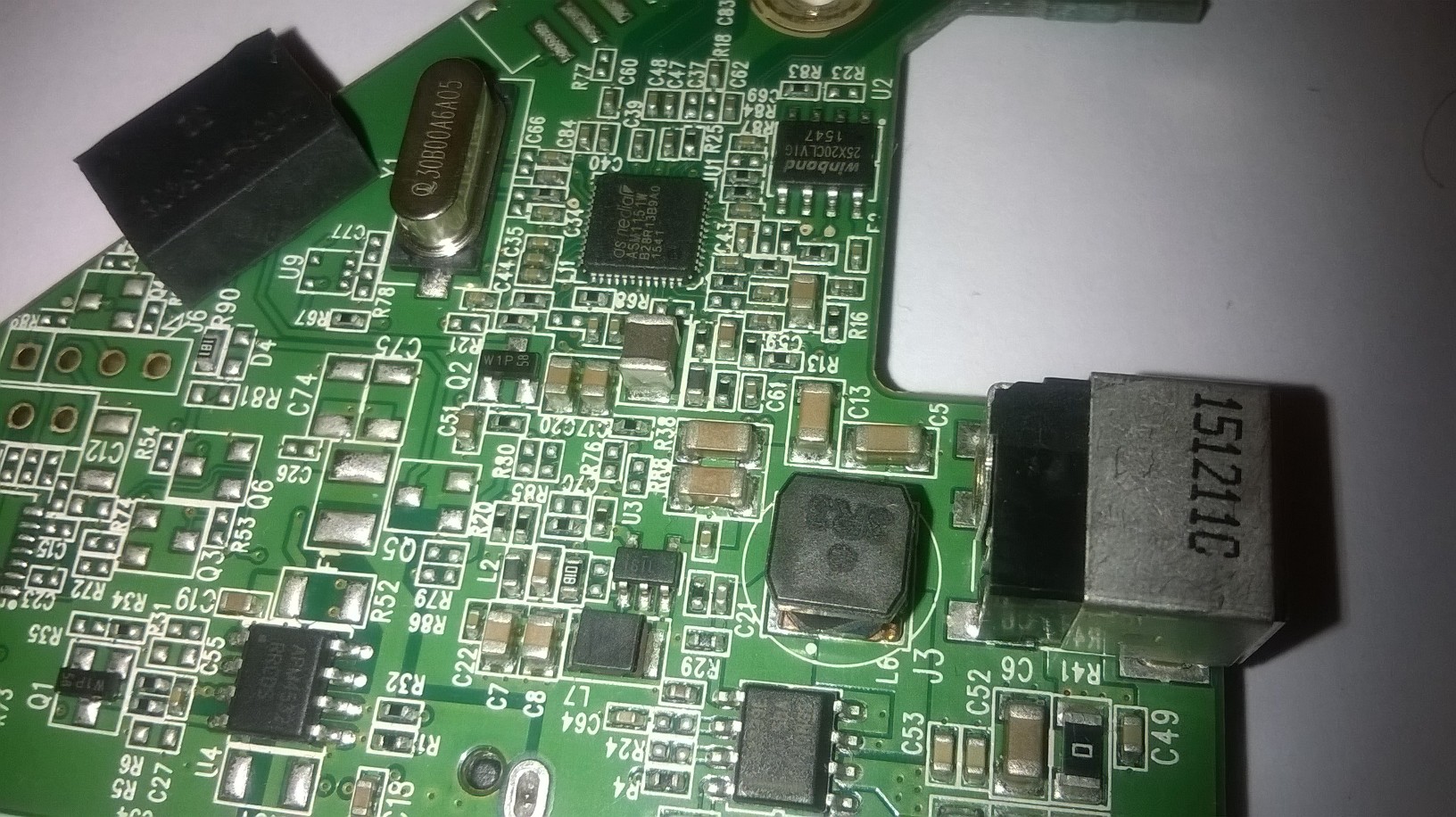

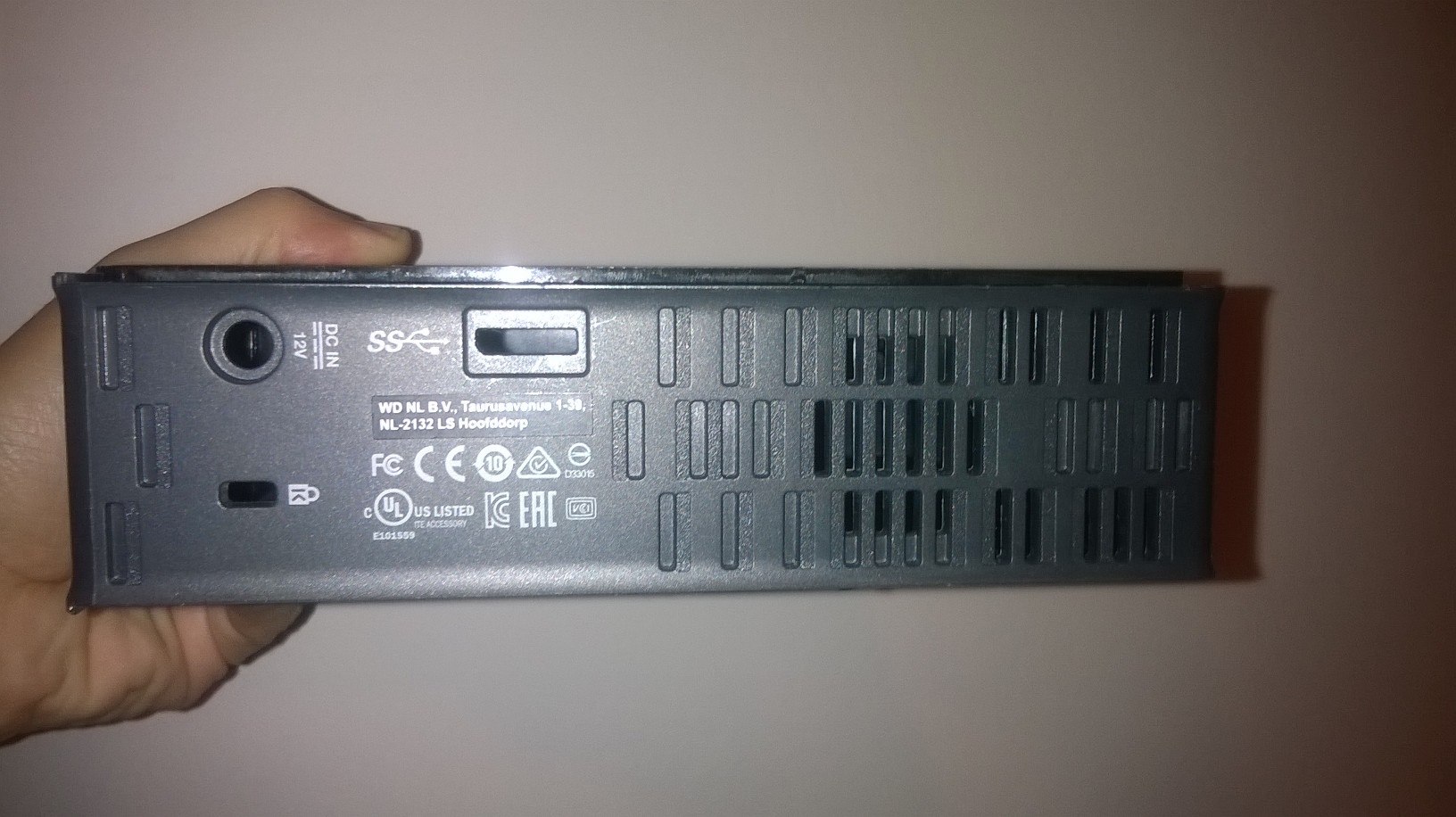

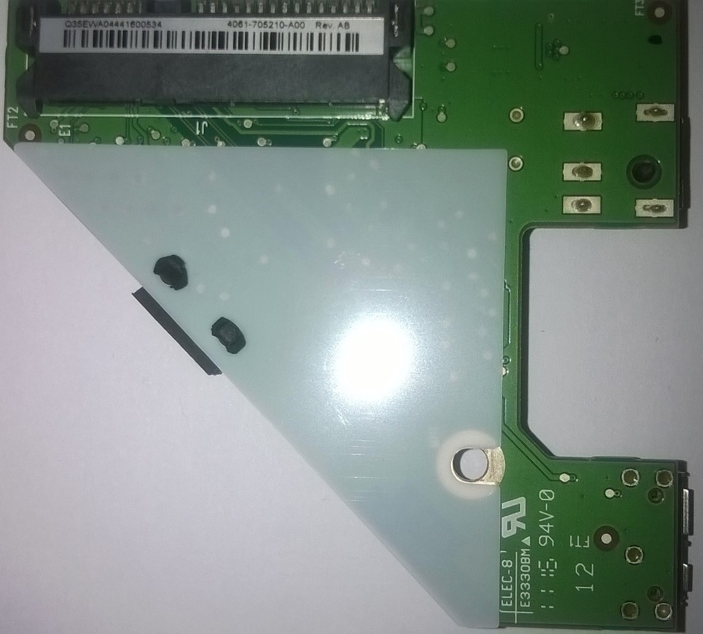

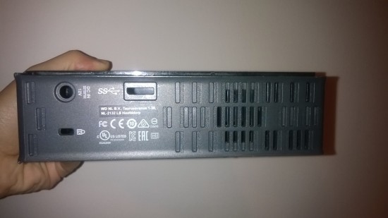

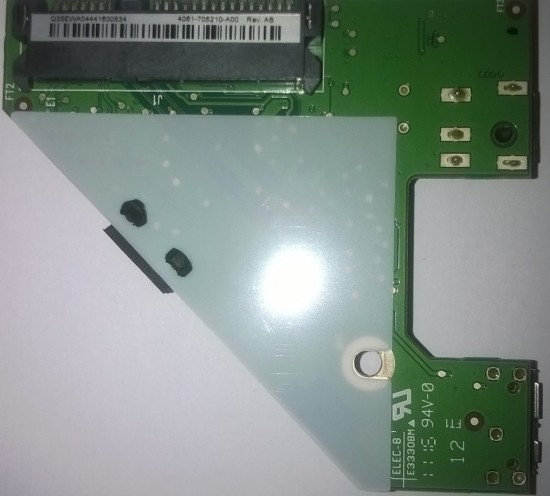

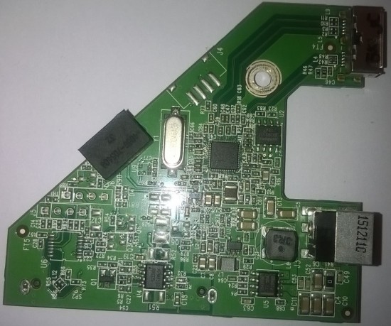

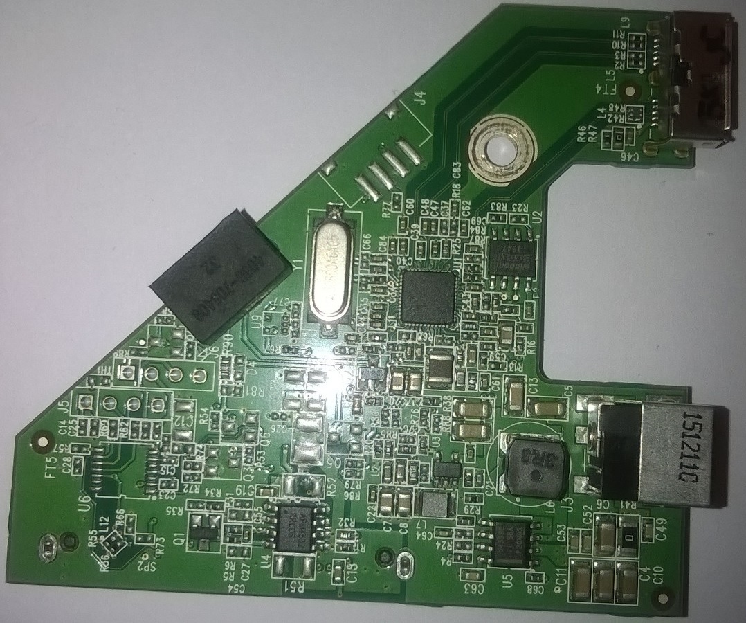

@labtech
i've attached picture of the enclosure and controller pcb.

 Post subject: Re: PCB 0J35276 BA5145B for WD80EZZX-11CSGA0
PostPosted: May 24th, 2019, 19:59
I would take any failed SATA HDD with good PCB and test inside the enclosure, preferably a WD drive. If nothing gets fried, then the enclosure is likely fine.
Then can test with the Helium drive inside the enclosure.

This is the kind of info that CrystalDiskInfo produces (from the Text Copy command):
https://pastebin.com/Q0RAS3MD
