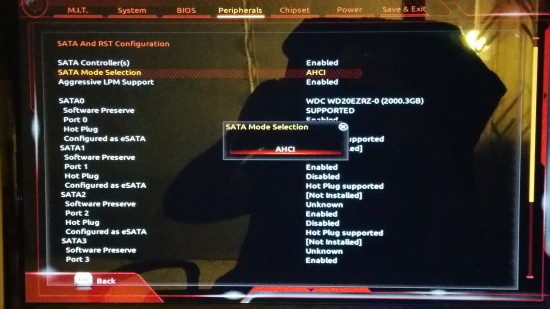

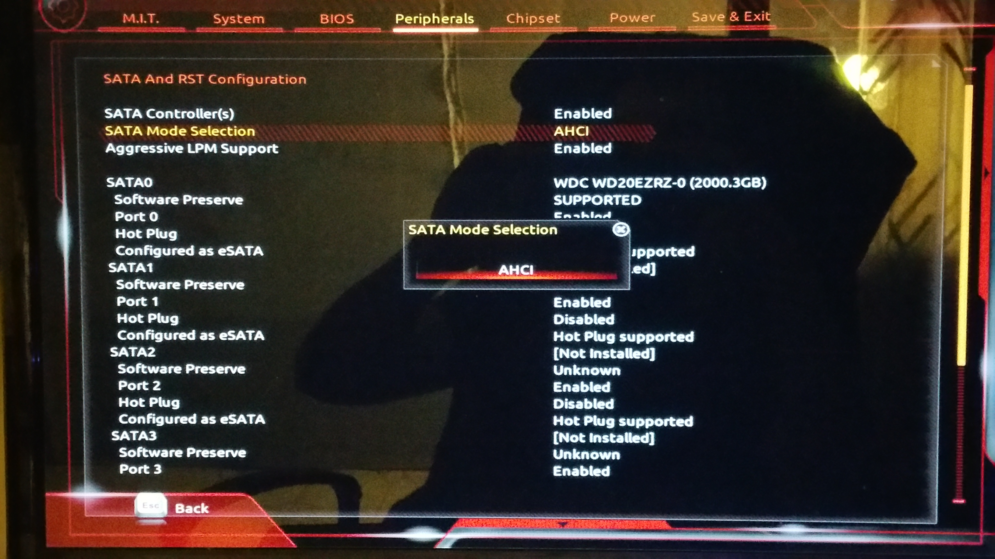

By the noise it does the drive seems to work regularly. No clicks at all and you can hear what I assume are the heads moving on startup (maybe positioning themselves on the platter?).
The motherboard is a gigabite b150m-d3h. I cannot find any mention of ide/compatibility on this particular motherboard online. This is the only section about SATA configuration I found

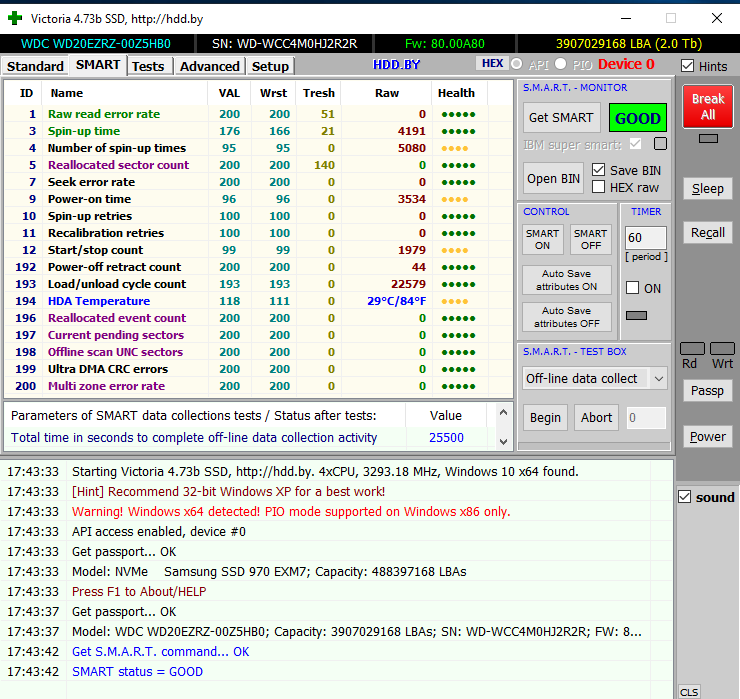

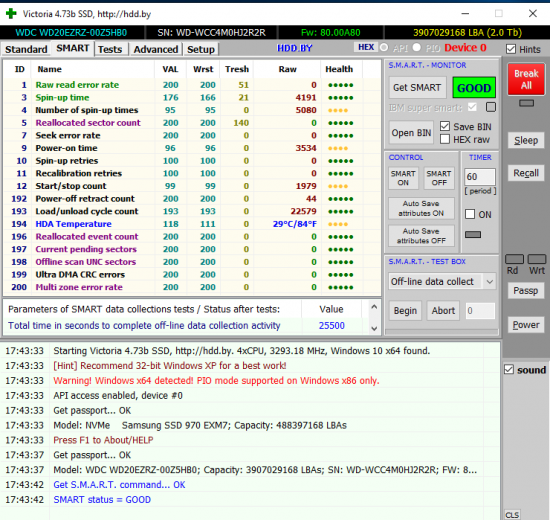

Take a look at how this WD drive smart is displayed in Victoria and compare it with yours.
Maybe try on a different computer?

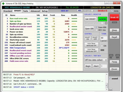

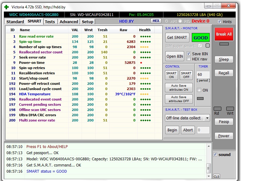

The previous analysis was referred to the faulty drive. Note all unknown parameters. I do not know why Victoria was labeling it as WD
This is the SMART analysis of the WD without the faulty Maxtor connected.
And if the listing order of those parameters is always the same I'm sure you guys can have a preliminary idea of how bad is the situation (I guess it is bad enough)

Yes you setup seems to be working perfectly.
So now you have to prepare and run terminal.
Take note your drive to diagnose is a 7200.11 and your test drive is a 7200.10 so they are different architecture. That will make practice and learning more difficult.
I would run terminal on the 7200.10 'test' drive to make sure your adapter is working. Then after you can move on to your 'broken' 7200.11 drive. Be very careful with the commands you send!

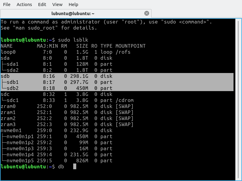

Hello everyone!! After a several days of duly “sector by sector” search I have finally understood now what a terminal log is :druunk: looking back at my last posts I feel a bit like Neo being uploaded with entire “domains” of new knowledge in a very short time-span. I must say I have really enjoyed the binge-reading and come to appreciate even more your hard work in this field.

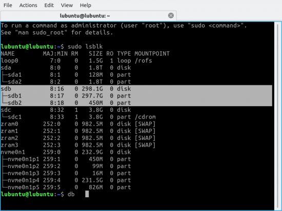

According to my last checkups: the drive appears in the BIOS, it does not appear in Windows 10, it shows up in Lubuntu as unknown or unmountable and it does appears on terminal if I type lsblk
My plan: first doing a very quick sortie with the TTL adapter (since a bought it) and see what do I get back in the terminal and post it here. Wait for your advice. Assuming there is still hope I will try next to image the drive using ddrescue or HDDSuperClone.
.... power the drive on with the terminal connected and POST the LOG that the drive output to TTL/terminal software at power up ... Goes without saying open the terminal first and power the drive later.
From your indication of the drive being sdb in the screenshot, the drive is listing partitions. That means it powered on and identified, and also successfully read sector 0. It could still have a firmware issue and/or a bad head. Try cloning/imaging with HDDSuperClone for about 5 minutes or so, stop it and attach the log here. I can tell many things from a log, usually even from a short run.
http://www.hddsuperclone.com
