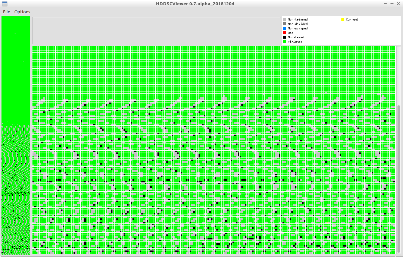

Here is a screenshot I took early on :
It shows a relatively wide area of contiguous bad or weak reads. Eventually most of those blocks became green so most of those sectors must have been recovered (although the grid aspect might not be accurate enough to ascertain this). Is it more likely that there is a damaged area at that particular spot on the corresponding platter, which fragilized the corresponding head – the one which eventually failed – each time it tried to “hammer” on those sectors, or an early sign of head malfunction ? Or both ?

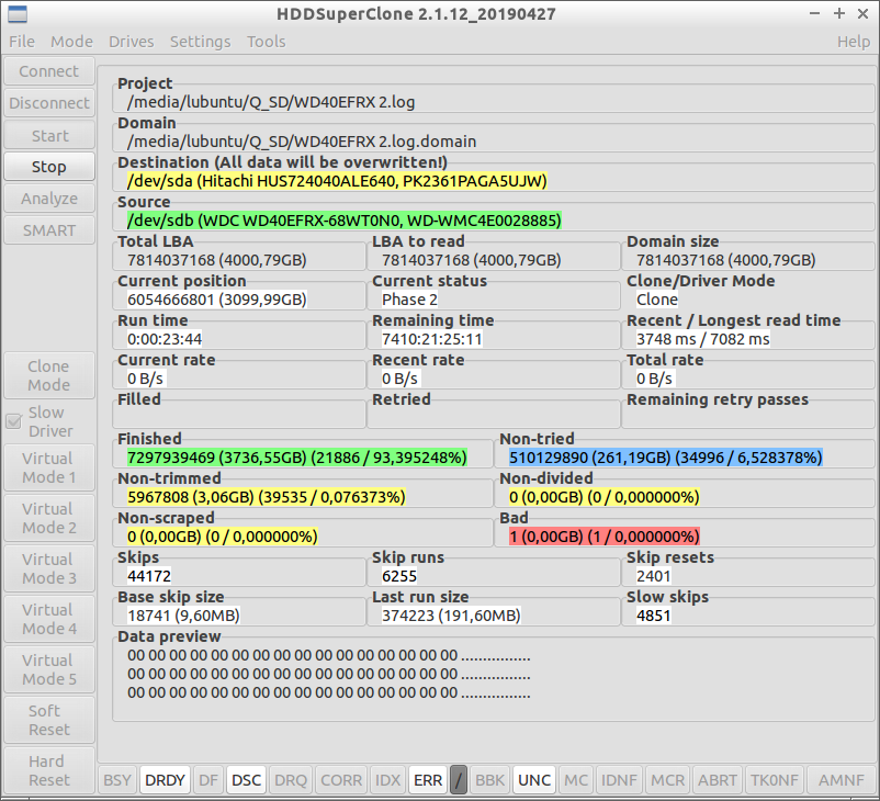

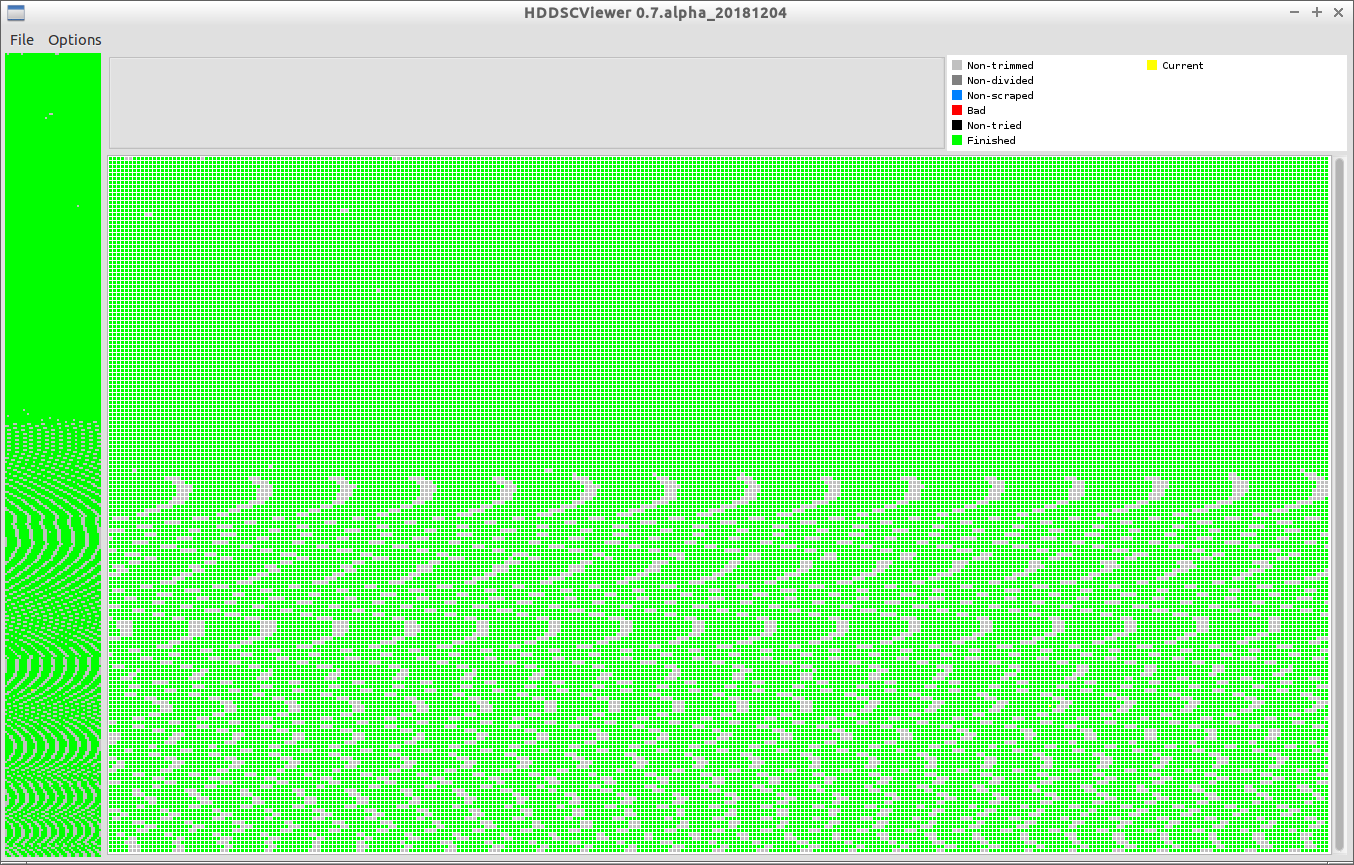

Incidentally, the owner told me that he used to shutdown his computer equipments, including the WD MyCloud device which contained that HDD, by turning off the power bar powering them all instead of doing a proper shutdown, and is himself hypothesising that it may have been the leading cause of that failure. The fact that this seemingly damaged area seems to be located at the edge of a platter would seem to be in favor of that scenario. Is that so ?
Interestingly, starting from ~79%, the defective head, which seemingly hadn't been able to read a single byte for a long while, seems to be reading again, albeit very slowly, between 10KB/s and 3MB/s, more like 100-500KB/s on average, and there are less skipped areas according to the preview in HDDSCViewer, even none in one particular spot where there should be grey blocks based on the general pattern. How is that even possible ?
2019-05-29-182607_1920x1080_scrot - cut + modif.png [ 152.63 KiB | Viewed 22259 times ]
Problem is, it's taking way too long to copy almost (?) only 00s, with reading times up to 7000ms, so I stopped and put a 1000ms threshold (instead of the default 300000 which seems way too high, since phase 1 is supposed to get the easily readable areas as fast as possible), now it's proceeding at a steady rate of 50-60MB/s with only brief slowdowns (and a few spikes above 100MB/s).

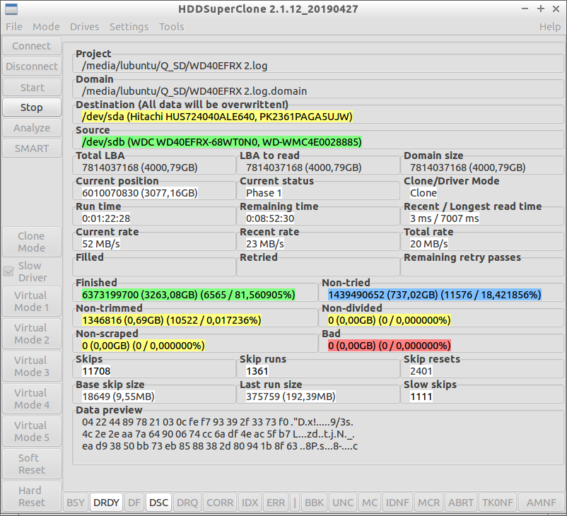

And I'm finally seeing non-zero data in the preview just beyond 3TB... :shock: (That's what Christopher Colombus must have felt like when he finally saw some land after months of navigation in an empty sea and in starvation.)

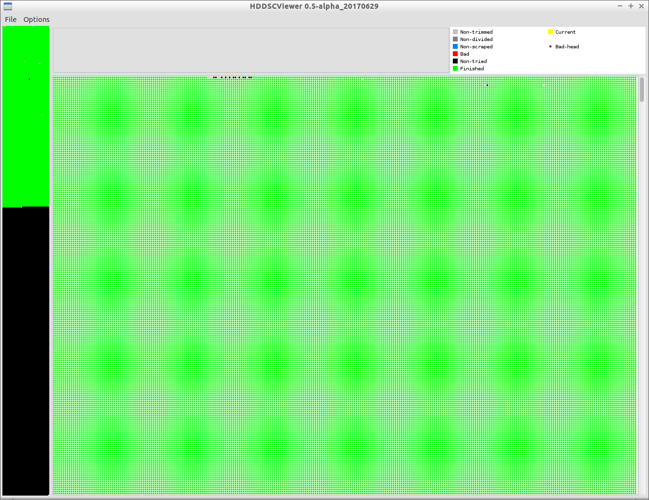

When I stopped it this morning to GTFTS, it looked like this :
It's a bit of a mess because the last 500GB or so had already been scanned (when I skipped a large chunk to verify if the “stripes” pattern would be the same everywhere), at some point I forced the copy to resart from about 47% where it was stopped the first time (and go back to phase 1 as it was then in phase 2), and once it caught up with that last portion there were only grey and black blocks left (the “current” yellow block is in the lower-right area of the grid). But it was still reading something once in a quite long while, with a low to very low speed as mentioned above. But I suppose that now the most efficient course of action would be to complete the clone in reverse from the very end, to at least get the most out of the black (non tried) blocks, instead of waiting for HDDSuperClone to reach that step on its own. Then there's probably little point in trying to hammer the drive further for days or weeks, blindly hoping to get some more useful bytes out of an overwhelming (and underwhelming) stream of emptiness.

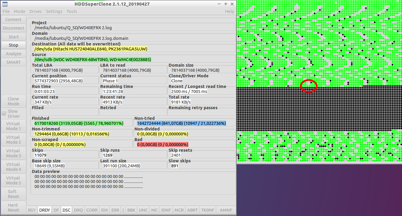

An update about the end of this recovery, and a few final questions.
1) I stopped the recovery when there were no more black blocks visible in HDSCViewer (a few sectors could still be copied but at an excruciatingly slow rate). Yet at that point, according to HDDSuperClone, there were still about 510000000 sectors or 260GB which were considered as “non-tried”. How come ? When a problematic area gets tried forward (pass 1) and backward (pass 2), shouldn't the sectors in between the skipping points be marked as “non-trimmed” ?
2) At that point the main partition could finally be mounted, but ddru_findbad still couldn't perform its analysis, as it couldn't detect the partition type or file system type. The command line tools it relies on, used independantly, reported the same result :

5) Based on the log file, what is the exact size of each head's “stroke”, and hence the expected size of each error in contiguous files ? Is it supposed to be perfectly constant, or can it vary sligthly ? As I mentioned earlier, the bad head seemed to be reading something in some areas, albeit very slowly (whereas in most areas corresponding to this head nothing could be read at all) : does this mean that the head itself was randomly getting (barely and briefly) functional again (then why ?), or that, for some reason, the magnetic signal was slightly stronger in those areas, enough to pass the “readability threshold” of the bad head, if that makes sense, and allow it to get a successful read instead of noise ? {*}
To further follow up on this, I now see also the previous screenshot that the read size per head stroke is about 191-192MB. But this does change, it will be bigger at the start and get smaller towards the end. This is due to density changes because the physical diameter is smaller as it reads farther in. As for why it can read some data and not other data, I don’t have the answer. That is how a weak head works sometimes. I looked at the log and there are large sections where it did read some and others where it didn’t read any data (play with the settings in hddscviewer, making sure to enable highlight good data). Sometimes density changes can affect the reading, but that is all I know.
To further follow up on this, I now see also the previous screenshot that the read size per head stroke is about 191-192MB. But this does change, it will be bigger at the start and get smaller towards the end. This is due to density changes because the physical diameter is smaller as it reads farther in. As for why it can read some data and not other data, I don’t have the answer. That is how a weak head works sometimes. I looked at the log and there are large sections where it did read some and others where it didn’t read any data (play with the options in hddscviewer, making sure to enable highlight good data). Sometimes density changes can affect the reading, but that is all I know.
It would seem about consistent with the maximum length of missing data I observed on the files which I examined thoroughly. And about in the ballpark of what are shown to be typical read size per head stroke in this thread (except for Samsung drives apparently) :
http://www.hddoracle.com/viewtopic.php?f=59&t=650

It is up to you to assess the condition of the drive as the recovery proceeds. I can’t make the program smart enough to think like a human. All I can do is provide a tool with a user manual. It is up to the user to read and understand the theory of operation section, and make decisions based on that and how the drive is reacting.
I get that, but you also said that an end user who does not have a deep understanding of how the program's algorithm is designed and the intricacies of data recovery on a failing storage device (i.e. the vast majority of end users) shouldn't try to mess with it or even attempt to make case-by-case decisions... :) The fact that HDDSC (at least the commercial version) can indicate if one head is failing is already a step in that direction. What I don't know (because I haven't tried – as I said it was already getting too long with too little reward without going that far in that particular case) is how it deals with a bad head situation beyond phases 1-2. Does it try to read every single sector (which might be a suitable approach when dealing with actual bad sectors on the platters), which must be extremely long when nothing is readable over a large area (because of that head malfunction), or it there a point where it gives up and marks the area as “tried” anyway ?
Excerpts from the user manual:
Phase 1 is a copy pass forward with skipping. Phase 2 is a copy pass backward with skipping. Together they offer the best attempt to get the most good data first and fast from the good areas of the drive…… These two passes are the money passes. If after these two passes you don’t have a percentage complete in the upper 90’s, then you likely have a weak/damaged head, and the next phases could take a long time to complete.
Skips is the total number of times the program has skipped since the program was started. Skip runs is how many skip runs have happened since the program was started. If you see the run count growing, it likely means there is a weak/damaged head.
So there is the indication of a bad head, no pro version needed.
As for how the further phases work:
Phase 3 is a copy pass forward with skipping. But the skipping size for this pass does not self adjust, and skipping is based on the read rate instead of read errors. If the read rate is below the value of –rate-skip for two consecutive reads, it skips ahead the amount of –skip-size.
Phase 4 is a copy pass forward without skipping. This gets all the remaining non-tried areas.
All failed blocks larger than one sector (LBA) in size are marked as non-trimmed by the first 4 phases. Failed blocks that are one sector in size may be marked as bad if timeouts are not used.
Trimming reads each non-trimmed one sector at a time forward until a read error, and then backward until a read error. Any trimmed blocks larger than one sector are marked as non-scraped.
Dividing is only performed if trimming is turned off. If trimming is turned off, then 1 or 2 dividing copy passes are done instead. The default is for only one dividing pass, to activate the second pass use the –do-divide2 option. If there is only one dividing pass, then it reads the non-trimmed blocks with the cluster size / 8, and marks the failed blocks as non-scraped. If the –do-divide2 option is used, then the first dividing pass reads non-trimmed blocks with the cluster size / 4. The second dividing pass reads non-divided blocks with the cluster size / 16. The first dividing pass marks failed blocks larger than one sector as non-divided, the second pass marks them as non-scraped. Trimming has been found to be more efficient than dividing with scsi-passthrough mode. Dividing can be more efficient with ata-passthrough mode (not in the free version as the marking of reported bad sectors is disabled) and the direct modes (more so with direct mode when using timers), but how efficient depends on how the drive is reacting.
Scraping reads the non-scraped blocks one sectors one at a time forwards. Failed sectors are marked as bad.
If you really want to try to understand how it works, then test with it on some drives that are not important, NOT with drives that you are currently trying to recover for a client.
