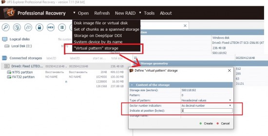

One could test this hypothesis by writing a predefined signature to each LBA of a working drive (eg signature = "LBA x"). Clearing module 148h would then merge the cached regions into the visible user area. We would now scan the LBAs until we find a discontinuity, eg <LBA 10000> <cached data> <LBA10001>.

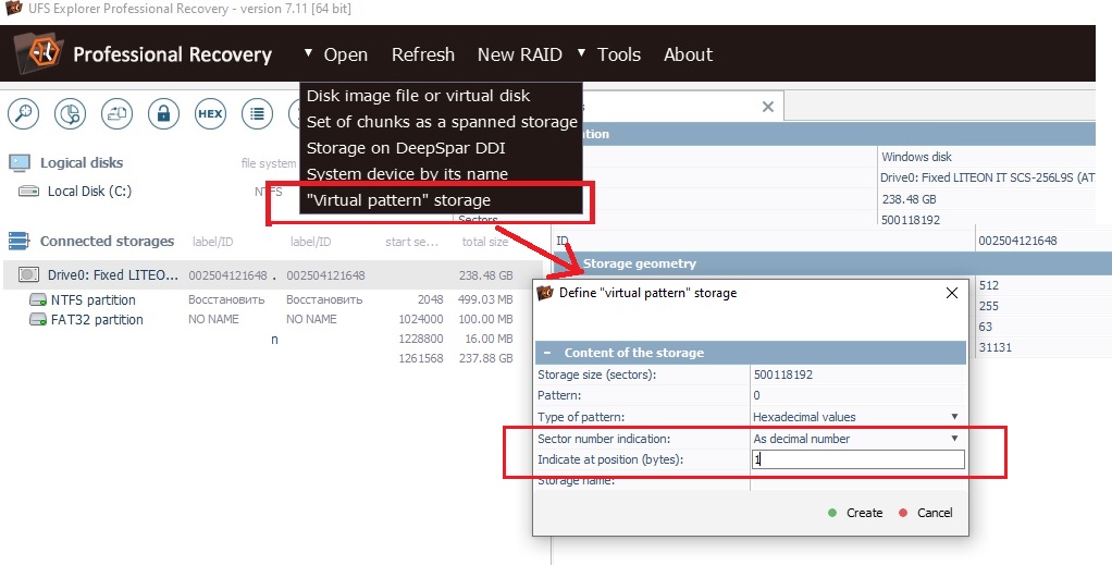

I was thinking the same thing, although I would expect that the tail end of the user area would now be inaccessible.
And just a hint how to make it easy with UFSExplorer_Pro ;)
