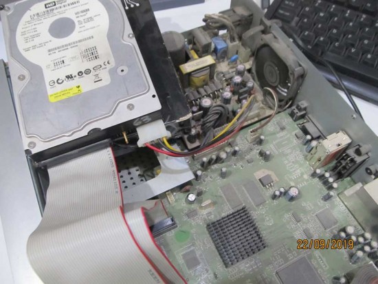

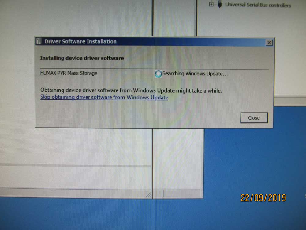

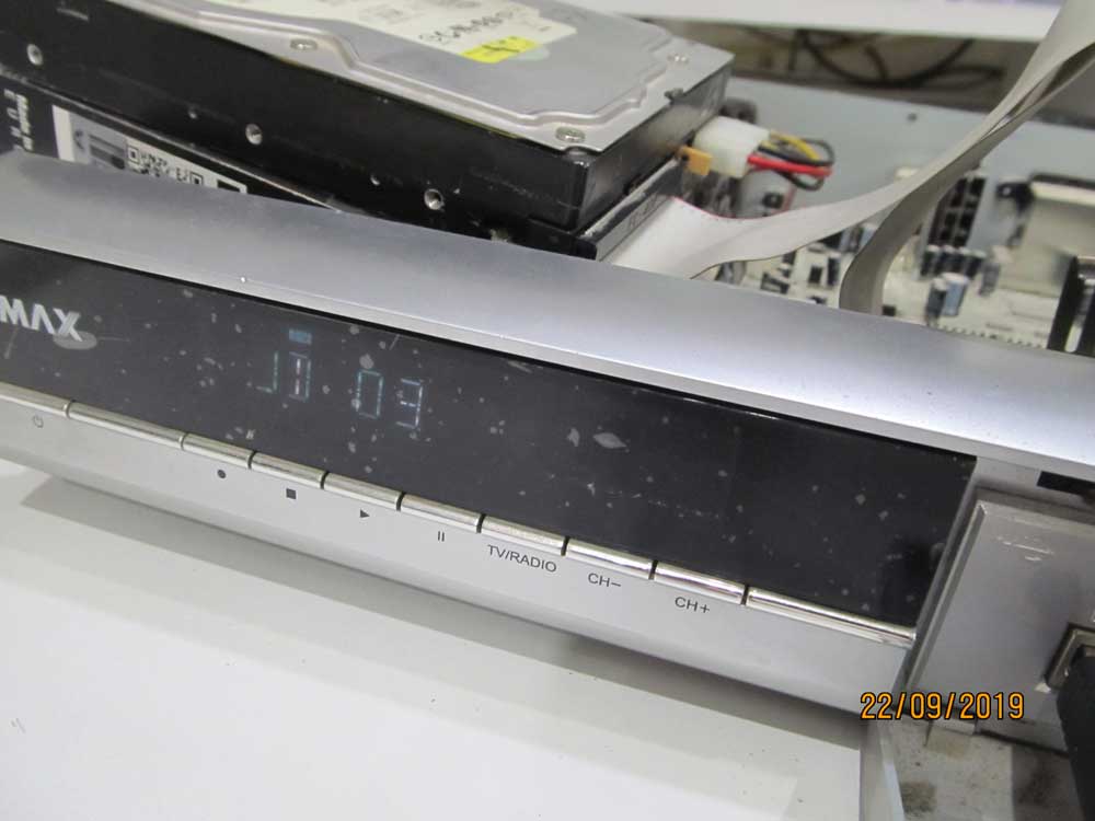

It seems you are not the only one who fixes things
case closed..

My first thought was to congratulate you, but all I see is some irrelevant cycling video and the installation of a Humax PVR mass storage driver. I see no evidence that you actually recovered anything. My reading of the manual would suggest that there is no way to retrieve the PVR's content via this route. Is the manual wrong, or did I miss something?
As I saw it, there were two possibilities, both of which had obvious solutions:
1/ If the owner's Humax DVR was electronically faulty, then you would transfer the patient HDD into a donor PVR. That's something the owner could do. No need for a data recovery.
2/ If the OS volume was indeed corrupt, then you would clone the OS volume from a donor PVR, or you could try to reinitialise the OS volume via a firmware update, assuming the box had sufficient sanity to allow this.
In any case I would have extracted at least one file from both volumes, if only to learn more about this DVR, and to prepare for similar jobs in the future.
