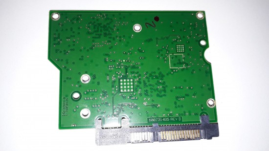

@lastmile, thanks for indulging my curiosity. I wonder if we could try another test. Could you show us the underside of the PCB?
I wish to explore the "Bridge PLL Enable Failed" message. IIUC, the "bridge" is the Seagate ASIC which controls the NAND flash. If so, then the PLL (phase locked loop) would be involved in synchronising the clocks for the communication channel between the MCU and the ASIC. This would in turn suggest that the ASIC has been disabled, which would then imply that it is powered from the same 3.3V supply as the NAND. If so, then I would try to disable the NAND in some other way that doesn't affect the ASIC.
Your tests prove that the MCU is switching off the Vcore2 and Vneg supplies. Thanks for clearing that up.
The other interesting thing is the "Clump Parametrics" and "SOC PSM Command History". Your tests confirm that the NAND is not the storage location for these data. Instead I suspect that the SPI flash ("ROM") keeps a record of this info.

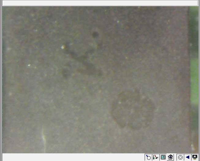

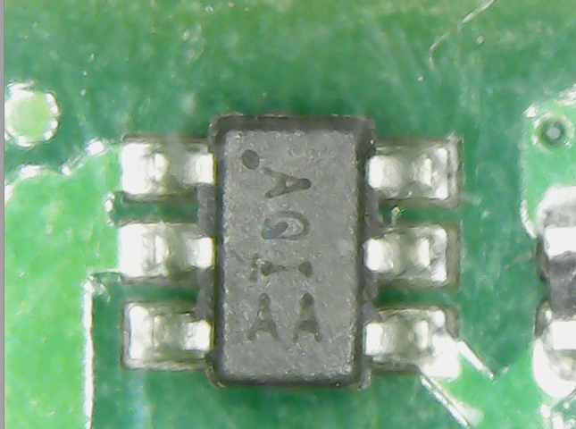

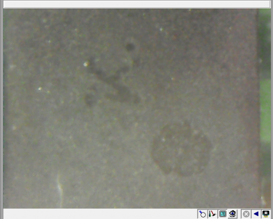

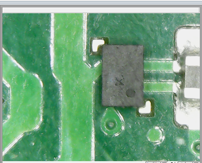

@lastmile, there is a 6-pin IC near pin #1 of the ASIC. Can you tell us its markings? Can you measure the voltages on the heavy traces?
There is another tiny IC at the left side of the ASIC? Can you identify its markings?

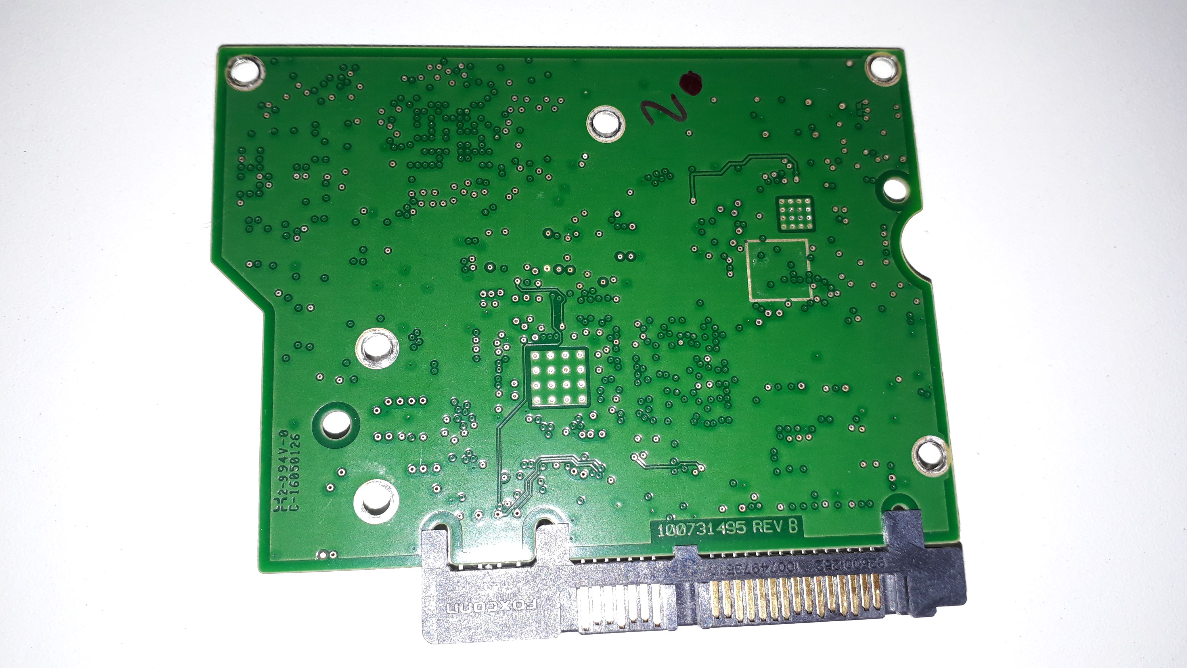

@fzabkar, Of course, picture attached. I hope you find some other whay to disable NAND and give back life to HD.... :lol: :lol:
File comment: PCB Board SSHD - Seagate ST1000DX001

The underside of the PCB is unhelpful. :-(

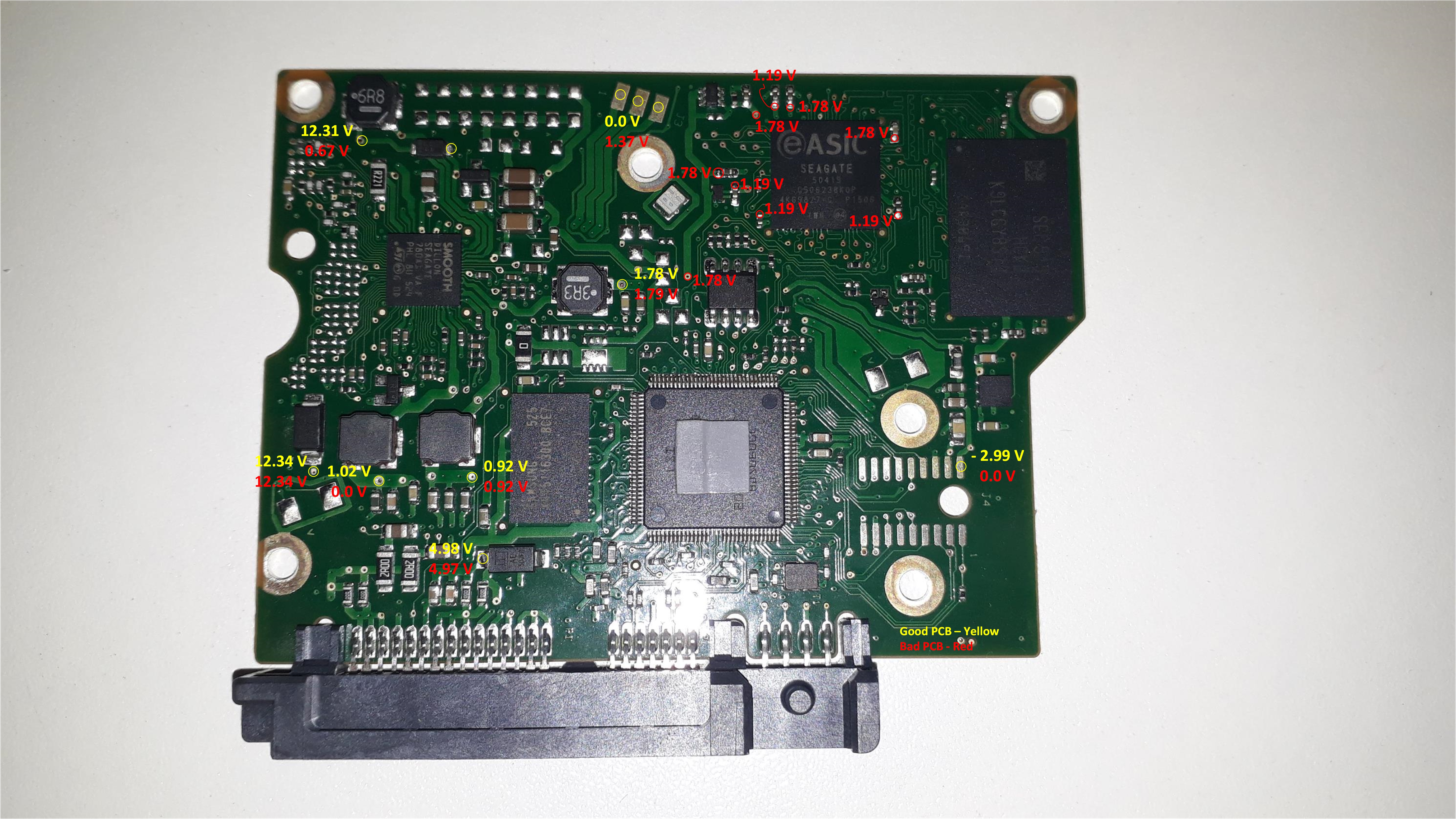

Can you measure the voltages on the bypass capacitors surrounding the ASIC (I can see 7)? This should tell us the supply requirements.
What I'm hoping to do is to find some way to defeat the NAND during the POST and leave us with access to terminal. It may not be possible, but we won't know if we don't try.
@fzabkar, Images attached.
Many thanks.
File comment: PCB SSHD - voltages on bypass capacitors near ASIC
 Post subject: Re: Seagate SSHD 1 TB ST1000DX001 (FW: CC41) don´t spin.
PostPosted: October 3rd, 2019, 19:20
Posts: 17314
It appears that the NAND is the sole user of the 3.3V supply.
The ASIC's Vio rail appears to be powered from the MCU's 1.8V Vio supply via a load switch (AQI marking, SOT23-6 package). I haven't yet been able to locate the datasheet for this IC, but I'm fairly confident that it is actually a load switch, in which case its enable pin would be controlled by the MCU. I believe that the two unpopulated pads between pins 3 and 4 are reserved for a shorting link which would be used when the load switch is unpopulated. In the unlikely event that the load switch is damaged, one could bypass it with such a link.
The 4-pin BGA IC appears to be a 1.2V LDO regulator which derives the ASIC's 1.2V Vcore supply from the main 1.8V rail. I haven't yet found a datasheet, but I suspect that this IC is similar to the NCP110 (similar specs, different pinout):
https://www.verical.com/datasheet/on-semiconductor-linear-regulator-ncp110amx180tbg-5698767.pdf
I'm betting that the round pad (pin #4) is an enable pin, also controlled by the MCU. I would be tempted to short this pin to ground during power-on. Try the bad PCB first. I would first confirm that the Enable pin is not hardwired to the 1.8V rail (extremely unlikely).
