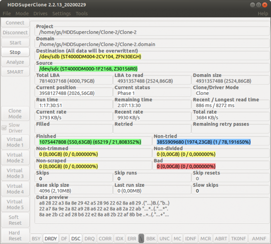

Hi guys,
now please don't make fun of Nothwind for being good-hearted. It's really great that there are such people out there. :)

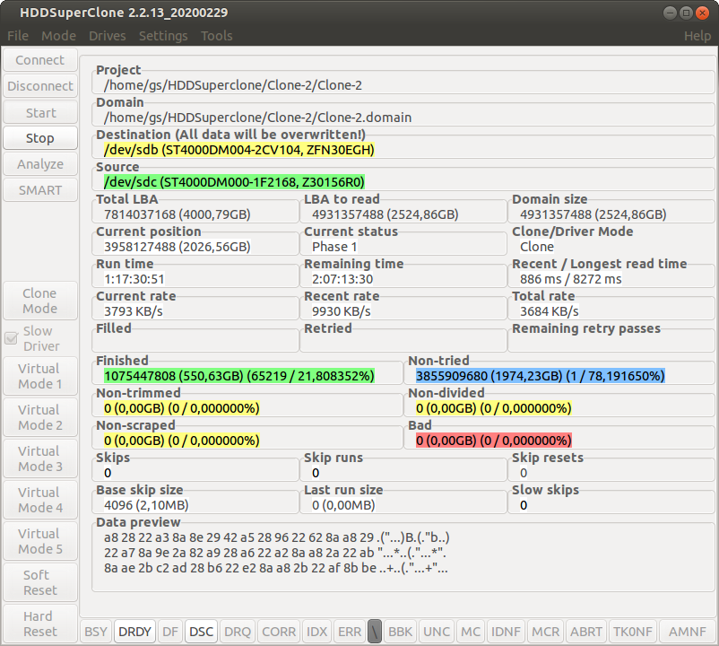

My HD-recovery has picked up speed overnight and if it stays like that, it will complete at a "semi-professional" speed:
Now it's 550 GB, with no skips or retries and it estimates two days for completion. Fingers crossed that it stays like that. So it's about time to look at the undelete-programs which Northwind recommended. The clone will be kind of precious and easy-to-ruin too. Any tipps on how and how not to do the terabytes of undeleting? :?:

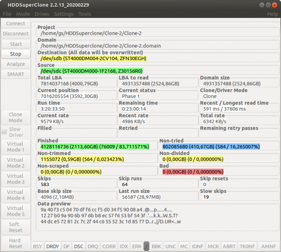

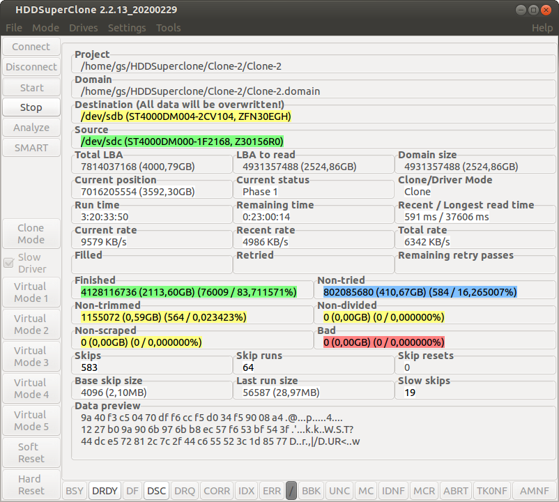

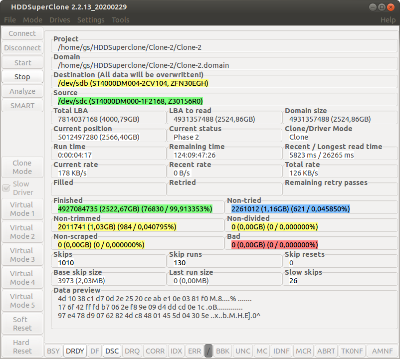

this is just an update on how it's going. HDDSuperclone is still in Phase one, but it's now 83% done. With a total rate of 6,3 MB/s, it is relatively close to the 7,8 MB/s which I saw when I tested HDDSuperclone by cloning part of a healthy drive. This is more than 3 times faster than what I got with HDD Raw Copy.
Yesterday it started to skip some sectors for the first time and overnight, the number of skips increased from 16 to 581. In the last 12 hours, it made only 2 more skips. So there is some bad zone, but most of the data is in a relatively good condition. It now pays off that HDDSuperclone does not try forever to read the bad data and instead picks all the low-hanging fruit first.
In the end, I guess, it will try to squeeze out as much valid data as possible from the bad sectors, until I tell it to stop at some point. And according to Murphy's law, the remaining unreadable sectors will be in heavily used, worn-out areas, - such as MFT, volume bitmap... we'll see. :wink:

Mayday! The laptop on which this runs has become unresponsive overnight. :shock:
The Ubuntu screensaver which turns the screen off does not turn it back on when I touch the touchpad. So I can not see any messages. There is no more flickering drive lamps.
I could switch it off and back on, but what happens to HDDSuperclone's logfiles in that case?
So far, I did nothing. Please advise what to do next. :?:

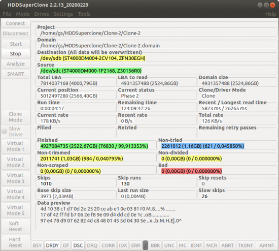

 Post subject: Re: Trying Data-Recovery from Seagate ST4000
PostPosted: March 13th, 2020, 4:24
Posts: 402
Location: Moscow
George-S,
Turn off and watch.
The disk must have died.
It’s a bad idea to copy a disk with problems without techno-utilities.
PostPosted: March 13th, 2020, 14:52
Joined: March 6th, 2020, 14:18
Posts: 22
Location: Germany

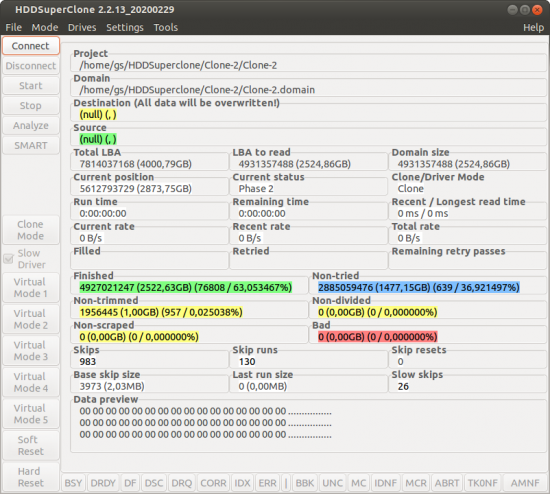

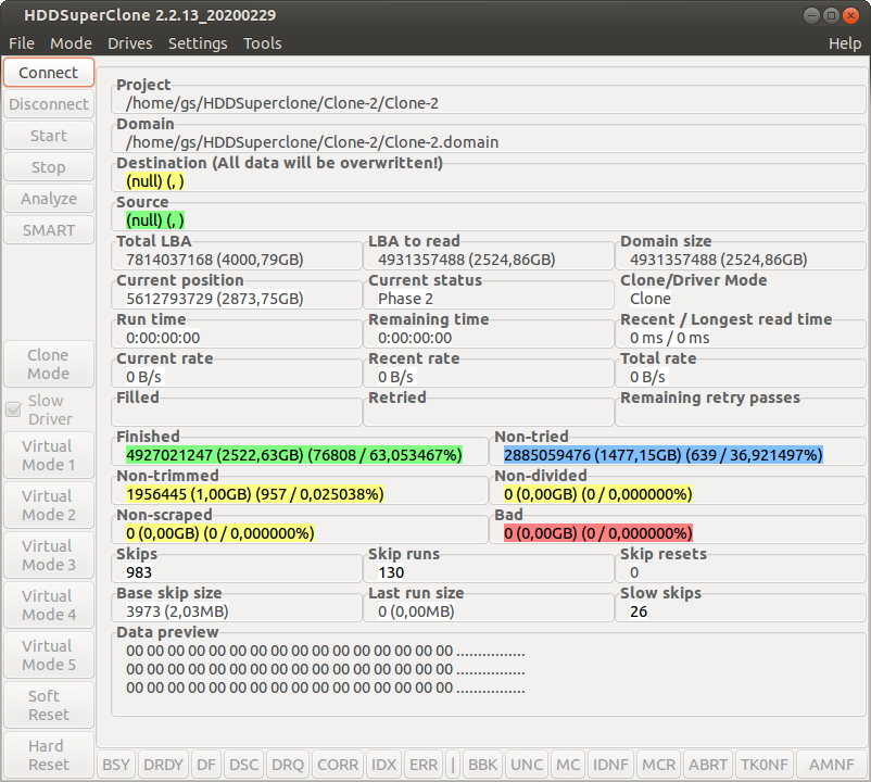

OK, I pressed the power button. Ubuntu reports a "Problem with a system program" on every boot, but HDDSuperclone seems to work OK.
The good news is that HDDSuperclone could work with the file which it had left behind. So it froze this morning around 6 o'clock (timestamp of the file) in Phase 2, meaning Phase 1 has completed:
All settings were still there. So I connected source and target again and restarted. Relative to the previous screenshot, it jumped forward quite a bit and it is still reading some data:
Going slow now, because it is at the hard-to-read stuff. It is great that the files were not corrupted and HDDSuperclone still knows where it was. I thought that all might be lost. The program seems to have been built with power outages and the like in mind. But if it hangs, it will freeze the whole Linux, at least mine. I saw that already, when the cluster size was too high.
Guess at some point it will be time to stop and see what usable data can be extracted from the clone.

You should let it finish phase 2 before you try to access data. Phases 1 and 2 are the money passes, they get the most good data first. After that it is digging for data. It is up to you to determine how long to let it dig in the following phases.
And yes, HDDSuperClone is designed to deal with unexpected crashes or power outages.

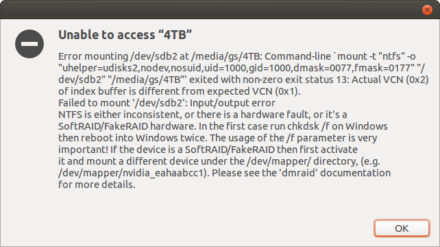

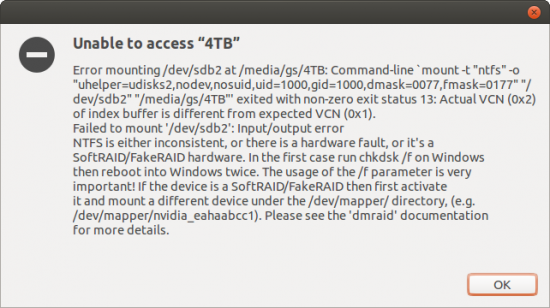

The clone does not look good. When HDDSuperclone had finished, I saved everything, closed it and tried to mount the clone. On eSATA, I got this error message:
The one thing I will sure not do is let chkdsk loose on the clone, as that message recommends. Guess I best keep it under Linux, because Windows might do something without asking.
On USB, Linux will not even notice that a USB-device has been attached. I tried it on both the laptop (USB 2.0) and a desktop running an up-to-date Ubuntu 18.04 (USB 3.0).
The only interface which still lets me see that there is a disk at all is eSATA on the laptop. That is something, for a moment I was afraid that I had bricked the new 4TB-HD. Guess the only way to go from here is to start DMDE or something and see if it can work with that clone.

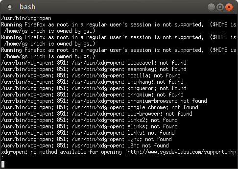

Update: I just tried to click About--->Support Information in UFS-Explorer. Nothing happens, but this appears in the parent shell:
Well... no comment. :|
