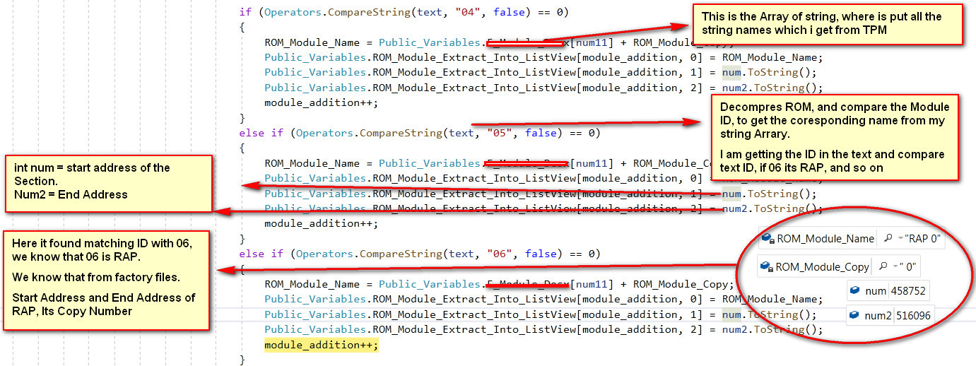

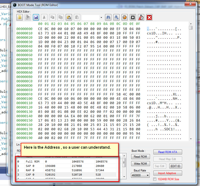

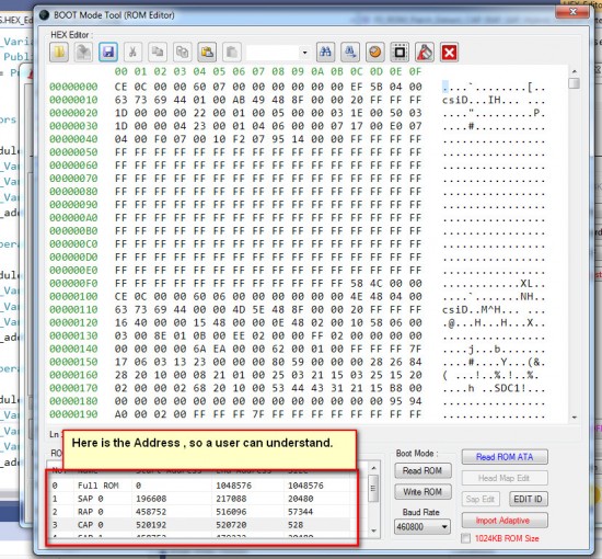

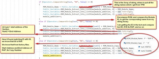

Regarding Names in the ROM.
I already uploaded the picture here in the post, that i know the names, and how to get. it was not in the ROM.bin file
If some one says that rom.bin have names Show with some proof atleast.
Here 1 person show only with CPRS, then i tell him to show RAP CAP SAP Names in the rom, then he says its encrypted.
i not ask him to show method. i just say him to simply show a picture or RAP CAP SAP in the ROM.bin file
Almost every one can Get that CPRS name by using any Hex Editor.
AIUI, @pepe is saying that there are no module names in the ROM, even after decompression.
pepe wrote:
you cannot find RAP, CAP etc strings in rom for two reasons: most of the rom code (bootfw) is compressed, and it does not contain such strings even after decompression.

Hi Again
Here is the Brief about the ROM Sections
Here i Decompress ROM and assign the names Manually depends on there ID Number.
And after that here is the windows, where is ready for user.

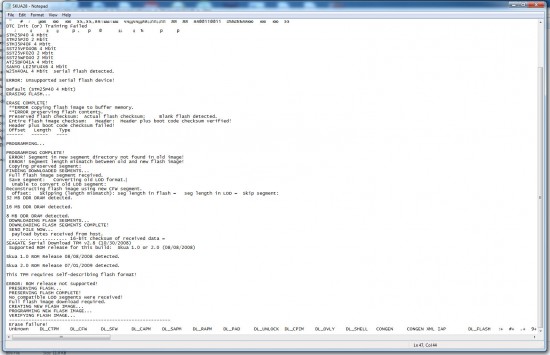

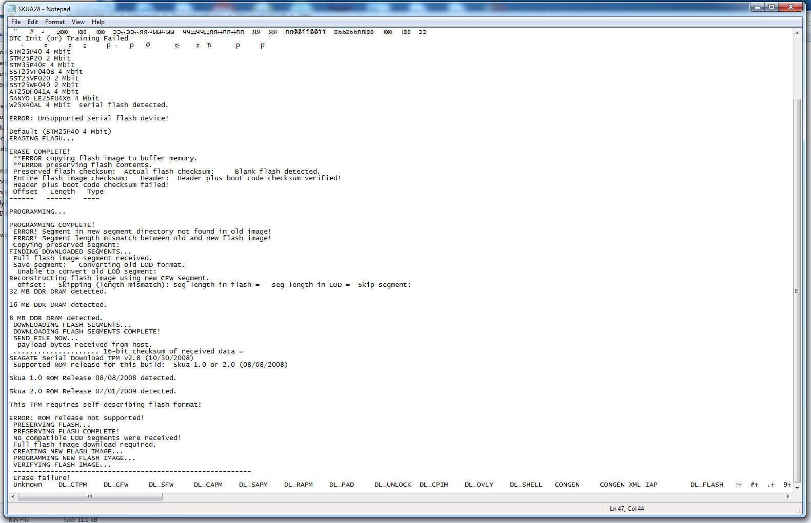

So we Get the RAP CAP SAP ID from the ROM.bin
and by programming we Set the String Names to the ID.
As i do .
I hope now every one know that we cannot get Names without Factory info.
From ROM, we can decompress to get ID only, not the names.
i think eaxi says, that i can get the Names from ROM, and he show by IDA Pro the CPRS names,
But when i ask him RAP CAP SAP Names, he not reply any more.
if i am doing wrong to get those names, please Correct me, so i can do it more good way , and add in my Software.

names and even id do not matter.
80h added to each id number
https://yadi.sk/i/FSmK-TgPmruX5A
this is a fully working ROM :)

Dear Ali,
You have great difficulties with understanding English. This is not my native language also, as readers can easily conclude :), but I hope my posts are understandable, on contrary to yours.
You wrote:
"i think eaxi says, that i can get the Names from ROM"
You are completely wrong. I didnt' say, that there are text "names" of ROM modules in ROM. They arent'. :) ROM modules names can be extracted from p.e. factory logs, but you are unable to do it. You have just copied ROM modules names from public net resources and you didnt' make any your own reversing.
"and he show by IDA Pro the CPRS names"
I didnt' show any "CPRS names". What are "CPRS names" ??? You mean "CPRS" marker in compressed parts of ROM? It's not "CPRS name". It's a marker like "MZ" in exe, "PK" in zip, "Rar!" in rar, etc.
About IDA:
You uploaded an image of module which you extracted from flash-rom using F3ROMExplorer, asking what's its name. It has no name. There is no reason to give public name for part of low-level code, which is unusable apart. It's part of DL_CFW, loaded to [0], present in every ARM embedded code - interrupt table, interrupt service routines, etc.
You uploaded a file "ROM _Decompress.zip". Nothing is "decompressed" by you here. It's normal ROM, including compressed sections also, like DL_SFW. You didnt' decompress anything of it, so dont' call it "ROM _Decompress"... :)
You wrote "here is the Original TPM file"
It's not "TPM file". It's a part of factory log, present on many disks after normal factory disk initialization. It described Seagate's TPM file use, not TPM written or owned by you.
I suppose you try to get knowledge from others, p.e. how to download ROM by ATA. You hope people will share knowledge with you FOR FREE, and then you will use it in your "software".. FOR SALE. Really funny :)

ROM _Decompress , this is original rom, which i open i my srs software to show rap cap sap
Are you serious, can't you see my software there, i open in my software SRS, not in F3ROMExplorer
I de-compres the ROM in SRS, to show all things, and in SRS i show in RAP CAP SAP Copy 0
If you don't even know about TPM files please don't say thing about that.
i know that at your point the TPM files looks like this,
TPM Text for ROM Write.txt [12.6 KiB]
Downloaded 421 times
i think you not saw the pictures which i uploaded with that Decompress ROM. you just take the ROM. open and check, Off course its the original rom.
my own research is enough to add in my software.

@waqas_ali766, I watched your video (nice!), but I still don't understand why you are claiming to have decompressed the ROM. AFAICT, you don't need to decompress the ROM to do any of the things that you have demonstrated.
Would you mind uploading your tool's decompressed versions of the various CPRS sections? I know how to decompress WD's ROM modules, but I confess that I don't know how to do the same for Seagate's.
BTW, can your tool patch the ROM in the way that PC3K does (to defeat the terminal lock)?
