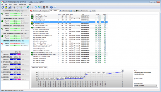

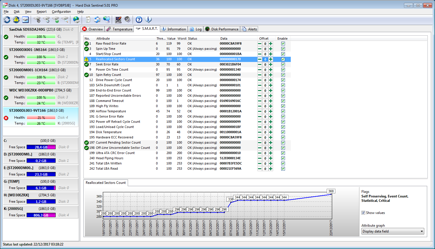

Drive self scans for errors. According to some sources it starts self scanning as quick as after 20 seconds being idle. I assume these are read tests. As drive itself has no idea which sector contains user data or not drive will make problematic sectors pending which are then reallocated at write and added to grown defect list rather than just reallocate them on it's own.
Yet there are drives which reallocate sectors without any write operations... I have a Seagate ST2000DL003 which behaves like that, each time I plug it again (which I haven't done in a long time, as its whole contents have been transfered to a healthy drive), the number of reallocated sectors increases regularly, according to HD Sentinel, while the drive stays totally idle. Last time I checked (phew, that was almost 3 years ago !), it was at 368.

Could it be retrying (pending or any) sectors when idle and then when it all of a sudden gets a good read, then re-allocate? That way reallocation can be explained even when idle.
 Post subject: Re: Hdd and badblock
PostPosted: September 21st, 2020, 17:18
Posts: 4808
yes, i think it relocates it if it can recover data from a pending one.
at least it should
