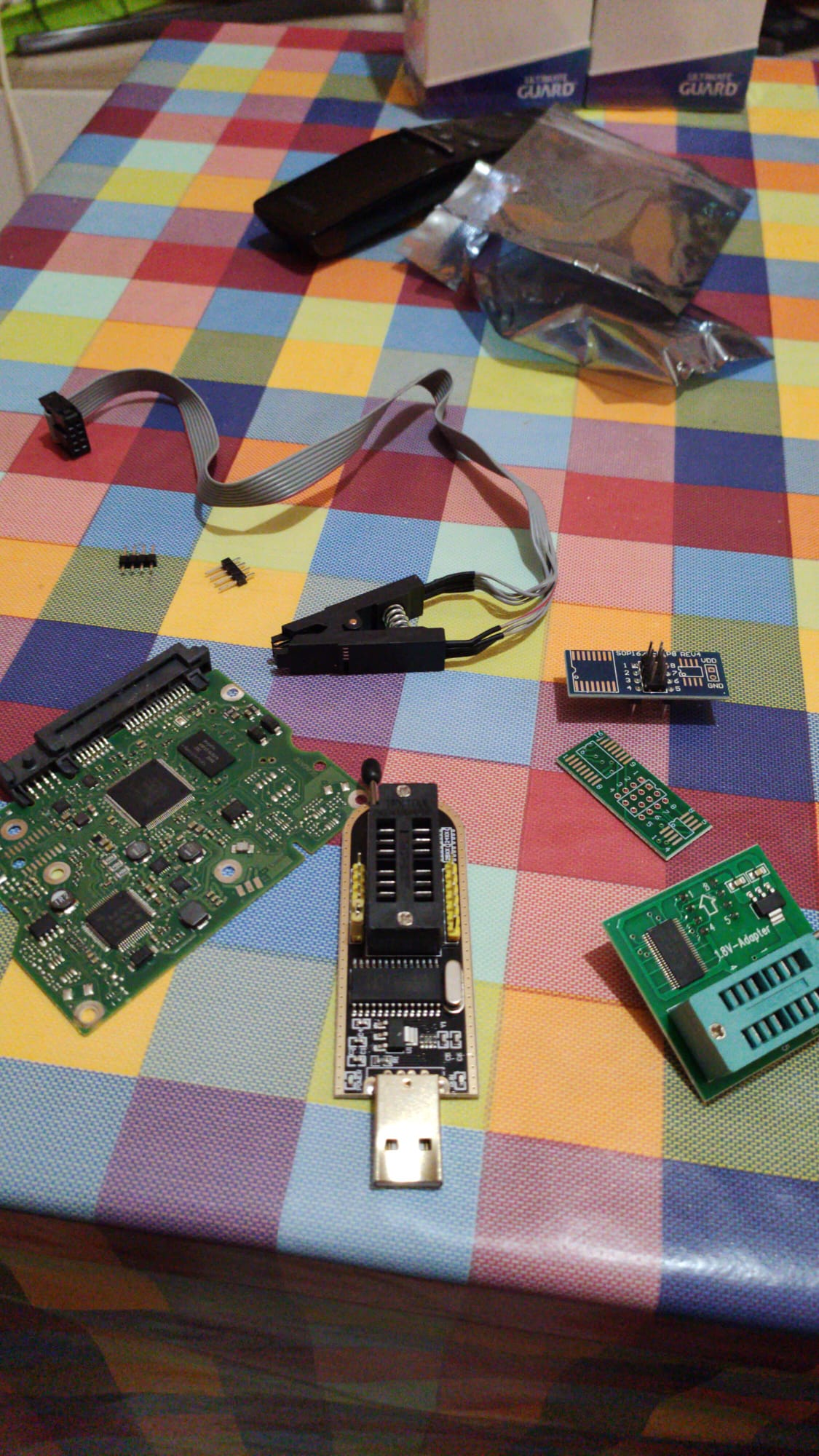

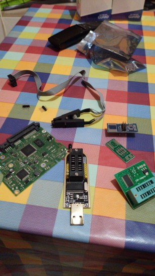

Here's what I got for a few bucks... Let's see what happens next...
1 - Imma try to read my own ROM
2 - Then I'll be uploading its content here and you guys tell me what to do... hehehe
File comment: Here's what I got for a few bucks... Let's see what happens next
