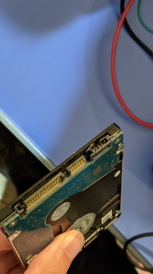

pepe wrote:
I am curious about what it spits out during powerup. That's all.
something like
Boot0x80
trans
Rst0x80
some MCMT related messages...
etc
Pepe, Do you really need to see the terminal's log? ....
This is a rossewod.... SA degraded and everything related to it, pending sectors, corrupt/damaged translator, MC and a long etc.....
A humble piece of advice, don't have the drive connected too long, do the tests you have to do quickly and don't play with it anymore. Every minute connected in this state is reducing the chances of recovery, the butter is melting very fast..........

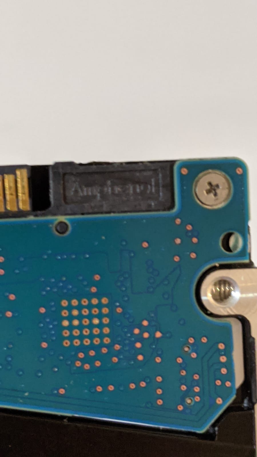

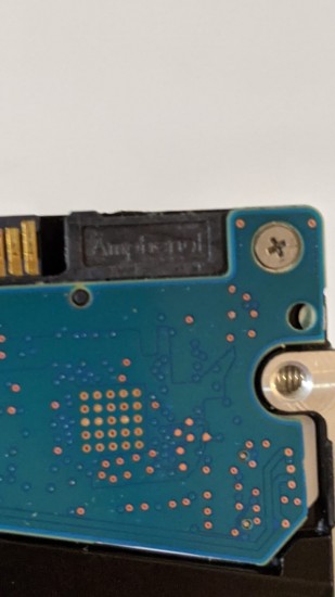

yes, it's all true, but:
i expect a log after powerup, no need to interact with it at all.
then we will have moral basis to say something like take it to a pro
moreover we make it clear it is not related to the pcb (which is 99+% but there's still a small chance, coz something visibly changed on it ).
BTW, the black looking part on the pcb is neither a cap nor a resistor, it is an inductor in fact.
2 OP: once connected to the serial port, don't run it long, 10-20 seconds is enough.

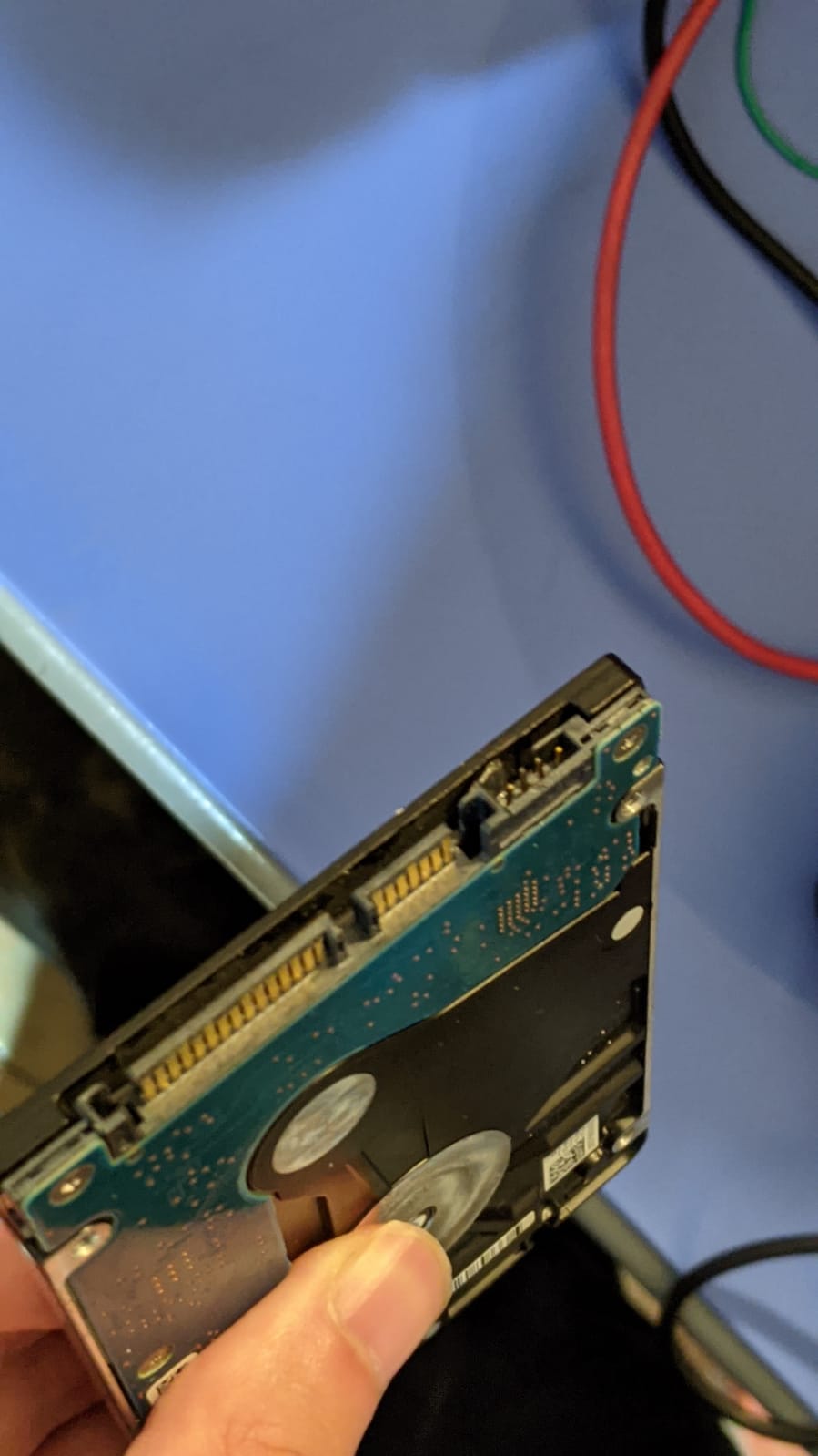

pepe wrote:
+1 for BGman.
People who know how to do it won't engage into a never ending course, those who think they know it may give you ideas.
We can check the terminal log for you and give an idea what could be wrong but you won't be able to do anything in the terminal since it is locked.
What you may try is cloning with HddSuperClone, there are plenty of references to it on this forum. But i don't recommend skipping the terminal log step...
Such job takes a few hours for those who know what to do and have proper tools, while it takes weeks to teach somebody with zero insight in the field, while we can expect drastically lower success rate. So what's the gain?
You do what you are good at and we do what we are good at.
Btw, without sharing your location we can't even recommend anybody who might be able to help you locally, probably at a fraction of the amount you mentioned, at this stage. It can reach a higher amount if the condition of the drive gets worse though.
1, Israel

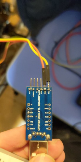

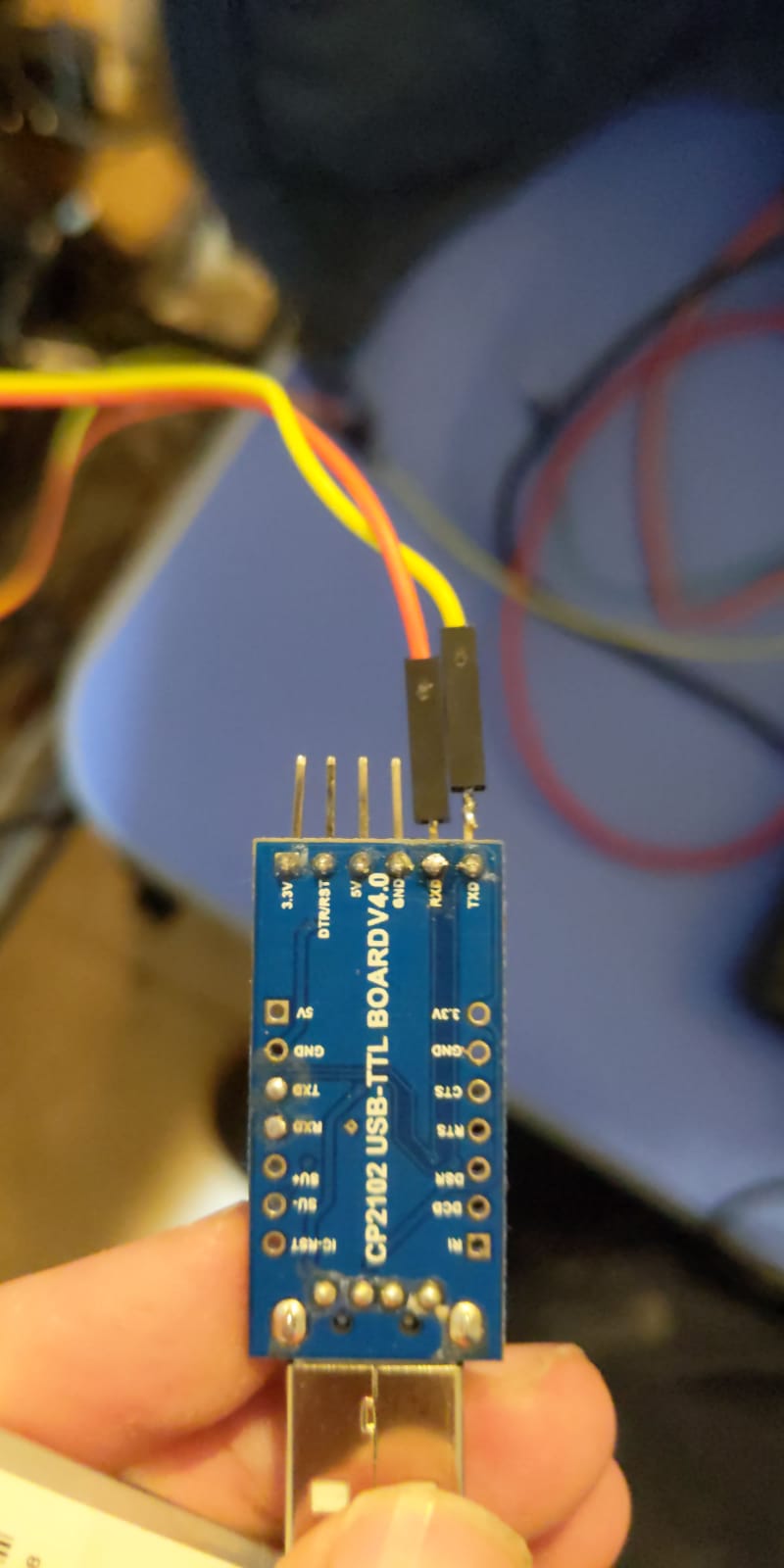

2, What baud should i listen to ?
3, what commands should i run while in terminal
4, i want to acquire new skill so ye i'd like to learn and be educate on the matter , im not a lose cause that u can expect me to reach 0 success rate , everyone as to start somewhere ;)
 Post subject: Re: sudden death ?
PostPosted: November 24th, 2020, 12:49
Posts: 4754
BR=38400
No need to run any commands, you can't (most of the commands are not accessible) and you should not run anything anyway without knowing what you are doing.
This drive is not the right one to start with. You won't get anywhere with it because you have no ways to access its firmware. As i said, the most you can do is trying to clone it, after we checked out the terminal log. But as others said it is very likely that it will get worse and that you end up with a dead disk and few data (if any).
you can learn a lot reading the forum, but as long as i am concerned, i won't provide free DR courses.
If you wanna get involved in this field then you need to invest time and money. I think it is not easy to start up a dr business these days.
You need to invest in tools and pick up a LOT of knowledge, presumably have some degree in electronics and programming, dig into file system structures, understand low level computer technology and understand how HDDs work. You can get an introduction into this latter topic by attending a training course of some DR tool manufacturer, but this will not provide you with ultimate skills, more like an introduction IMO.

Believe me this is not the right choice for starting learning about hard drives. You are right about me in those statements, but if i start learning something i usually start at the beginning, try basic and easy things like building a 'hello world' kind of app.
Rosewood drives are just not like that. Try starting with a drive from before 2013.
about the lock thing: it applies to diagnostic commands, both ATA and terminal. It does not affect normal drive funcitions, so user can read and write normally, provided the drive works ok otherwise of course.

here i am after 2 month of waiting for everything to come .
about a week ago , just started on it today , i am a horrible solder :D its soooo small
im not sure if i burn out the cap/transistor or w.e was it , but i am having the same issue after replacing it , i tried rs232 with the CP2102 USB to TTL no output so im not to sure if i connect the right way the connection .

so to make sure i got it right .
from RS232 RX to TX on hdd
from RS232 TX to RX on hdd
any other connection should be do except power?
do GND / VCC as to be connected aswell ?

i got no output unfortunately , not from the trace point nor from the connection themself. (near the sata port)
i connected , A tx H rx and A rx H tx , then i tried separately on A rx H tx . with PSU power + SATA data and with out SATA data .
i get nothing , not even art effect
PostPosted: January 12th, 2021, 18:28
Posts: 4754
do you get anything if you connect adapter tx and rx together (loopback) and open the port in a terminal program and type some characters? do you get an echo through the loopback?
