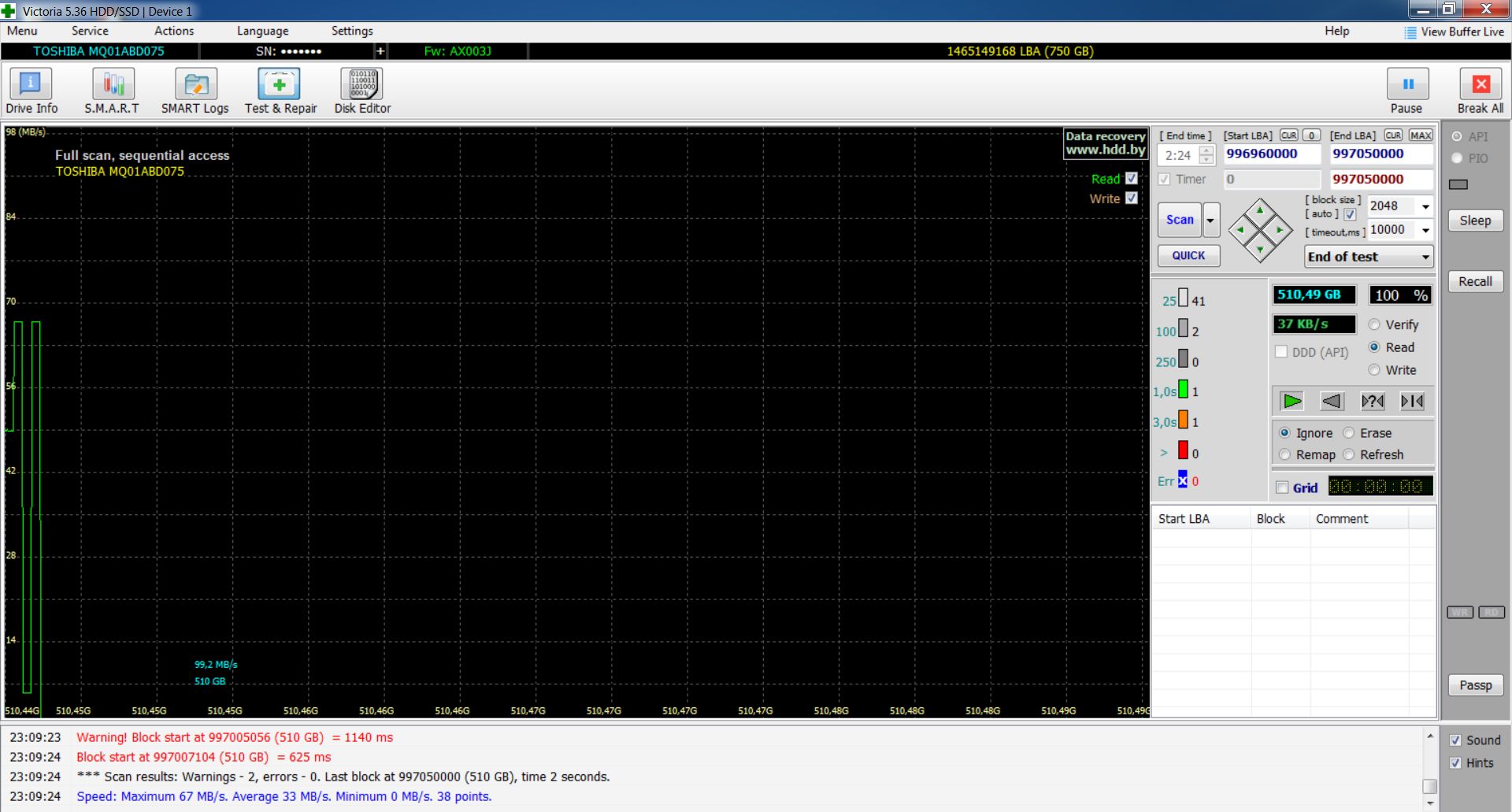

Forget for the block size 1 for the moment.
Look if the orange is now repaired at LBA 997005312, do a Victoria read with block size 2048 from 996960000 to 997050000.
If the block is now fine, redo a full read with the chart, and enlarge the log window for we see the warnings.

I did several tests including the range where the problematic sectors were located in the previous tests.
The exact address of the slow sectors shown in the previous images has changed, but other slow sectors are still detected in the space around 510 and 618 MB.
Below the tests log:
    Victoria 5.36 HDD/SSD | Device 1 log file. 19/04/2021
    23:08:16 : Starting Victoria 5.36 HDD/SSD. 1xCPU, 2198,09 MHz, Windows 7 x64 found.
    23:08:16 : [Hint] Recommend 32-bit Windows XP for a best work!
    23:08:16 : Warning! Windows x64 detected! PIO mode supported on Windows x86 only.
    23:08:16 : API access enabled, device #0
    23:08:17 : Get drive passport... OK
    23:08:17 : Model: TOSHIBA MQ01ABD075; Capacity 1465149168 LBAs; SN: *********; FW: AX003J
    23:08:17 : Press F1 to About/HELP
    23:08:20 : Get drive passport... OK
    23:08:20 : Model: TOSHIBA MQ01ABD075; Capacity 1465149168 LBAs; SN: *********; FW: AX003J
    23:08:39 : Get drive passport... OK
    23:08:39 : Recallibration... OK
    23:08:39 : Starting Reading, LBA=0..150000, FULL, sequential access, timeout 10000ms
    23:08:40 : *** Scan results: no warnings, no errors. Last block at 150000 (77 MB), time 1 seconds.
    23:08:40 : Speed: Maximum 89 MB/s. Average 66 MB/s. Minimum 44 MB/s. 68 points.
    23:09:21 : Get drive passport... OK
    23:09:22 : Recallibration... OK
    23:09:22 : Starting Reading, LBA=996960000..997050000, FULL, sequential access, timeout 10000ms
    23:09:23 : Warning! Block start at 997005056 (510 GB) = 1140 ms
    23:09:24 : Block start at 997007104 (510 GB) = 625 ms
    23:09:24 : *** Scan results: Warnings - 2, errors - 0. Last block at 997050000 (510 GB), time 2 seconds.
    23:09:24 : Speed: Maximum 67 MB/s. Average 33 MB/s. Minimum 0 MB/s. 38 points.
    23:10:27 : Get drive passport... OK
    23:10:27 : Recallibration... OK
    23:10:27 : Starting Reading, LBA=1207900000..1208000000, FULL, sequential access, timeout 10000ms
    23:10:29 : Block start at 1207945056 (618 GB) = 921 ms
    23:10:29 : *** Scan results: Warnings - 1, errors - 0. Last block at 1208000000 (618 GB), time 2 seconds.
    23:10:29 : Speed: Maximum 67 MB/s. Average 37 MB/s. Minimum 7 MB/s. 43 points.

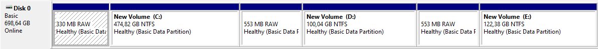

I think that those parts are going to stay problematic.
So I recommend you to right partition, that is anyway the most safe way you have.
Use a margin of 250MB that is finally enough, like 250MB-weakpart-250MB.
You will likely have to get 3 partitions, here how to calc them:
250MB = 250*2*1024 = 512000LBA
512000LBA = 512000/2/1024/1024 = 0.24414GB = 0.24GB or 0.25GB
109000-109631
110000+512000 = 622000LBA = 0.29659GB = 0.32 GB first partition start
997005056-997007104
997005000-512000 = 996493000 = 475.16489 = 475.14 GB first partition end
997008000+512000 = 997520000 = 475.65460 = 475.68 GB second partition start
1207945056-1207945552
1207944000-512000 = 1207432000 = 575.74844 = 575.72 GB second partition end
1207946000+512000 = 1208458000 = 576.23767 = 576.26 GB third partition start and go to end
There are lot of chance that the others 500 realloc are part of those defect parts.
I have about added them to the calc, and re-added or sub about 0.02GB margin.
Confirm that your tool for partitioning is reporting your drive as about 699GB capacity before apply those kind of partitions.
I recommend you doing a last full read and adapt your partitions with the help of the slow sectors.

Yes, scanning the affected areas with "Block size 1", you can see that there are many dozens of slow sectors. This is the final result of the partitioning:

In the last few days, I first did a complete formatting of the three partitions, then filled the disk with the backup data. Now there are about 50 GB of free space.
After writing the first 145 GB to the first partition and disconnecting and reconnecting the disk, I noticed that Crystal Disk Info reported another reallocation event with 8 more sectors reallocated for a total of 640.
After this reallocation of sectors no other reallocation occurred, but the task of this disk is now to be used for reading operations only if ever needed ...
