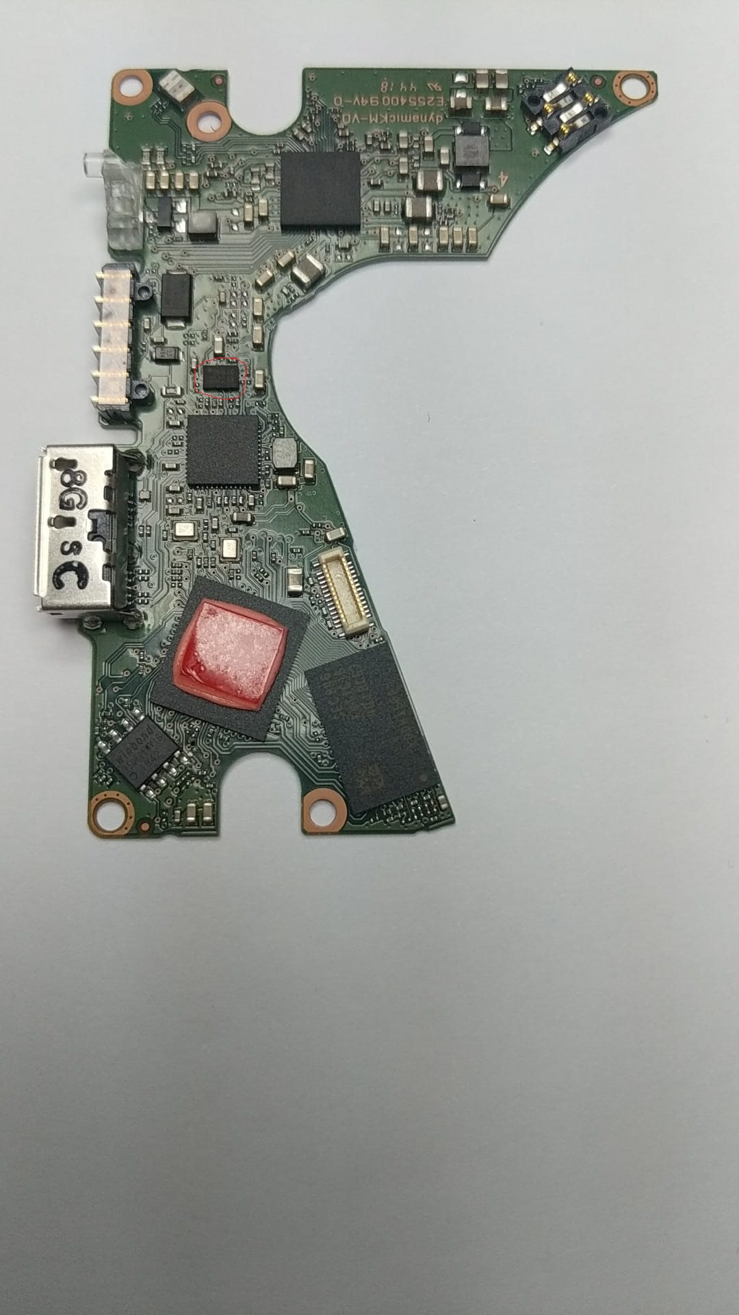

Did you transfer this from patient to donor?
 Post subject: Re: WD Charger - 800067 - USB connector cracked
PostPosted: December 17th, 2020, 10:33
Joined: December 14th, 2020, 11:51
Posts: 57
Location: France

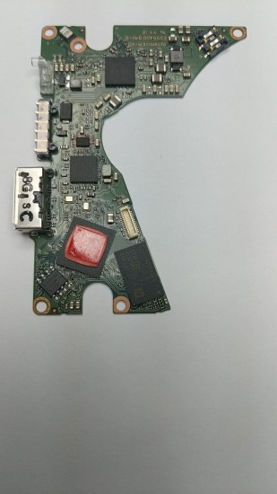

Case solved.
I had another PCB 800067 with a Macronix ROM. I wrote the BIN to that one and it works directly. Not sure why it's different compare to the WinBond, probably not related to the ROM but to other component on PCB
Thanks to all for your help.
