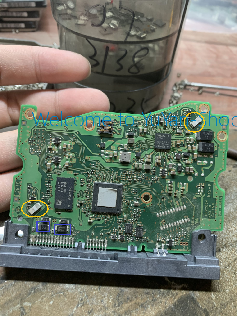

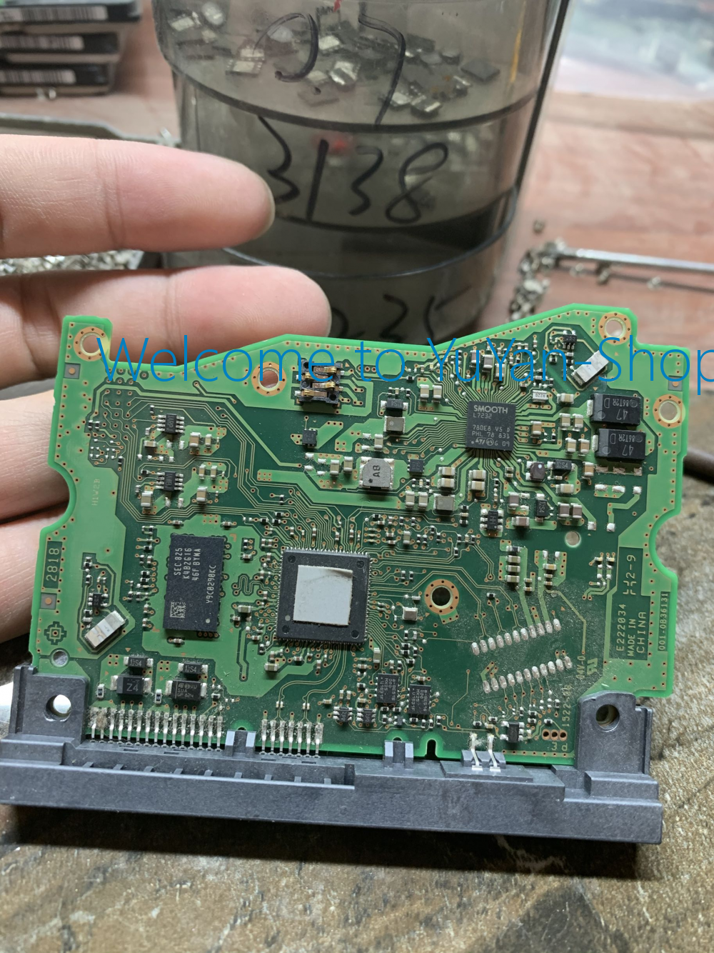

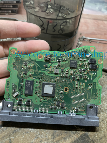

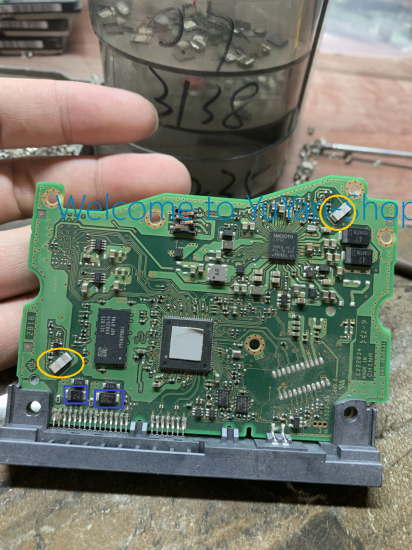

@fzabkar I am attaching 2 pics of the board(I got the pic from ebay). I attached one unaltered for you to use if you need to mark on it to show me anything.
The items circled in yellow...I am not familiar with these. What are they? http://spritesmods.com/?art=hddhack&page=2 claims they are shock sensors. If so, could they be "tripped" and making the drive "lock?"
The blue squares....are they the TVS diodes that you are talking about?
Re: What tools support WD/HGST Black and Red Drives?
December 27th, 2020, 1:46
You have correctly identified the TVS diodes. The fuses are the smaller components immediately to the left.
Can you measure the resistance of each component on the 200 ohms range of your DMM?
As for the shock sensors, I don't know how the drive would behave if one were faulty.

@fzabkar my board is a little different than the one at reddit. I do not care to take the readings if you will mark my board up with the locations.
TVS and resistor test:
bad board
TVS: 133.4 and 133.1
r1(next to end of sata power connector) .1
r2(middle of sata power connector)open
good board
TVS: 125.8 and 127.3
r2(middle of sata power connector) .4
I am guessing that the r2 above should NOT be open. What worries me is that I am accustomed to when a resistor is open, there is usually a short somewhere.
December 27th, 2020, 15:04
Those are fuses, and yes, it is open.
If you follow that other thread, you may find that bridging the fuse (replacing it would be better) will recover the drive.

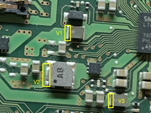

I have marked 3 voltage test points.
December 27th, 2020, 15:56
Bad board
V1 132.2 (200 setting)
V2 183.3
V3 166.9
Good Board (I had to go to 2k setting)
V1 953
V2 450
V3 557
December 27th, 2020, 16:16
If the bad board gives similar results on the 2K setting, then I don't see a problem.
BTW, you should get a different result at V1 when you reverse the polarity of the probes. That's because the meter is seeing the resistance of the Schottky diode (LS4) nearby.

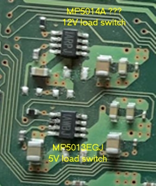

The board appears to have additional protection in the form of two load switches. I would think that all power would pass through these, so any overvoltage would kill them, or be contained by them.
MP5013EGJ, Monolithic Power, Programmable Current-Limit Switch with Over-Voltage Clamp and Slew Rate Control, 3V - 5.5Vin, 2A, 22V max, marking AWBy, TSOT23-8:
https://www.monolithicpower.com/en/documentview/productdocument/index/version/2/document_type/Datasheet/lang/en/sku/MP5013E/
MP5014A ???, Monolithic Power, Programmable Current-Limit Switch with Over-Voltage Clamp and Slew Rate Control, 12V, marking ARPy, TSOT23-8:
https://www.monolithicpower.com/en/documentview/productdocument/index/version/2/document_type/Datasheet/lang/en/sku/MP5014A/
Note that the 12V load switch has been incorrectly identified as an MP5014A, but I expect that it should be equivalent to the actual part, whatever it may be.
If either load switch is faulty, then it should be possible to bridge Vin and Vout, for data recovery purposes.

@fzabkar I bridged the open resistor and the drive is spinning! Thank you for the help.
