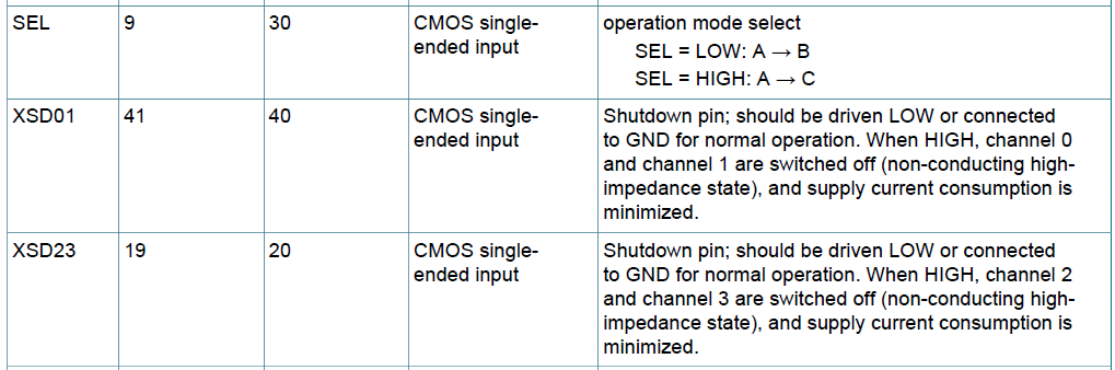

I contacted the seller of that dual slot adapter and was told that the markings on the ICs are as follows:
NXP
LO4083A in this line I was unable to properly read the letter O or the #0
AS377.101
ZSD1516 in this line I was unable to properly read the Z or #2
RCO5133PT
242B1
1740
PST54426
73TG4
A3KS

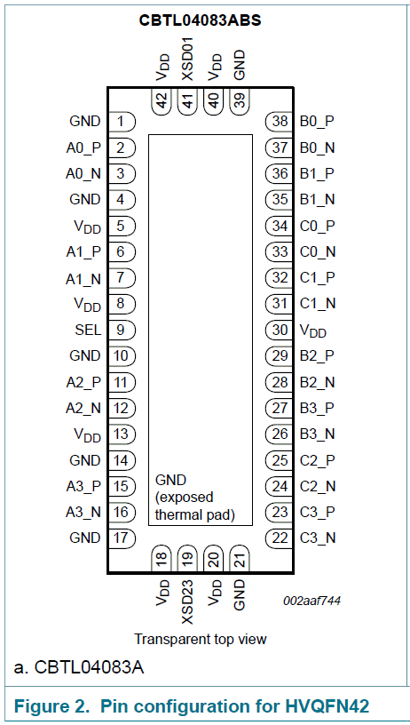

I haven't been able to identify "RCO5133PT" (or RC05133PT), but the other ICs are ...
CBTL04083A, NXP, 4 differential channel, 2-to-1 multiplexer/demultiplexer switch for PCI Express Gen3, HVQFN42:
https://www.nxp.com/docs/en/data-sheet/CBTL04083A_CBTL04083B.pdf
TPS54426, Texas Instruments, 4.5V to 18V Input, 4-A Synchronous Step-Down Converter:
https://www.ti.com/lit/ds/symlink/tps54426.pdf
ISTM that RC05133PT is a controller, possibly a custom programmed MCU, which controls the SEL and XSD01/XSD23 pins of the two 2-to-1 muxes. Without a driver or tool, I can't see how it is possible to make use of this adaptor.

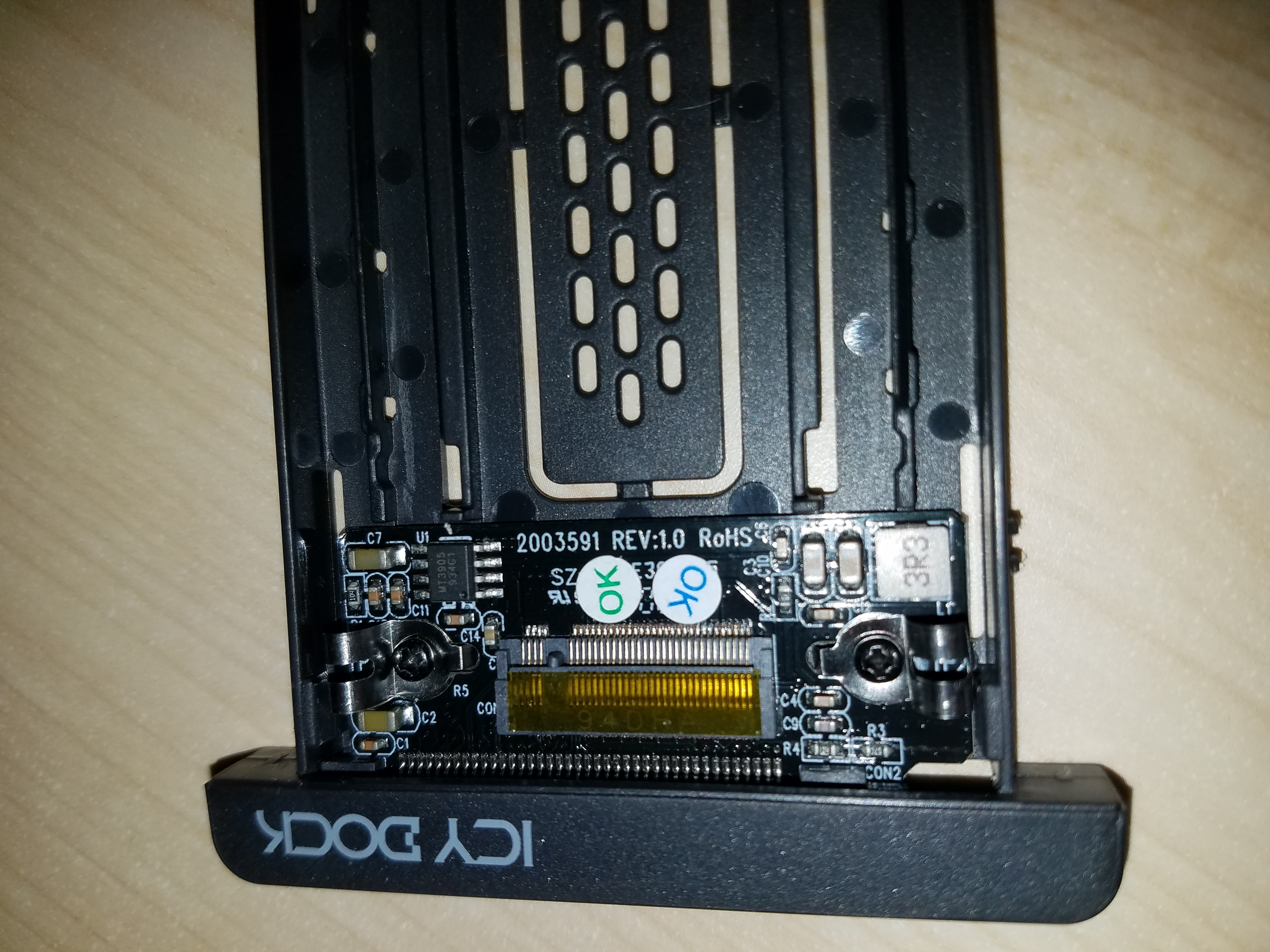

Could we see a close-up of the small PCB in the Icy Dock?
 Post subject: Re: M.2 NVMe pcie to USB 3.1/ 3.2 casing
PostPosted: January 22nd, 2021, 19:22
Posts: 992
I was going to get to that... here is the best pic I managed to get.

PostPosted: January 22nd, 2021, 19:34
Posts: 17336
It looks like there's nothing other than a 3.3V DC-DC converter.
ELM613NDC, Elm-Tech, 4A, 30V, 500kHz, synchronous step-down DC/DC converter, 4.0V - 30Vin, marking MT3905, SOP-8:
http://www.elm-tech.com/en/products/dcdc-converter/elm613-series/elm613-series.pdf

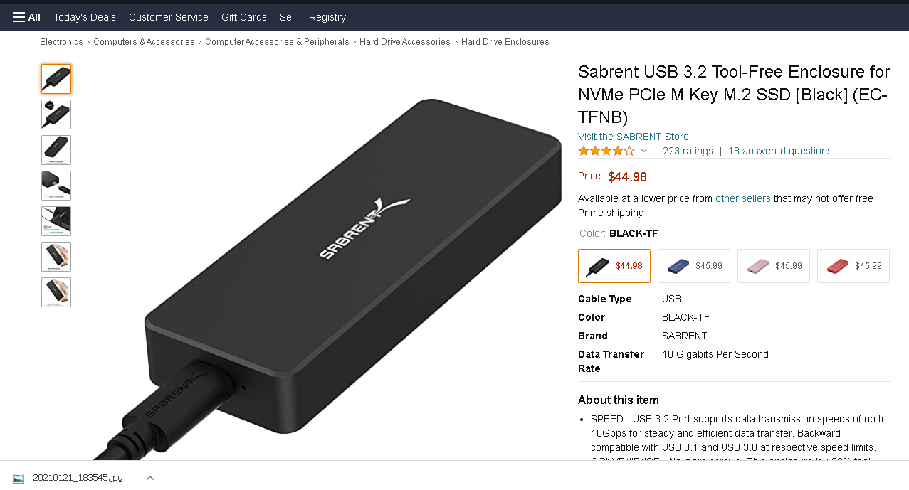

Happy ending to story
Finally I was successful to boot Dell XPS from winpe and extract all data.
Maximus unfortunately I did not cloned disk . I will give it a try this week.
Thank you all for all the help.
Sabrent USB 3.2 adapter seems to be well designed and rugged.
PostPosted: January 23rd, 2021, 4:18
Posts: 17336
Does the Sabrent enclosure use Realtek's bridge?
I have an older 3.0 version, and I think it is good. It has only seen a little use, but there have been no stability issues with the Samsung NVMe I put in it. I don't have any faulty NVMe drives to test with it to see how it reacts.
Part of the reason there has been no work on a passthrough mode, let alone a direct mode for NVMe in HDDSuperClone is that I don't see it as any good if you can't power cycle the device if it locks up, unless you reboot the computer. With USB you can power cycle it. And so far my testing with this other alternative method is not yielding good results with being able to power cycle, so USB still seems best at this time.
