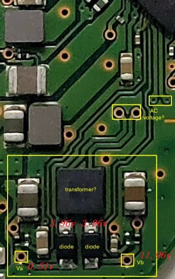

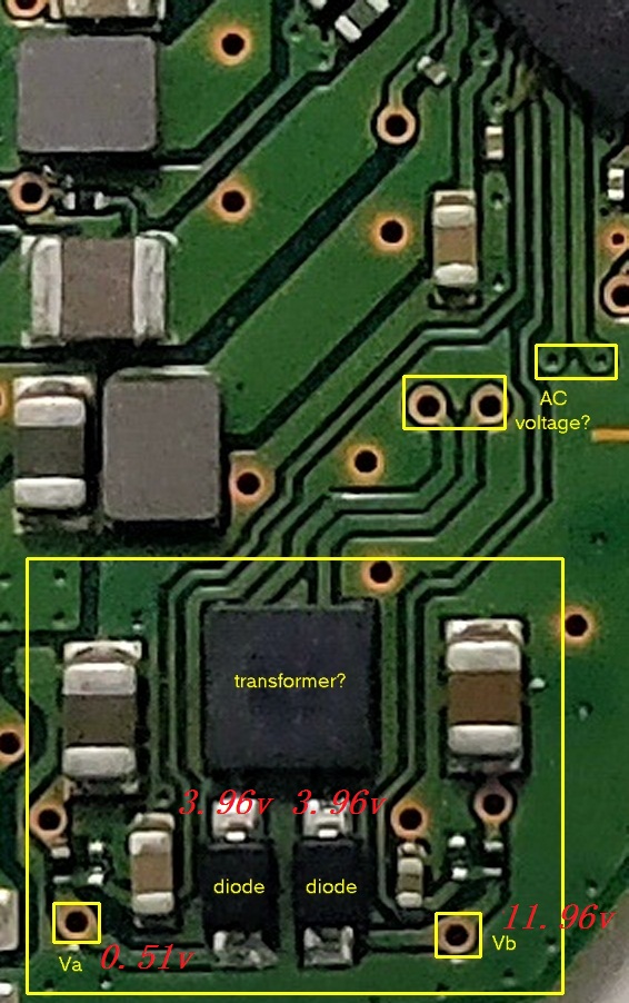

could you please measure the Va and Vb voltages? Pls Let me Know Exact Location

Va and Vb are marked in the photo clip.

Transferred All Three Flash Chips to New Board Still NO SPIN.
In this also Va=0.51v and Vb=11.97v
With these Patient ROMs Donor HDD Spining.
When HDD Spin Va= -19v and Vb=11.97v

Thanks for the voltage measurements. That circuit does look like the power supply for the piezoactuator. However, it appears that I was wrong about the "transformer" -- it is probably just an ordinary inductor. The circuit topology is hidden inside the motor controller, but is probably similar to this (WD20PURZ-85GU6Y0, 2060-771945):

This confirms that it is not a PUIS issue.
What voltages do you measure at the motor terminals on the patient PCB? Does any one winding measure differently than the other two? (One pin is the common terminal)

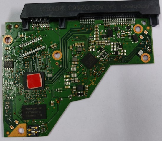

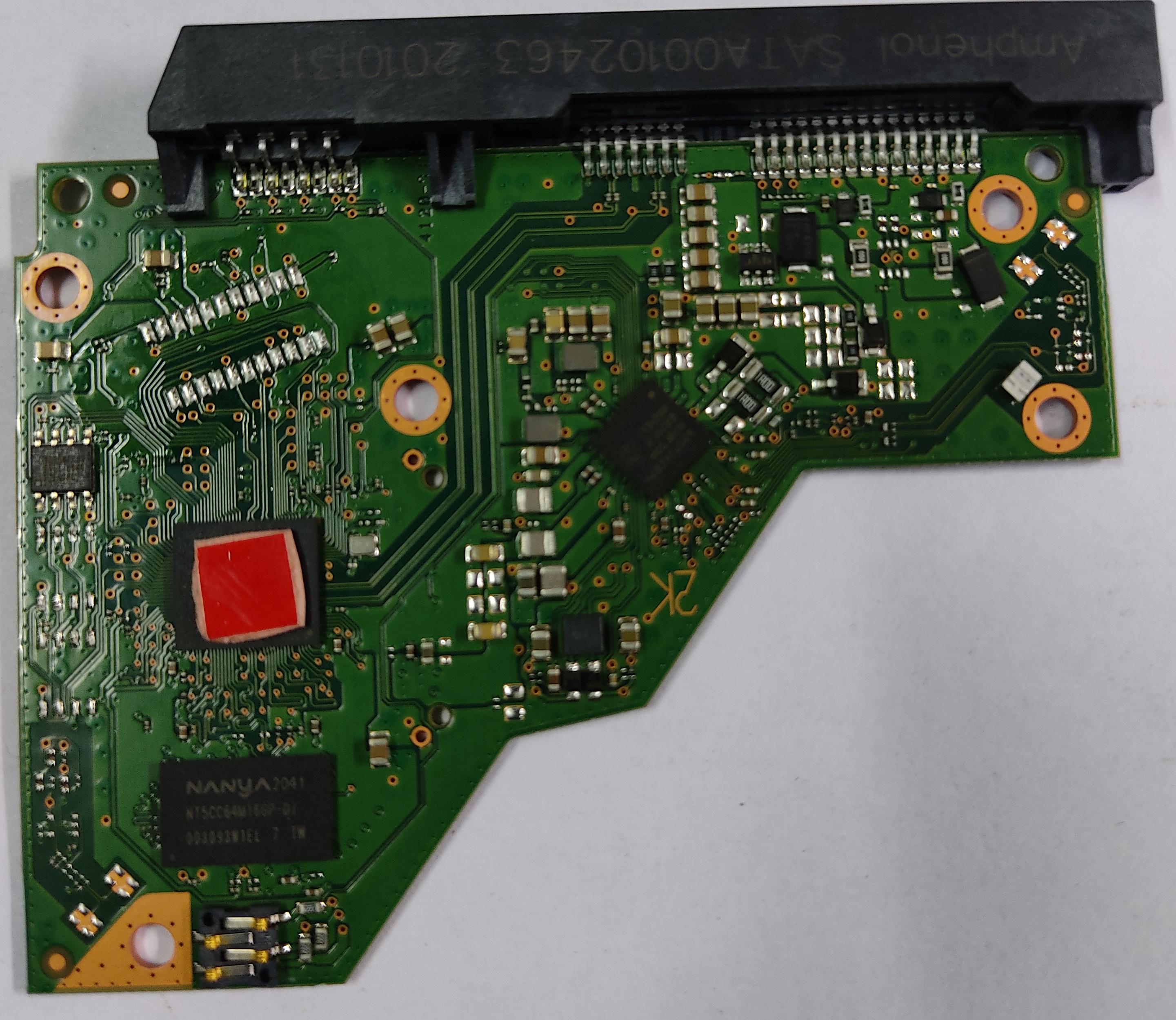

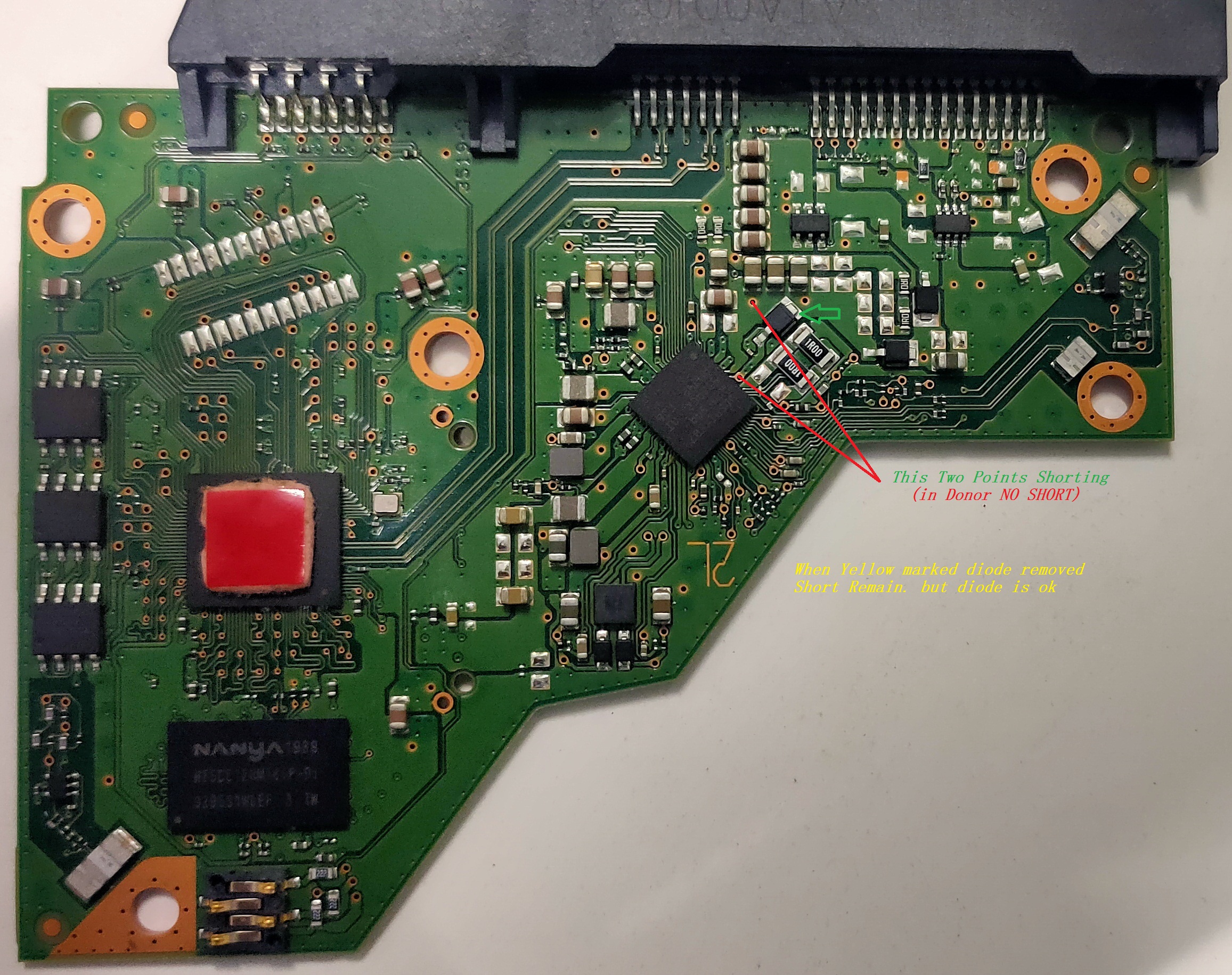

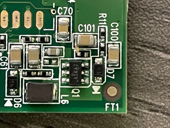

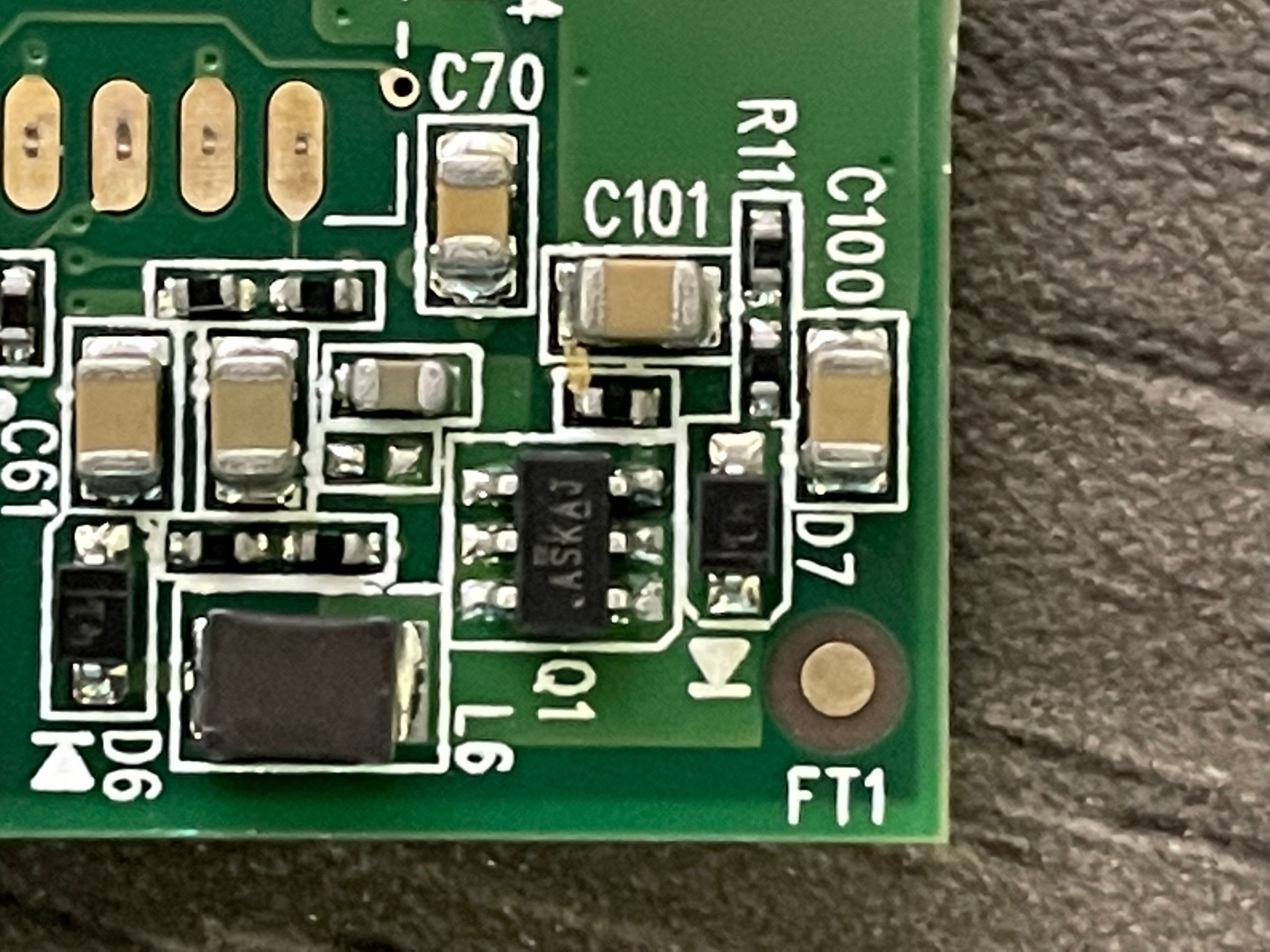

So something in Motor IC?
When Patient PCB with its ROM connected with power and sata => No Spin, but shows Model Only, No Err LED
When Donor PCB with Patient ROM connected with power and sata => No Spin, Shows Model Only, Err LED
will upload Donor image latter?

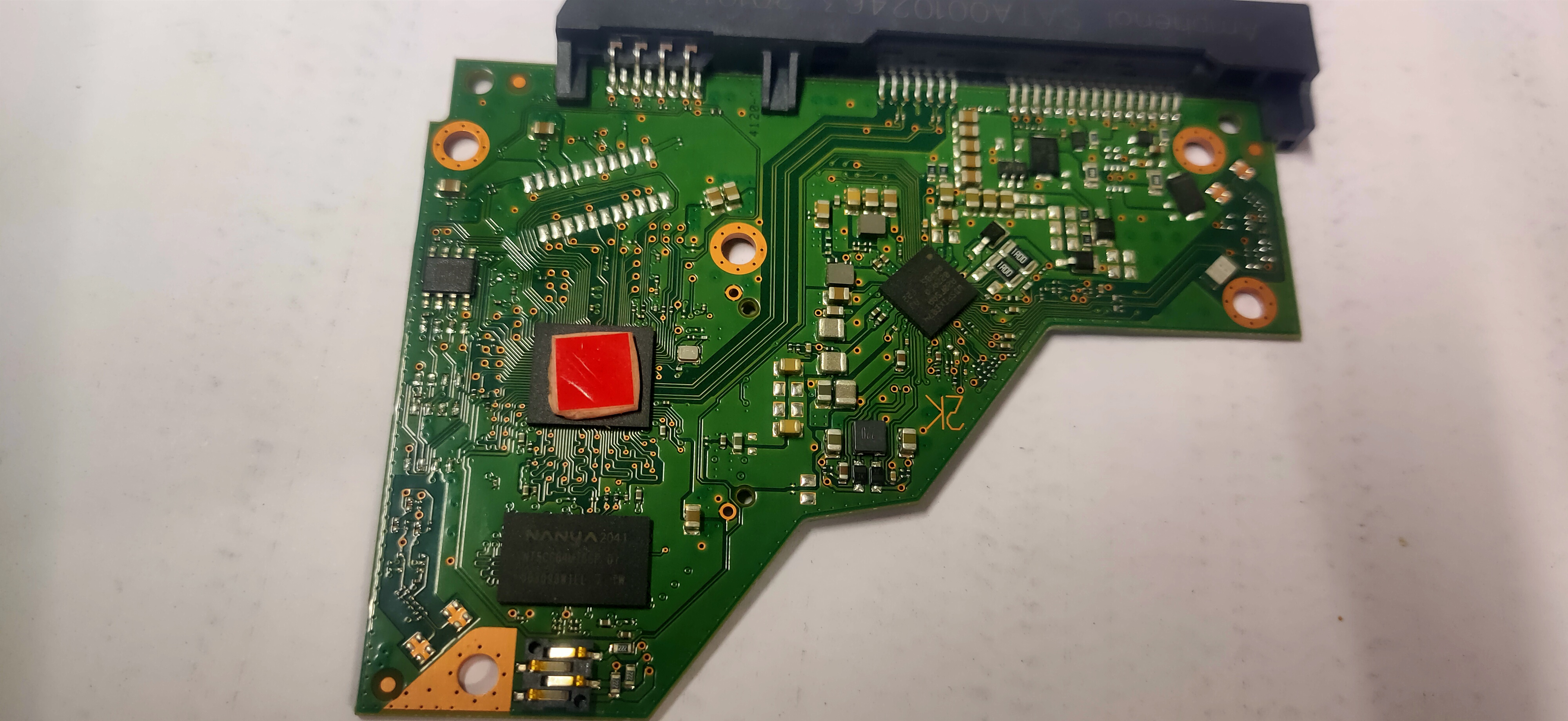

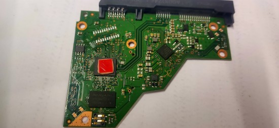

Donor PCB [b]2060-810011-001 P1[/b] HDD: WD40PURZ-85AKKY0

The closest I've got on hand is a WD20PURZ and that's 1.6ohm and 0.9ohm on the windings. It'll check the voltages on the motor connectors in a bit for you.
<edit>
They're only initially powered for 30ish seconds with the pcb disconnected and are measuring around 6v. Try checking yours within 30 seconds of applying power to the pcb.
 Post subject: Re: WRONG VOLTAGE - WDC 2060-810011-001 P1
PostPosted: July 28th, 2021, 15:23
Posts: 17215
It does look like there is a problem with the 12V side of the patient's motor controller IC. I'm wondering whether one of the half-bridges failed and then went on to burn up a motor winding, but I would think that would be unlikely.
PostPosted: July 28th, 2021, 15:36
Posts: 1312
Wouldn't that be reflected in the resistance? I can't see why else it wouldn't power with the donor PCB if the HSA was separated though, wonder if the OP has cracked it open and checked if the spindle turns freely by hand?

The old SMOOTH L7250 motor controller had a Boost voltage which was generated from the 12V supply. If I recall correctly, this voltage was around 18V when the drive was spinning. It was used by the spindle motor drive circuitry. I wonder if that is the source of the short that the OP is seeing across the diode.

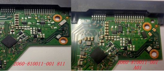

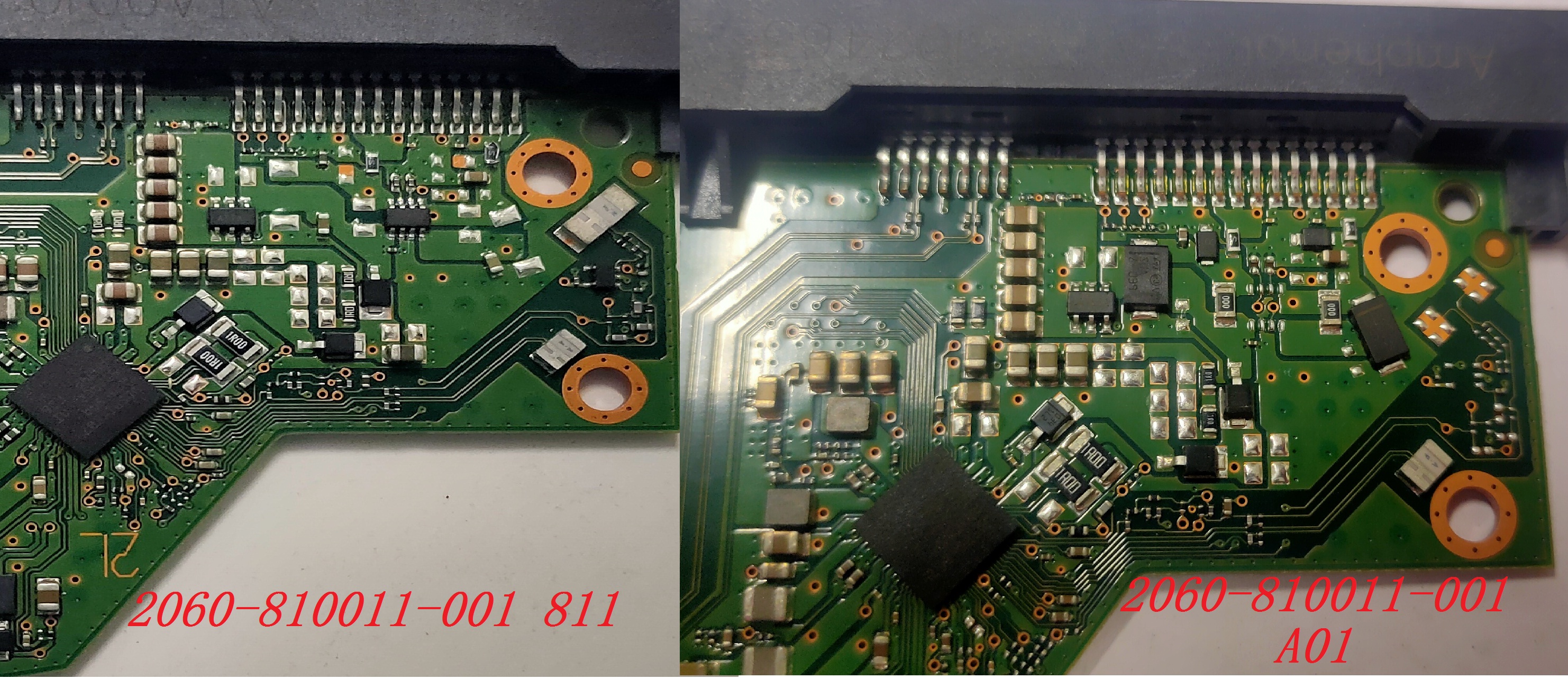

810011-811 differ 810011-A01 with No. of Rom Chips and the Power feed lines

The differences in the protection circuitry do not affect compatibility.
It seems that the patient PCB has more options which are consistent with enterprise or NAS applications, eg rotational vibration sensing. Also, the boot block in the patient ROM has a 0x100-byte signature which the donor does not have.

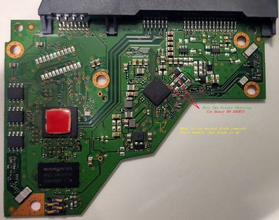

[quote="gps31"]Donor PCB [b]2060-810011-001 P1[/b] HDD: WD40PURZ-85AKKY0
This PCB is Unlocked ( Comes with WD40PURZ-85AKKY0) WD marvel 4.2.1 detected as Appolo CR (Royl)
