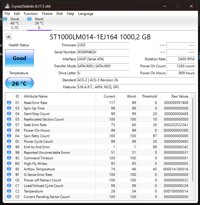

Hello. I’ve read the patient’s ROM using a CH341 programmer and a 1.8V adapter. The chip could only be read after I desoldered it from the board — it wasn’t readable while still on the board. I suspect the terminal was showing a ROM error due to board damage. I’m attaching the file. With this ROM installed on the donor board, the drive starts spinning. Please provide a patched version to initialize the NAND.
ST1000LM014_LVD3_Patient_w25q80bw_patient.zip [674.11 KiB]
Downloaded 186 times

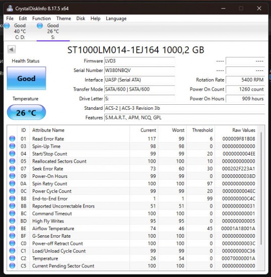

Yes! Yes! YES!!! :cool: :cool: :cool:
Mikippp, thank you! It worked!!! Thank you so much! I'm thrilled! :agree:
I installed the patched ROM on the donor board and connected the SSHD:
Request spin / disc table recovery
ASCII Diag mode
F3 T>/O
F3 O>I
ALF Parametric Tables Preserved
Flash was erased and ALF Tables have successfully been initialized
F3 O>
After that, I flashed the original ROM from the patient and connected the SSHD in the usual way. The drive started working immediately! All my files are intact. Even though the disk was protected by BitLocker, I entered the password and everything opened up!
The disk info shows the patient’s serial number and firmware.
Now I just have to copy the data and stay far away from hybrid drives! :horse:

 Post subject: Re: Replacing the PCB on a ST1000LM014 SSHD
PostPosted: April 9th, 2026, 13:58
Joined: March 30th, 2026, 14:43
Posts: 5
Location: México
I appreciate Pepe and WebClaw's recommendation to upload the diagnostic overlay to RAM, but it's something I haven't done before; I don't have the necessary software tools.
On the other hand, fzabkar's suggestion to erase the NAND on the donor PCB is something I can do. I tried to do it with the patched firmware from the patient, but it failed. The next step will be to generate the patch for the donor firmware to try again.
