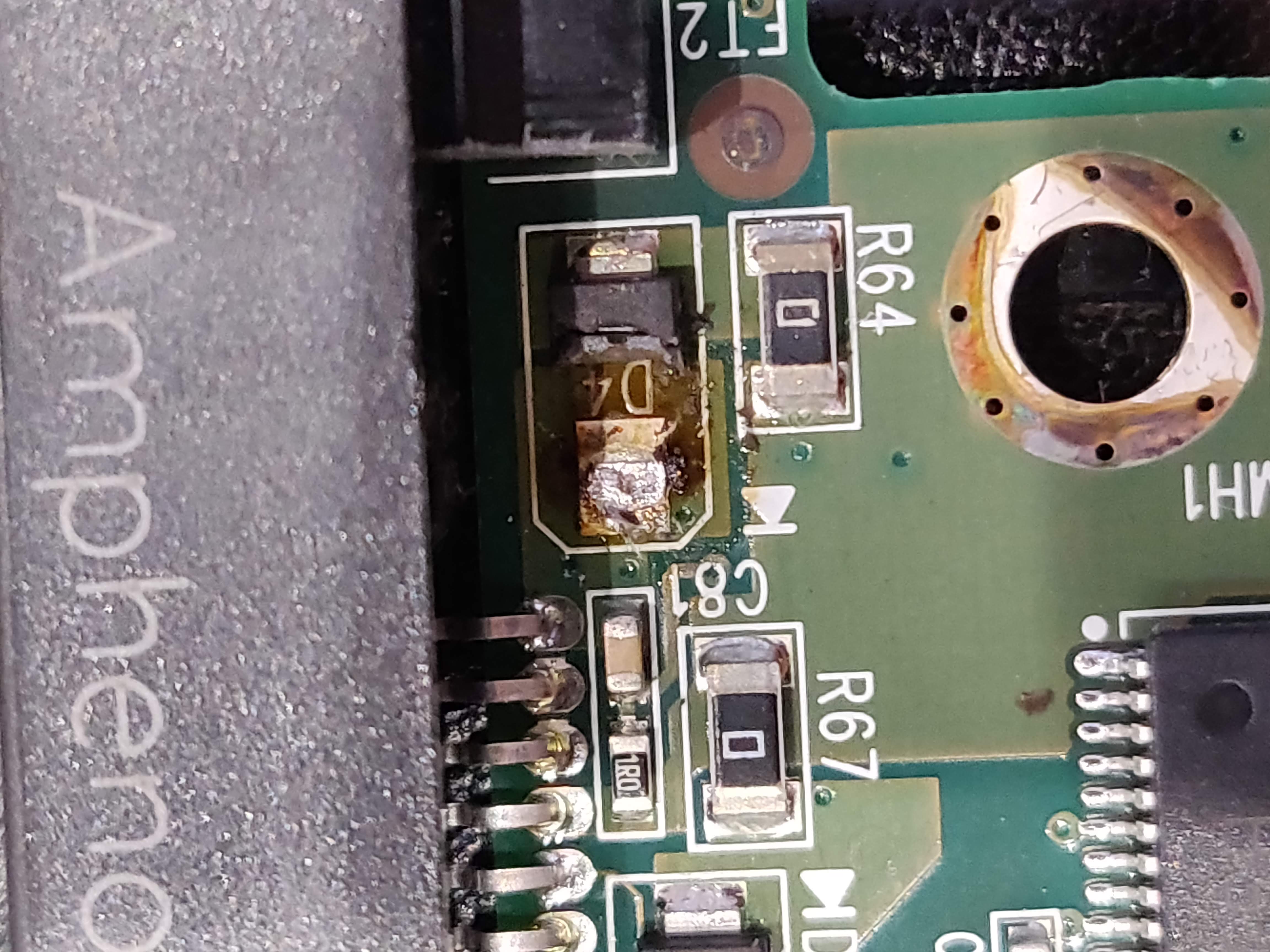

Hello again all, I have removed the TVS diode off the board using a pair of tweezers and a soldering iron. Prior to this, my multimeter was detecting a short on the TVS, which it is now not doing. What is the next step, should I connect the PCB back to the Disk or should I power on the PCB standalone to see if anything "fries"?
I watched Steve's video on removing the TVS but his multimeter had different settings to mine, so I just used the setting that makes the multimeter beep if there is a complete circuit.
It may be worth noting that before posting here, I connected Disk 1 to a computer and now that computer will not boot, but that isn't the point.
If a test of the PCB is needed, can you show me what pins I will need to test with the multimeter? This will be a bit harder to do since the only way I can power up the PCB is using a 3.5 HDD dock and the PCB will be halfway in the dock, see below:
If a test is not needed, then is it safe to just pop the PCB back on Disk 1 and plug it in?
See below the picture of the TVS after it was removed:
The insides of PSU probably look like the insides of the NAS.
Check the diode pads for resistance to ground the right hand side should be very low the left side should be considerably higher. If both are low you have other problems.
If everything is ok put just the pcb in your dock and power it up, if you kill the 15 quid dock no real loss. If the dock powers up and there's no smoke reattach the pcb to the drive and try powering the drive. Clicking or scratching power off immediately.

After snipping off the TVS and testing, we got some good results. I connected the PCB back up to the drive, popped it in the dock, and... It works! :-D
