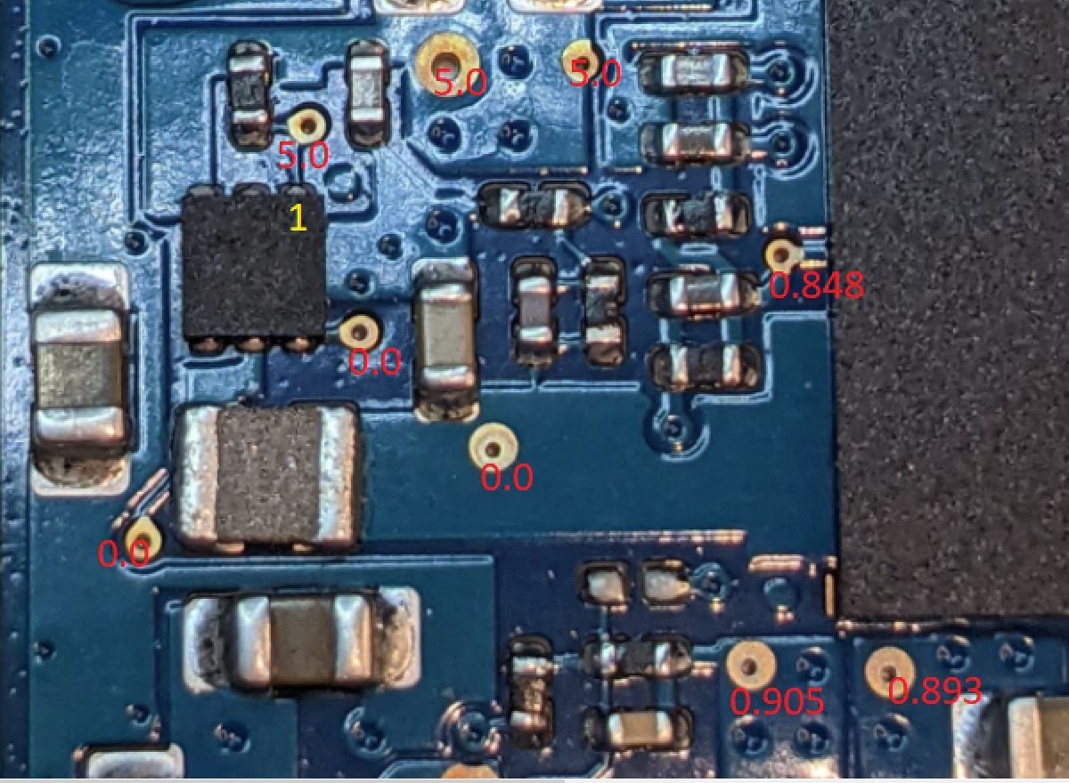

Check the enable pin (pin #1). If it is low, then the IC is not being switched on.
LX7188, Microsemi, 1.4MHz, 1A Synchronous Buck Converter, 2.5V - 5.5Vin, marking 7188, UDFN 2x2-6L:
https://www.microsemi.com/document-portal/doc_download/132768-lx7188-datasheet
Pin1 has 5V.
 Post subject: Re: ST500LX012 - Ultra Mobile SSHD - Short on PCB
PostPosted: September 24th, 2021, 5:38
Posts: 4854
yeah, that's something, that inductor (large one) should have 3.3V.
you can try feeding it from a lab supply (the right side of the inductor...
Check if it is shorted to gnd, if so, remove the large inductor and check again. If it is not shorted, try feeding it with 3.3V. You might need a switching transistor to apply it in the right sequence, but it is probably sufficient to turn it on first.

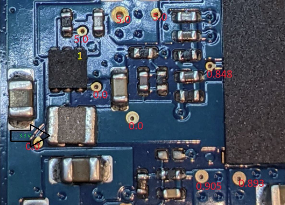

Thanks.
PostPosted: September 24th, 2021, 5:43
Posts: 4854
yes, that one.

i suspect that buck converter is gone, so if everything else is working, the drive can be bootstrapped by feeding it the missing suppy voltage.

Instead of a 3.3V lab supply, find an older SATA power cable with 3.3V, 5V and 12V. Then run a wire from a 3.3V SATA pin to the inductor, after removing the IC or the inductor.

ICBW, but I think I see a dimple or discolouration between pins 2 and 3. By the way, these DC-DC converters usually have a low input margin, eg 5.5V. The absolute maximum is often 7V.

when i said 'That one' a few posts above, i meant 'That inductor' but you need to feed the 3.3V to the other side, after removing it (or the IC, as Franc said)
