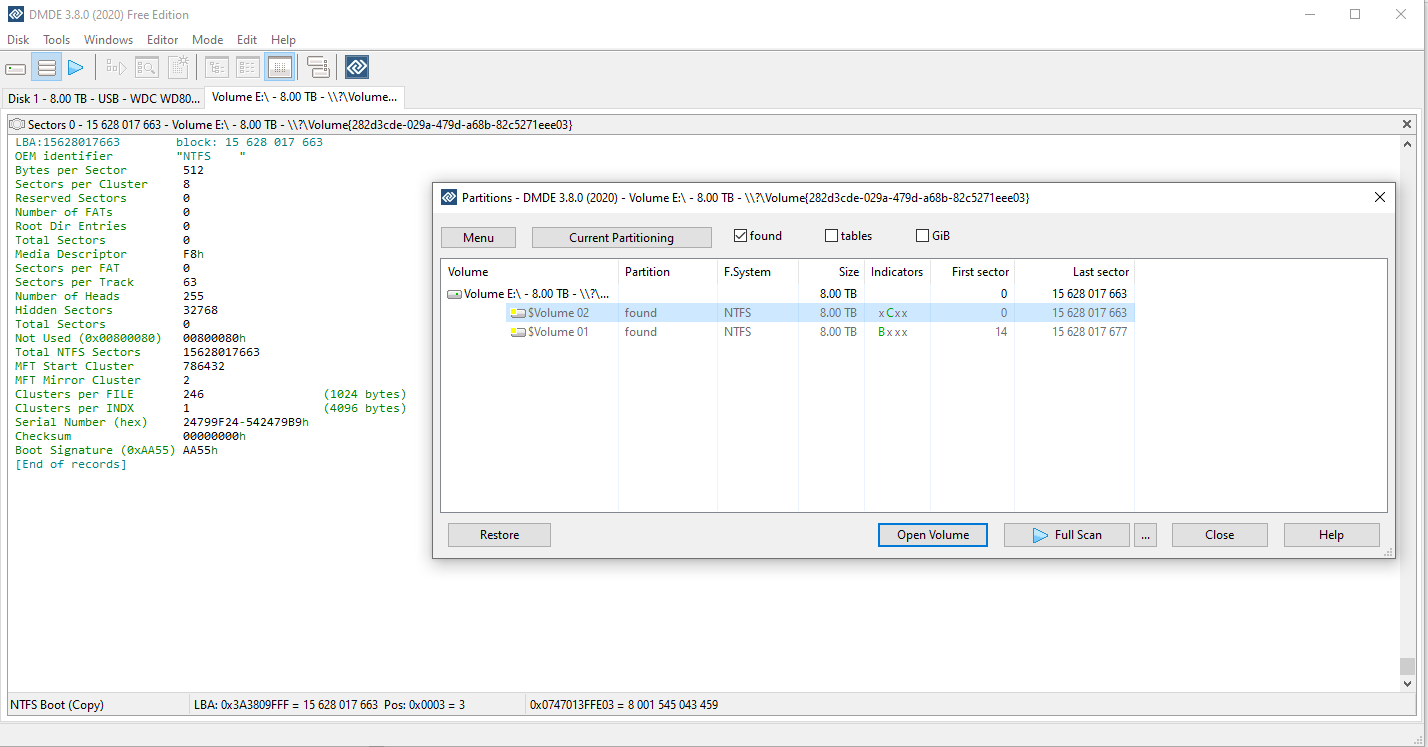

ok. This is getting promising:
I opened the volume. Had a scan run for a few minutes.
It found some jpegs, docx and .mpg. I previewed several and saved a few from different filetypes to disk (to a location outside this disk of course). The files are randomly numbered/named, but the contents appears to be correct. I could open the docx, the .jpg and .mpg properly.
File contents wise this looks promising based on a short scan. However, any thoughts on how the filename corruption can be restored?

Huh? Why? I am just reasoning my way through this actually. My idea is, logical volume then I assume Drive Cryptor is active as it works at volume level as far as I can tell. If we scan outside that we're only seeing encrypted data.
Thus far DMDE did not detect MFT. Either boot sector is off and does not point to correct location, or it does and MFT itself is hosed, at least start of it.
You are right, we'd need full scan to see if it can be found. Once you find that indeed we have filenames and dates etc.. It may be other tools are quicker or better. ZAR perhaps or GetDataBack. For some reason I am always under the impression these make most effort to reassemble NTFS file systems with only partial MFT. It's just that DMDE price is so hard to beat....
I had another look at GetDataBack after the above. I could previously not see the logical disk so I skipped it, but it turns out the settings has the option "Show logical disk" and I could now scan the logical disk.
I had GetDataBack do a first scan and it found a lot of files including proper filenames. Level 2 scan presented some 1.8TB of data with proper filenames. So I got a license, recovered some files which worked. I also had a few files that were not properly copied.
I now have the level 4 scan running. Will take about a day. At 2% now. Found some 7300 files, 24687 MFT entries ($MFT) and 1 index allocs(allocated?). Will see in a day how this will turns out and how much of this is actually recoverable.
Assuming a partial recovery, I can always see if I can find additional files via a raw recovery... I'll first see what the results are after this scan....

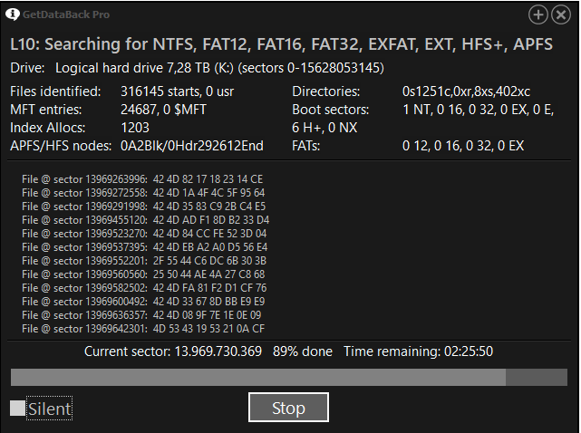

GDB is at 90%. Found way more files then expected. Perhaps more file changes due to syncing over time if I'd guess.
MFT entries were listed at 24687 right at the beginning. I tried to do some more homework on the topic between tasks. But is the number of MFT entries the number of files that were on the disk prio to corruption? Is that correct?
I did some Googling on the "Index Allocs" number, but so far I couldn't find wether for instance a higher number indicates more chances of recovery for instance.
Any thoughts on what I should expect or be aware of after the completion of this scan this evening?
Approximately, yes. Theoretically one file can occupy multiple entries, can point to an index but that's the general amount of files. Is that what you expect or did you expect more?
File starts can also be false positives. So in screenshot it seems it's detecting BMP and PDF files but at this point you can't tell if they're actual files.

Scan has completed btw. Next it moved on to creating a recovery tree.
On the questions of the nr of files:
Based on the backup I'd expect around 16000 files at least. Thing is that I can't say for sure if I did or didn't copy a dev backup folder which could be a few thousand files. So ~24k files could be correct.

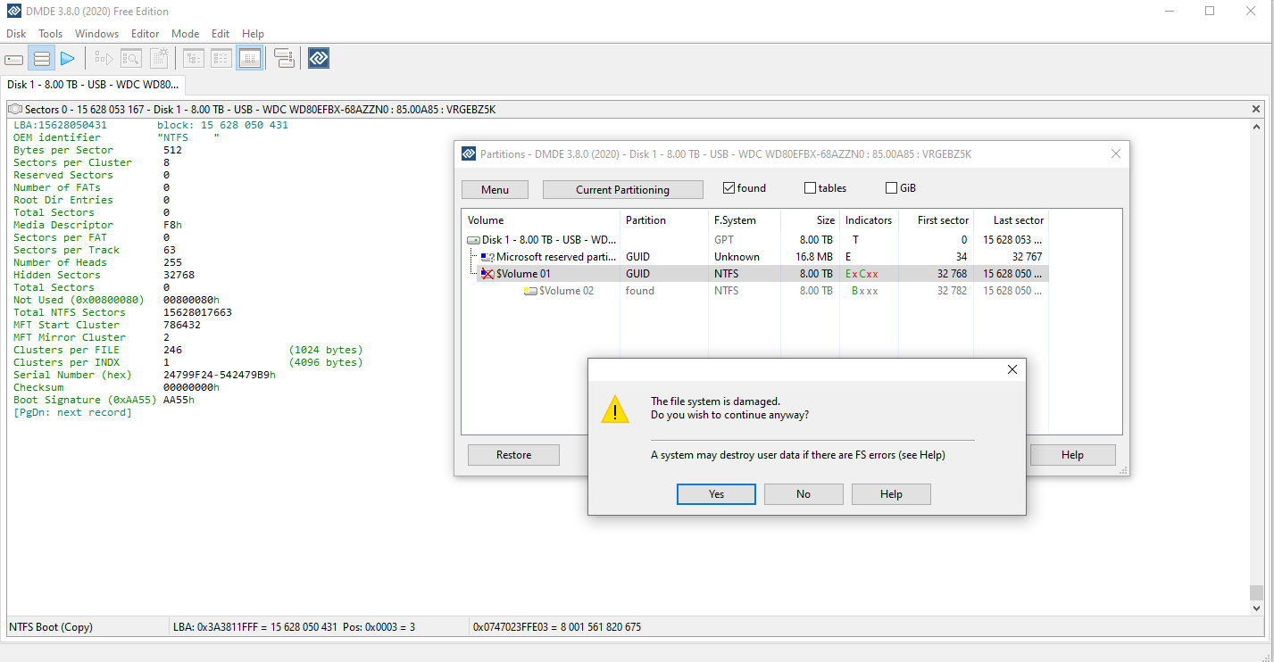

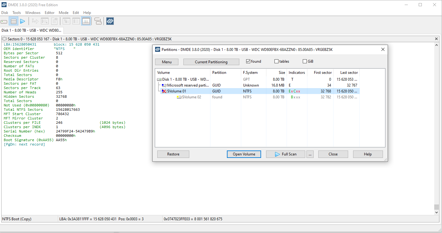

Good news: The full scan by DMDE revelad 25175 files including filenames. First check shows that the (at least some) files that GetDataBack was not seeing, I can recover now, although with their original. Good enough. Think that covers my recovery needs.
More good news: I think I've determined the root cause... leading to the bad news:
The destination disk that I recovered all files to also got corrupted!!
With more Googling on various terms: I came across similar issues that a user reported. This was caused by (known) USB issues with certain AMD chipsets giving short usb disconnections. I have the exact same cpu/mobo. AMD 5800x with an Asus ROG Strix X570-E gaming.
When I built my new PC this spring, out of habit I had applied the latest patch at that moment. That patch from april(?) supposedly included a patch for the usb issues. But at the time I did not really pay attention/dove into this issue.
My previous PC was Intel based.
Also, with the usb3 bay I never had a problem with my Intel PC and that bay is in in regular use being connected to another pc. So I dare to say the usb3 bay is not the issue.
But today also my recovery destination disk all of a sudden presented the corruption error when accessing one specific folder, but I could still open files from other folders on that disk(?!). This happened after a few hours of idle time (ports are configured to not go in sleep btw)
I think (the assumption I'm going by now based on what I read) is that possibly (short) usb disconnections while an external disk is connected, can screw up the disk MFT/GPT as this can happen during copy/file manipulation actions. Sounds plausible, right?
To be safe, I did not encrypt the recovery destination disk. This disk was initialized in Win Disk manager as GPT and formatted. Again 1 single partition spanning the 8TB disk.
I tried to eject the disk, but Windows refused.
I shutdown the PC. Later (after reading the above on AMD/USB) I connected the bay with disk to my other machine. And, as unfortunately expected, I was asked to format the disk (which I did not do of course)
Next, I opened the disk with DMDE. Perhaps to due being initialized/formatted in Windows, DMDE actually seems to find and present partitions for recovery. I've included screens from DMDE for this disk. Should I indeed choose to restore Volume2? And should I do that from the Physical disk view, or from the Logical disk view? Any advice/experience?
So to be clear: I'm talking about the disk that I used to recover to. Disk1 that started this topic, and Clone1 of disk Disk1 are still untouched. So I could repeat the GDB procedure that was succesfull. But if I can restore the recovery disk that would spare me another 2 days of scanning and copying again. I had saved the recovery log btw in GDB.
I'll be applying more recent bios updates asap that came available in the last few months. And NO, I won't connect an external harddisk again via usb on my AMD machine untill this is sorted. I read lot's of users still having these issues even after the most recent bios updates. Perhaps I'll have a look at a PCI USB card just to skip the onboard for external disks. But that's for later...

Lardman wrote:
Your post illustrated a very valuable point. USB has no place in DR
Well, basically I'd agree. In this case it actually was a consious choice as I quickly noticed it was hard to tell the disk apart, and I wanted to avoid a mix up between the source/clone (on sata) and the disk on usb where the to-be-recoved files would go.
Lardman wrote:
I'm not convinced that disconnects are the entire cause but certainly wouldn't help.
I agree. While in this case the given errors basically match situations of uncontrolled disconnects (during writing the disk) combined with to "what has changed from a years of working situation" combined with "known issues that were introduced after the working situation". Still.. not 100% indeed.
Lardman wrote:
Without the encryption you should be able to work with the physical disk directly, do you have a right click option to undelete volume 1, start there. You did save the scan results from GDB onto another disk didn't you? If so, worst case you just extract the files again - lost time but only half of it.
All recovery saves (files/logs) where of course saved to other disks;-)

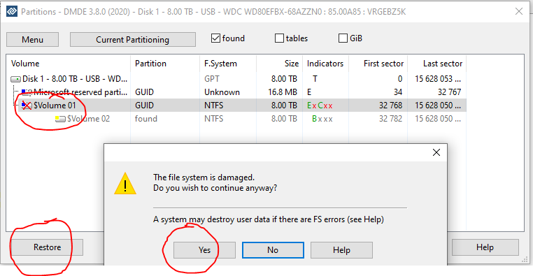

So just to be sure: Physical Disk -> select Volume01 -> Restore -> then Yes in the attached dialog. Correct?
To be honest I'm almost tempted to tell you to run chkdsk .... it's only the recovery destination anyway. If it dumps a few files off the mft but gets the rest up and running it might be the easiest (quickest) option. Not sure - depends on the damage I suppose.
