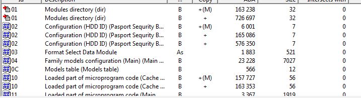

fzabkar, hello sir,
I have one palmer drive when i start with pc300 it shows
Techno mode key
Techno mode key......................... : Ok
RAM:
HDD Info reading........................ : Ok
Heads number............................ : 2
Cyl Count............................... : 512
ROM:
Read ROM................................ : Ok
ROM Data size........................... : 1024 Kb
Flash ROM dir reading................... : Ok (Active)
Flash ROM dir reading (Ext)............. : Ok
Modules directory address............... : 163 238
SA regions address...................... : by default
Module 02 access........................ : Granted
SA SPT.................................. : 0
ROM Modules:
ROM version............................. : 02.1AP
ROM F/W version......................... : Module ID 4F reading error Device Error Detected: "FM ERR HEADER II SIGNATURE INVALID"
Overlay F/W version..................... : 02.1AP
Servo F/W version....................... : 01.3C
Head Map Reading Error.................. : Module ID 0A reading error Device Error Detected: "FM ERR HEADER II SIGNATURE INVALID"
Relocations............................. : 0 (0)
i have tried 2 different rorm with same rom rev but still unable to get id. I think its problem with currupt rom .Can you pls help about this.I have done modules search within sa and found modules also module dir.there it shows 01 mod directory +m 163238 and with+ sign 726697. i have tried change dir address in sa region editor.but still id or dir not access.than i have tried mod 109 recover from sa image n recover 4f and 0a from rom image module 109.but still nothing happen.no dir accress.So pls look in to matter if possible.
log.log
(2.2 KiB) Downloaded 297 times

There are a number of very similar posts on the pc3K forum, although having numerous talents I don't think fzabkar is clairvoyant and will need the rom to check it :roll:
