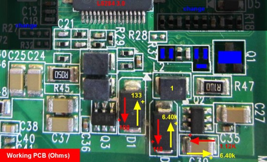

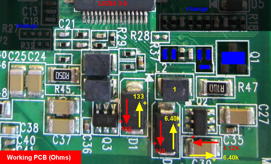

You cannot right test those diodes without removing them off the PCB, you are currently measuring others components resistance present in the circuit around.
I have tried on my PCB, I attach an image that will give you an idea, my multimeter give some junk sometime so pardon me if not exactly right measured, but I have try to no doing error by confirming with the R47 value. Also some values are moving a little. And also my PCB is not identical to your, but this zone yes is visually identical, I have grayed all that change.
I think next, you have no other choice than firstly replace R47 and re-measure those -5V/+5V said by fzabkar, and buy more than one R47 for in case it re-burn just after... I dont know if there is really a culprit about this R47 burning...
Good luck!

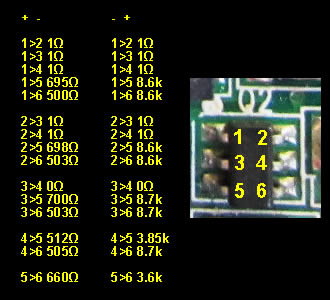

Finally I don't know exactly if this D2 cannot be measured on circuit, fzabkar will tell you.
fzabkar say that Q2 can be the culprit of the burned R47.
So I have try to measure it, and wow my cheap multimeter seems doing lot of bullshit, recalibrating it completely change the result and do not correspond to the previous values on lower caliber...
For example, I have retry the D2 to see if I can get your 80k, and maybe yes with the 2000k caliber:
2000k -> 008
200k -> 13.7
20k -> 6.40
2000 -
200 -
So take my measure with pencil...
It seems only my measure inferior to 200 ohms are accurate.
I post my last screen anyway, for you try seeing if your Q2 is damaged.

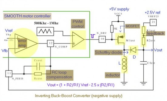

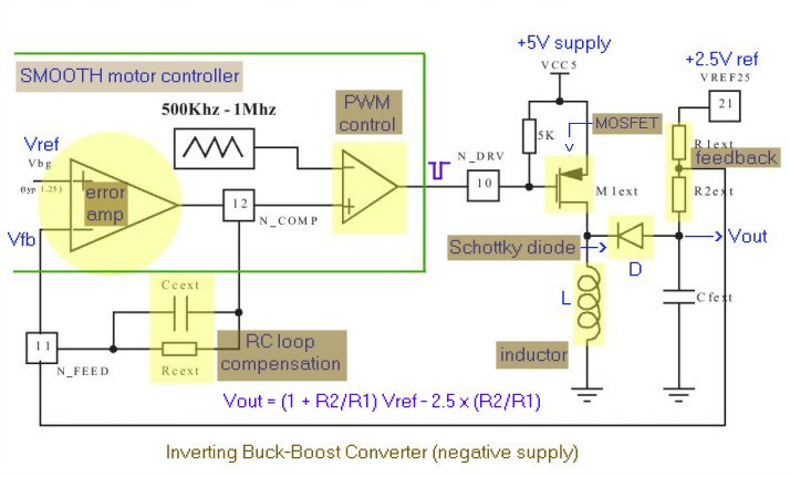

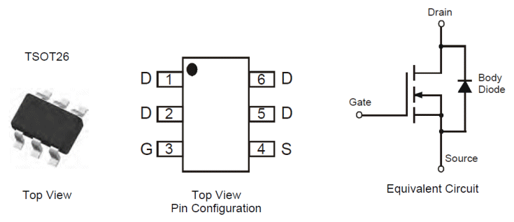

The negative supply has the following topology:
The SMOOTH motor controller sends pulses to the MOSFET causing it be switched on and off at 1MHz frequencies. Energy is transferred to the inductor when the MOSFET is on. When the MOSFET is switched off, the inductor's energy is transferred to the capacitor via the diode. The SMOOTH chip senses Vout and varies the width of the pulses to maintain Vout at the desired level. This is called Pulse Width Modulation (PWM).
WD's circuit has an additional resistance in the ground leg of the inductor. I'm not sure why this is so, but it could be a current sense resistor. Since this resistor is open circuit, and because it shows visible burn marks, it would appear that too much current has passed through the inductor. An inductor has a very low DC resistance (less than 1 ohm), but its impedance at 1MHz frequencies would be high. If the SMOOTH IC were to fail such that its PWM controller were always switched on, this would send a DC current into the inductor, and this could then burn out the resistor. Similarly, if the MOSFET were to fail with a Drain-to-Source short circuit, this would also burn out the resistor. A third failure mode could involve shorted turns in the inductor (something which cannot be detected via a resistance measurement).

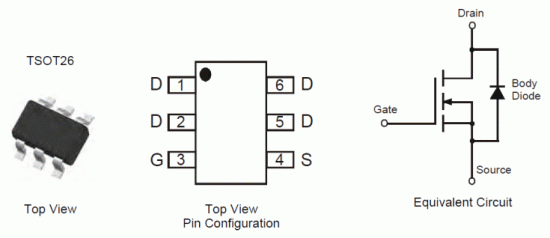

The MOSFET pinout would be something like this:

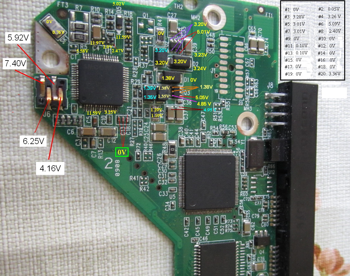

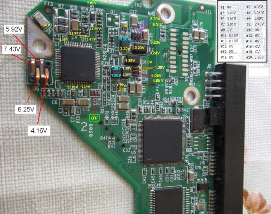

Now I have measured quite a lot of voltages on the PCB (above all, in the problematic area).
(The black probe in a screw hole and the red probe on the element to be measured)
Next, there is a photo where have I marked the different voltages I have measured.
They are in picture #9.
I have noticed the following:
For C13 and C18. I have measured 0V in both ends of the capacitors. It is strange.
On U1, the voltages were fastly changing all the time and I have measured this:
Sorted from left to right:
The one to the left: 11.53V,
Next to the right: it varies from 2.0V to 1.62V
Next to the right: it varies from 2.47V to 1.10V
Please take a look at picture #9
Thank you
File comment: I have marked quite a lot of voltages in the photo of the PCB (problematic area).
Picture #9 - Voltages in the PCB (problematic zone).jpg [ 458.88 KiB | Viewed 17767 times ]

What about D2 fzabkar? For when we try measure the D2 resistance to see if it is shorted on two ways.
If I read right L7250_Negative_Regulator.jpg, and D2 is the Schottky diode "D", so I conclude we can measure it on circuit. Yes?
Oops, or does the signal make the turn through the bottom line and through the SMOOTH?
Oops, or does the MOSFET Q2 is maybe blocking the signal from making the turn? (I do not know this MOSFET logo too, sounds to me that it will maybe pass by the 5k resistance way)
I do not understand those quad too, like "N_FEED", and not well familiar with the triangles that I understand as magic box that contain many electronics components.
Also if you have a good link of documentations about strange logos, like those others than the basics R C D T.

Yes, you should be able to measure D2 in-circuit with your multimeter. It should test like a Schottky diode with a low forward voltage drop.
"N_FEED" is the feedback voltage that enables the SMOOTH IC to sense and control Vout. If the feedback voltage is too low, then the SMOOTH IC widens the pulse. This sends more energy into the inductor. Conversely, if the feedback voltage is too high, then the SMOOTH IC shortens the pulse.
This is the datasheet for the L7250 SMOOTH chip:
http://pdf.datasheetcatalog.com/datasheet/SGSThomsonMicroelectronics/mXyuswx.pdf
Current motor controllers have some similarities to this chip, but they also have additional features.
As for the voltage measurements, I don't see any problems other than the negative preamp supply.

So as I understand about D2, the current sent by the the multimeter is finally well doing the turn (loop, or maybe I must say detour), as it is blocked by the diode in one way, and so it pass through the SMOOTH and all others, and that's why the resistance grow to a big 80k (or infinite if it cannot make the turn). I'm right?
If D2 was short, the current sent by the the multimeter will take the most short road and just pass through the diode and so get the same resistance in the two ways, about 100 ohm. I'm right?
If I'm previously right, how can you know D1 is not shorted without unsoldering it, where the situation is ambiguous because the detour it done seems having a low resistance and is about identical as if it was shorted?

When you measure the resistance of D1, the meter current flows from the cathode of D1, through the two adjacent inductors, then R45, MCU core, MCU ground, and then returns via the anode of D1 (which is grounded). So you are actually measuring the resistance of all these components in series. R45 is less than 1 ohm, as are the two inductors, so the bulk of the resistance is due to the MCU core, which is around 90 ohms.

Yes I get that, all components resistances are added.
What I say is if a shorted D1 give also 90 ohms?

A shorted component would read 0 ohms. A "leaky" diode might read 90 ohms in both directions.

Okay! it's finally for I right understand when we can be sure 100% of the diode state without unsoldering it.
It's also to understand for in another situation, like imagine if the "detour" measure 2 ohm instead 90.
