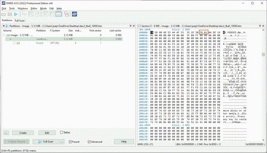

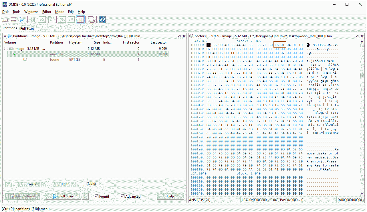

FWIW NTFS BS in UFS screenshot says sector size 512. The boot sector @ 2048 actually says 504. I assume this value is written at time of file system creation (format).
Where are you seeing this? I downloaded those 10,000 sectors again and I'm still seeing 512 bytes per sector at LBA 2048. :-????
00100000  EB 58 90 4D 53 44 4F 53 35 2E 30 00 02 04 DE 19  ëX.MSDOS5.0...Þ.
00100010  02 00 00 00 00 F8 00 00 3F 00 FF 00 00 08 00 00  .....ø..?.ÿ.....
00100020  00 40 06 00 11 03 00 00 00 00 00 00 02 00 00 00  .@..............
00100030  01 00 06 00 00 00 00 00 00 00 00 00 00 00 00 00  ................
00100040  80 01 29 2B 61 F5 26 4E 4F 20 4E 41 4D 45 20 20  €.)+aõ&NO NAME
00100050  20 20 46 41 54 33 32 20 20 20 33 C9 8E D1 BC F4    FAT32   3ɎѼô
Even more confusing is that LBA 1 in the OP's first posting is correctly aligned, while in the subsequent 10,000 sector dump it is misaligned.
https://forum.hddguru.com/download/file.php?id=22848&mode=view (correctly aligned)
Incorrectly aligned ...
000001F0  00 00 00 00 00 00 55 AA 45 46 49 20 50 41 52 54  ......UªEFI PART
 Post subject: Re: Severe file system corruption 300 GB SAS case
PostPosted: July 24th, 2022, 20:03
Joined: May 13th, 2019, 7:50
Posts: 1213
Location: Nederland
Oh you're right! DOH! I edited it yesterday or some, way past bed-time. And today when I opened it forgot about it. Sorry, false alert. :lol:
