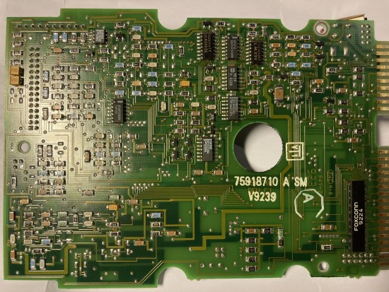

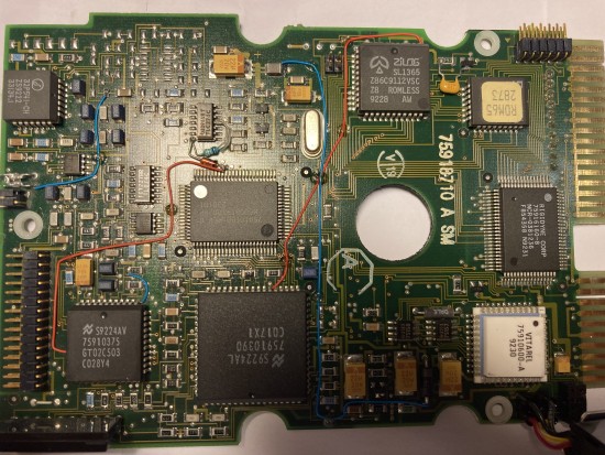

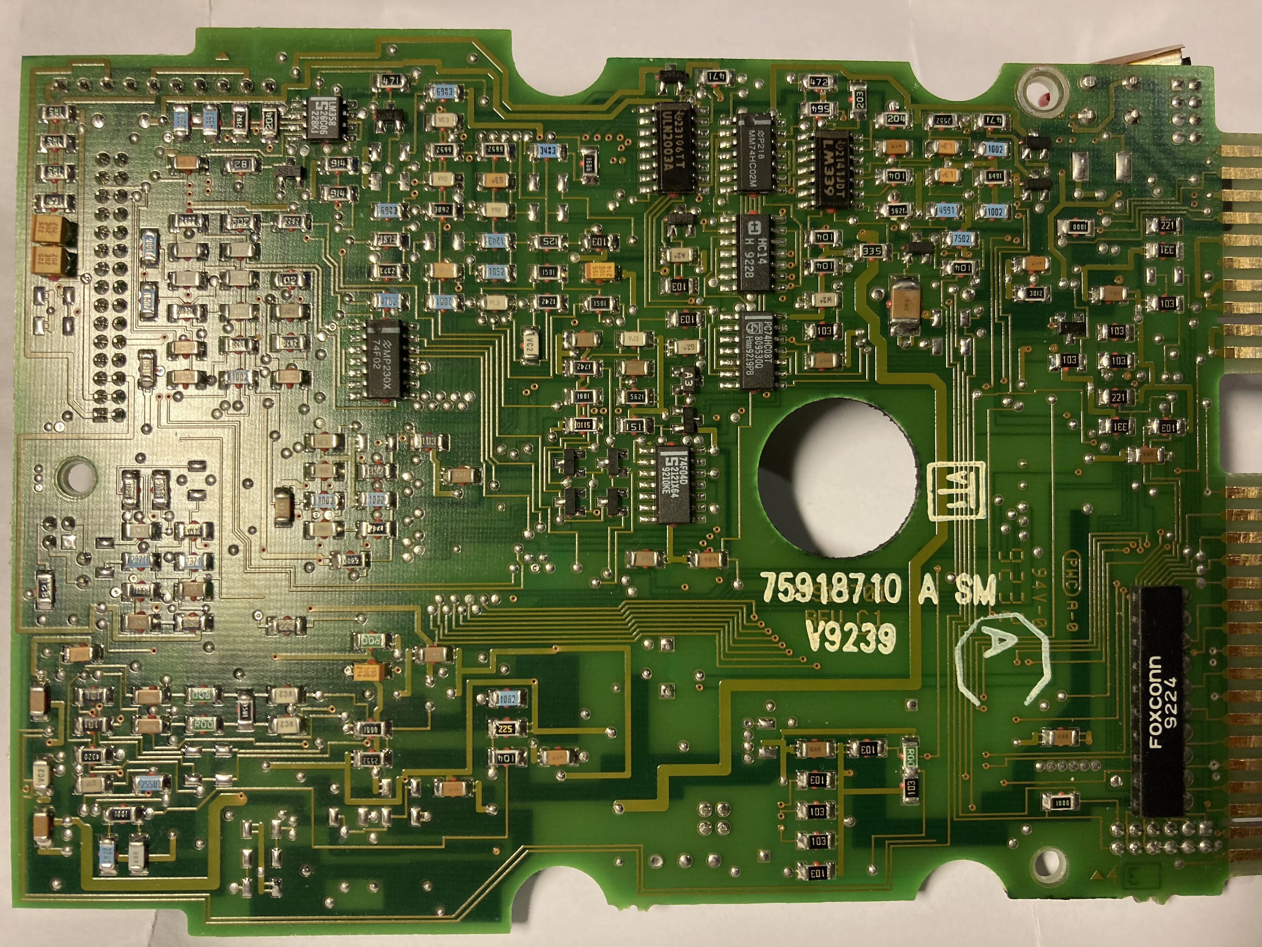

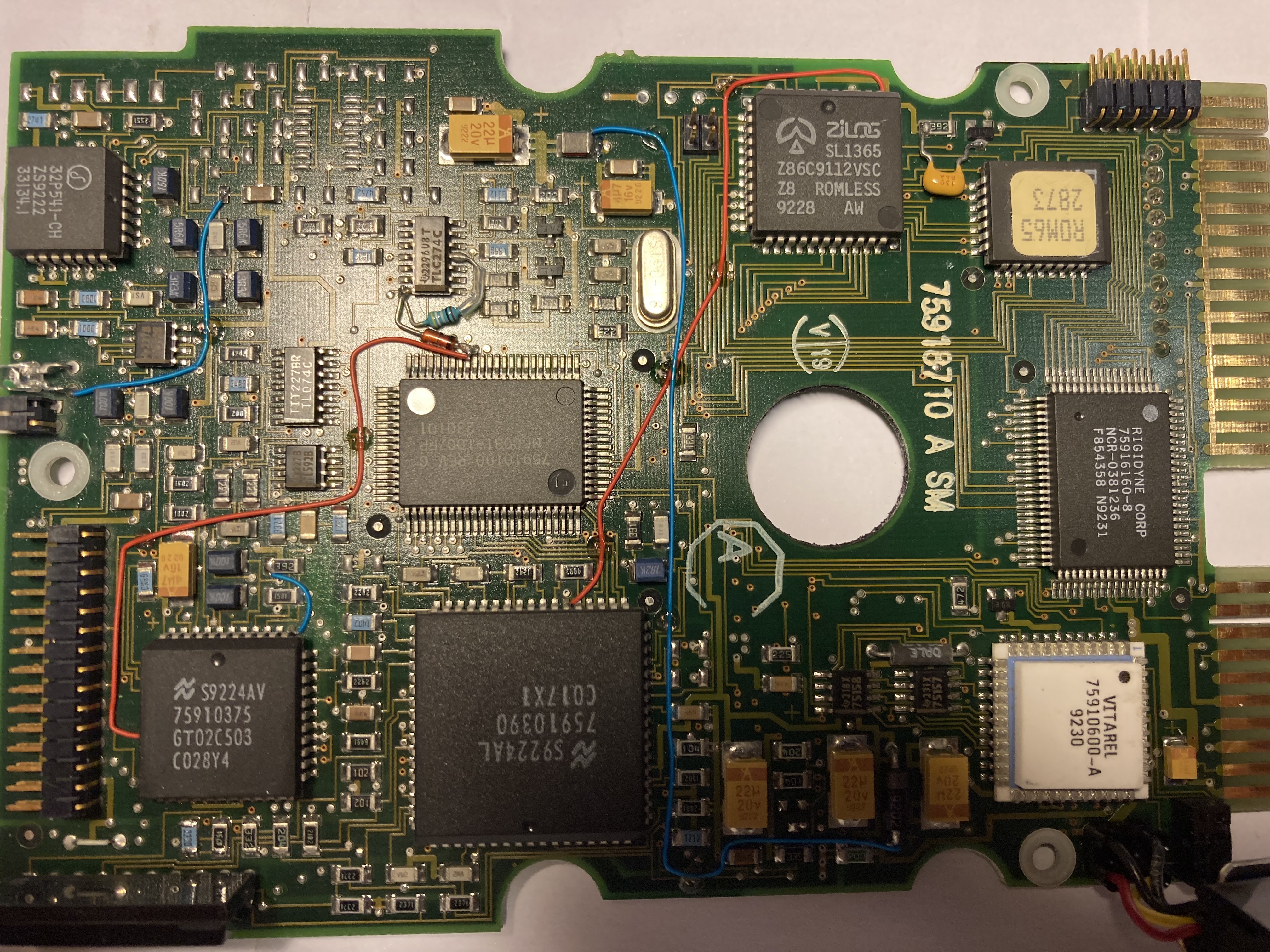

Thanks, I really appreciate your help with this! I'll take a photo and upload it then!

So, here are a couple of photos... since I have a removed PCB, I could include both sides of it. Pretty good quality with that iPhone camera, by the way. :-D
I can find only one IC with 16 pins however, and that doesn't seem to be the BCD-to-decimal decoder...? c".)
 Post subject: Re: Weird Seagate MFM drive
PostPosted: August 21st, 2022, 12:50
Posts: 17335
Earlier MFM drives used discrete logic chips. This model uses a microcontroller, so the HS bits would be handled by one of the unobtanium ICs. I don't know where to go from here. :-(
