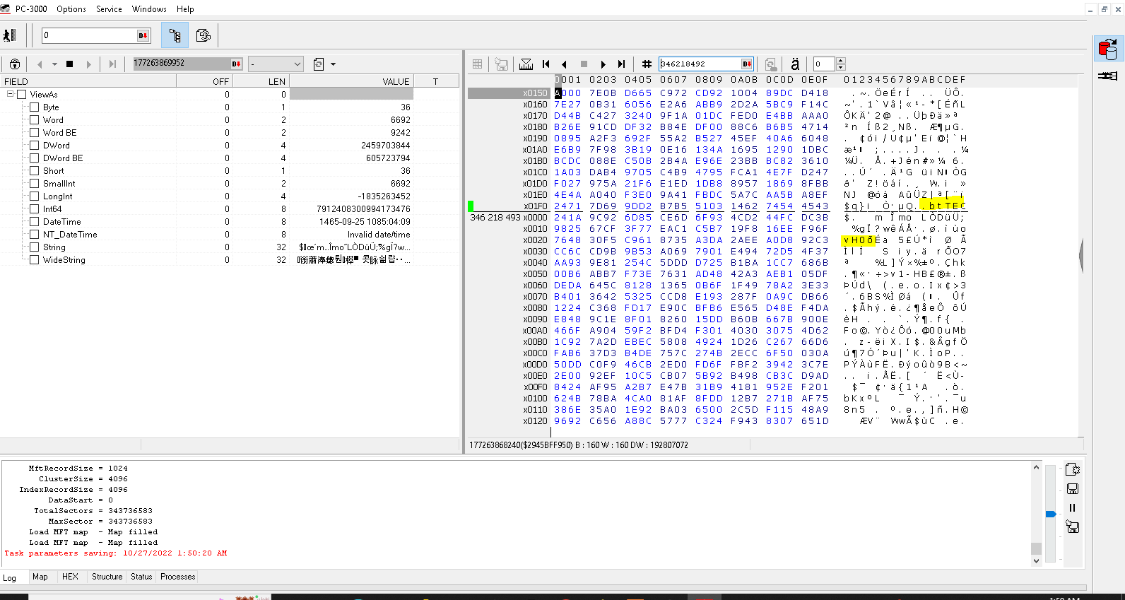

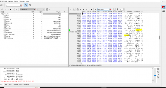

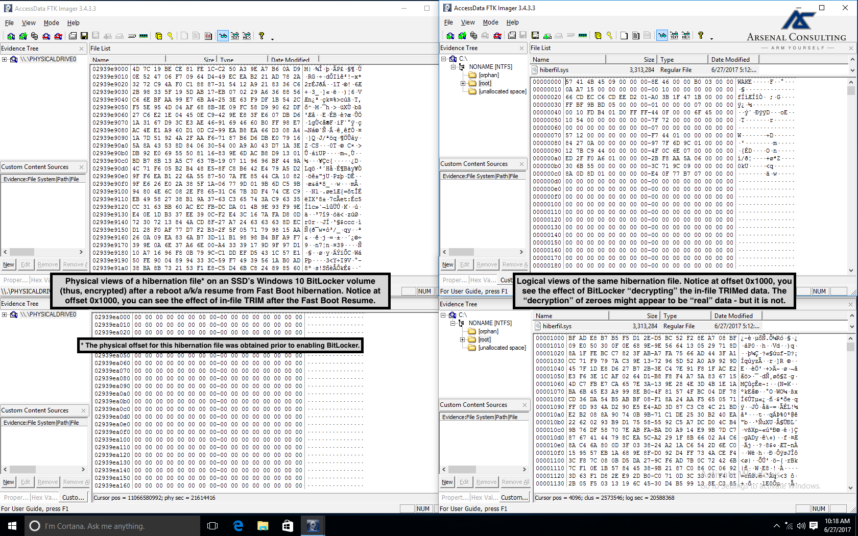

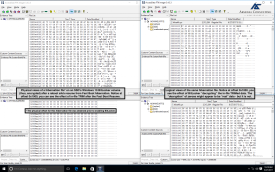

 Post subject: Re: Another Bitlocker woos
PostPosted: October 24th, 2022, 0:08
Posts: 548
Location: brisbane
I have run "eleconsoft forensic disk decryptor" on hibernet.sys file to extract bitlocker keys but it did not find anything.
I was keen to know what are actual keys in "No key" type of protectors.
Here is intresting article on Bilocker and windows hibernet file
https://arsenalrecon.com/insights/the-i ... -bitlocker

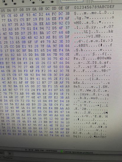

PostPosted: October 24th, 2022, 14:05
Posts: 1091
Location: Angel Data Recovery

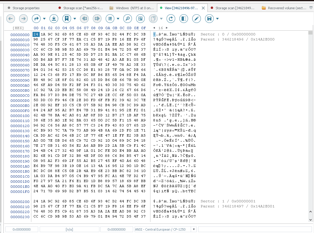

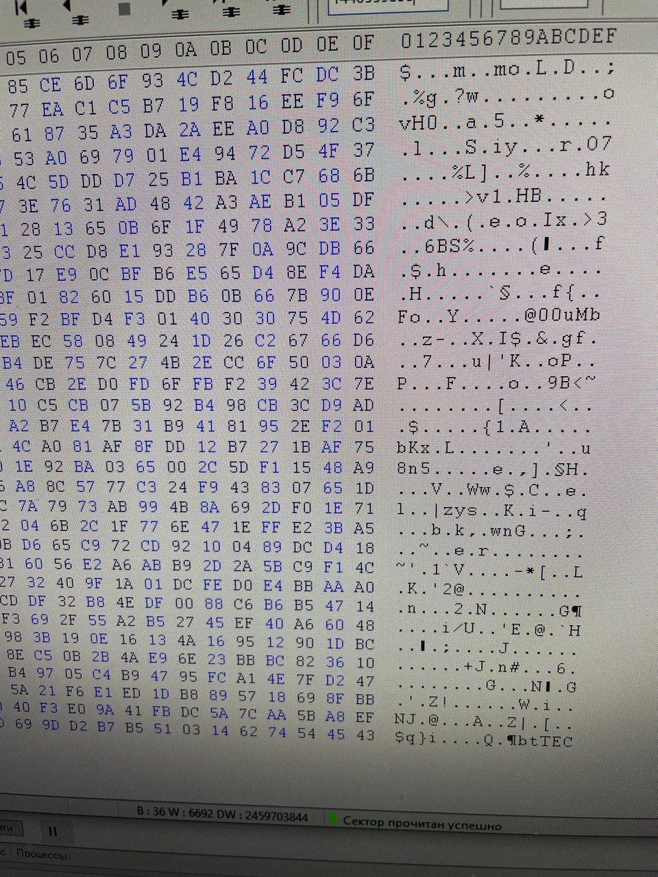

Can you check/search for these kind of sectors somewhere in the beginning of 2nd partition ?
Angel Data Recovery

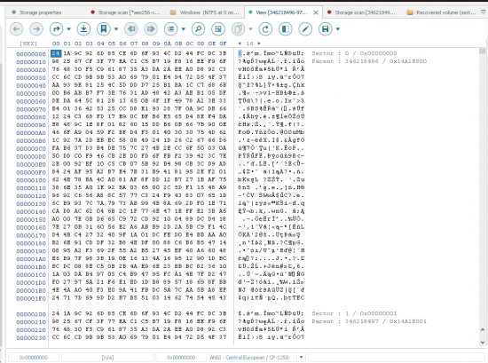

PostPosted: October 27th, 2022, 6:23
Posts: 548
Location: brisbane
Thanks DR-Kiev
Yes eaxctly same hex pattern is been observed starting from sector 346218496 (300 GB partition start)
I have made video of these sectors.
Unfortunately patient disk is returned to customer for warranty replacement so I can't clone it again using SEDU scripts .
Video --
https://www.youtube.com/watch?v=qZfma6gpD8A
PostPosted: October 27th, 2022, 15:10
Posts: 1091
terminator2 wrote:
Thanks DR-Kiev
Video --
Try to return it, otherwise - game over with decryption.
You only need to read again few kb from that drive.

Yes Thanks DR-Kiev.
Fortunately disk is still with customer and he has agreed to resend again. I will completely clone disk again and I am hopeful to give justice to this case.
Thank you so much all credit for this valuable learning and success goes to you. :good: :-D

Wuuf. Just create map based on pattern of bTec sectors and read only them . Especially, need beginning of 2nd partition,

Hello Everyone ,
What angel data recovery is trying to explain to you all is as following ....
1 : There is a Feature in PC 3K 7.1X were Acelab has added a additional MAP grep so what if you clone a seagate drive you can see on the fly if Seagate btTEC and sEDU issue is there in reading ,What this problem is that Seagate Rosewood drives instead of returning you the data in the patient drive sector returns a factory data sector that has the signature in which you will find a Signature btTEC and sEDU ,Are you folks getting it into your head now please
2 : So if you replace rosewood heads and you are cloning some weak sections of the drive this drive can return you these factory data filled sectors ,You are thinking you are getting the sectors but the case is you are not ,In the end you will need to make a map of all these sectors and then you need to clear it or change it back to non read and read it again .Due to these sectors the guy is not able to see bitlocked data imho
PS : To Angel Data Recovery ,Can you please explain why these sectors are generated and how we can solve this issue .I had added this facility myself to Ver 6.9 of PC3K UDMA i have but the same ability got destroyed in Ver 7.0 update ,I am on 7.0 Currently so need to add it again .

Fun part is, this was already visible in very first post
