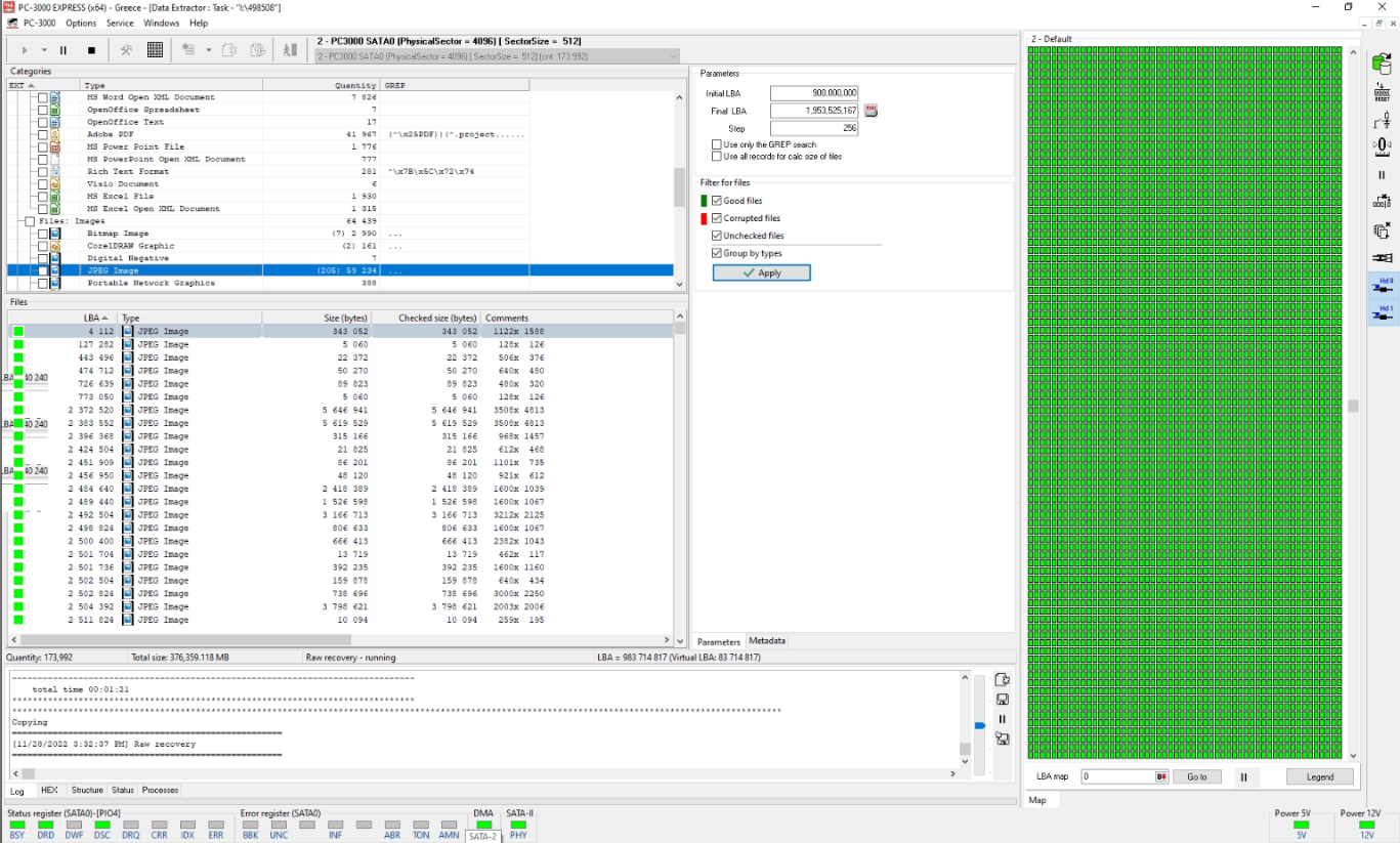

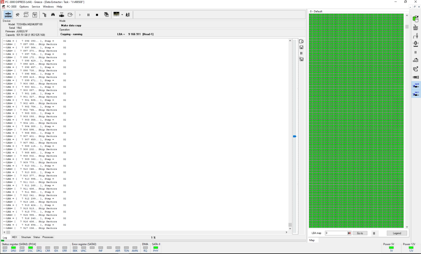

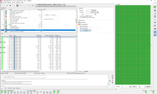

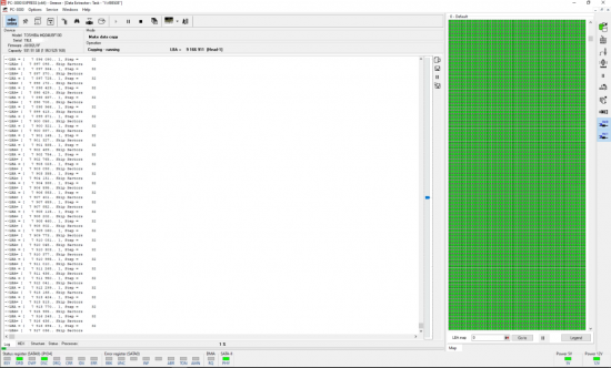

By the way,
:D :mrgreen:
If there weren't for some damaged areas, I'd say 100% of data will be recovered, now about less than 1% will be lost. Or maybe much less than that.
A lot of data inside this drive, actually. More than 900GB.
