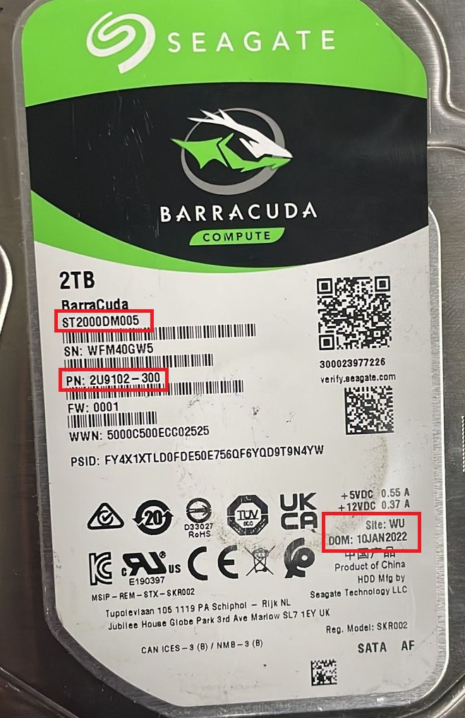

One of my Friend send one 2TB ROM with DOM: JAN22 but Patient is JUL21
PCB: 100870255 Rev. A and QR in PCB: 100870642 E E225556N
ROM of Donor 2TB:
ST2000DM005-2U9102-001-Donor.rar [255.97 KiB]
Downloaded 473 times
 Post subject: Re: Req: ST2000DM005-2U9102 Donor ROM
PostPosted: December 5th, 2022, 10:21
Posts: 4847
it is not the same fw
we need 2 drives from the 'same batch', with same fw ver to find out if processor is involved.

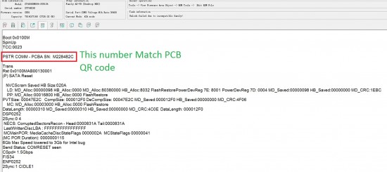

Terminal Output of one ST4000DM004-2U9104 (Family name is Actually D0 not A0)
I never seen this in any seagate models before.
is this family MCU locked?
PostPosted: January 30th, 2023, 13:12
Posts: 3598
Location: Chicago
yes, it is.
PostPosted: January 31st, 2023, 1:05
Posts: 347
Location: india
Doomer wrote:
yes, it is.
got one case with PCB burned (SMOOTH chip).
So only possible is SMOOTH chip change???
PostPosted: January 31st, 2023, 6:43
Posts: 4847
I think that's the best you can do... changing the MCU is more risky, probably easier to change the smooth as well. However, check the surrounding components for shorts, especially the voltage converters and diodes.
