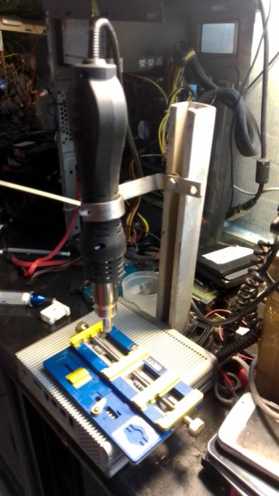

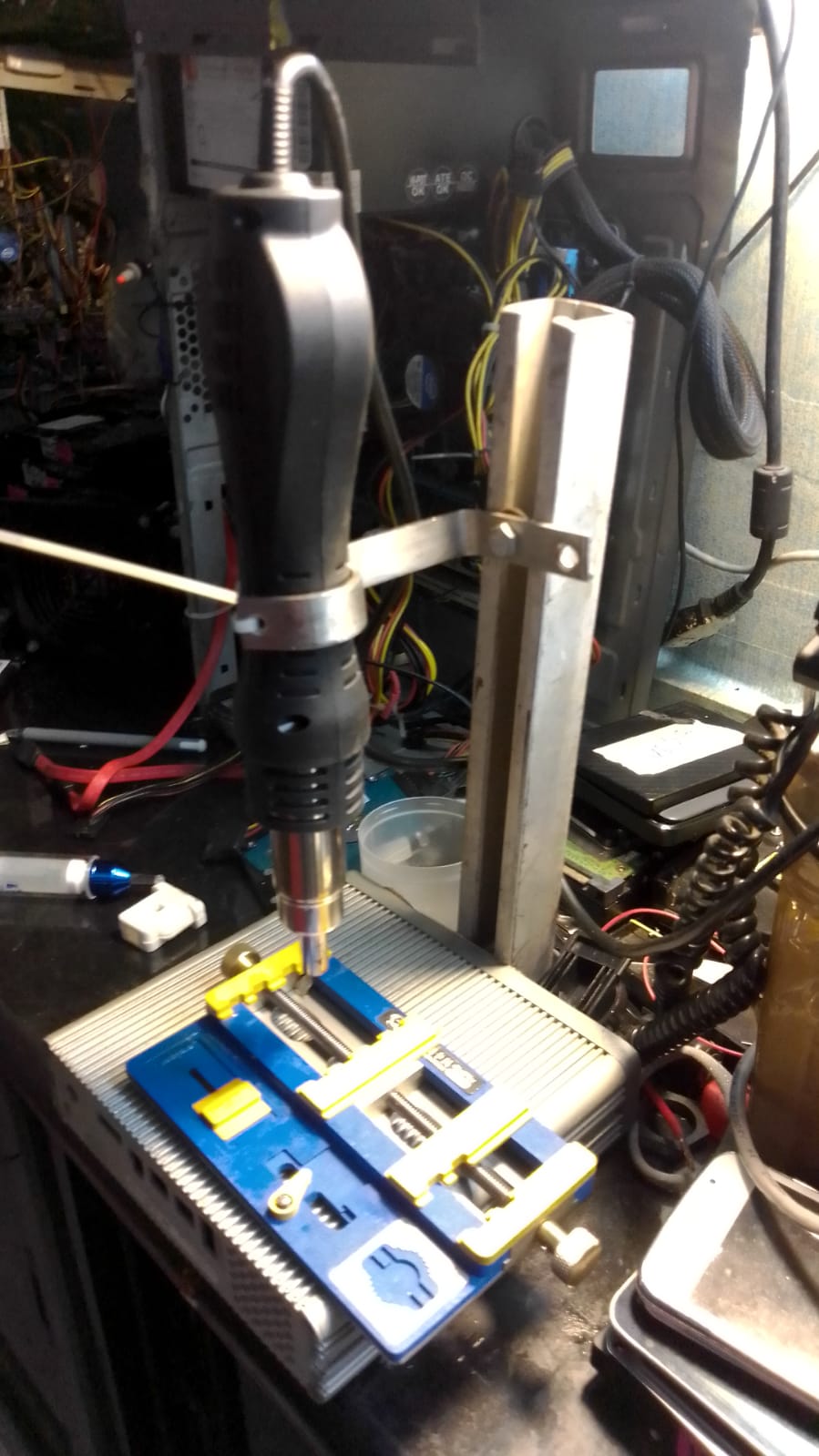

Stencil is a must....however carefully one can achieve similar results.. With my previous 5 successful attempts without rebelling(back in 2018/19), i can say these MCUs are quite nicely built and heat tolerant. The PCBs are not.
Also, one can always reball all the balls with the help of a stand that mounts the hot air gun vertically at 90degrees for uniform distribution of heat with all the balls in place..
