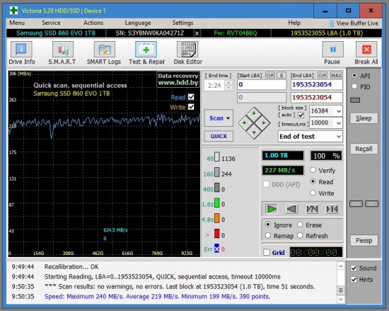

pepe wrote:
BTW, I don't think you meant 8000 seconds.
i did. the full scan took about 40000 seconds and there are 5 equal intervals. of course, it is a rough estimation, could be 9000 as well.
How did you work that out?
Using Victoria, a quick sequential scan of my 1TB SSD at an average speed of 219 MB/s took 51 seconds.
I'm guessing that the OP's run lasted about 400 - 450 seconds, which would mean that the dips are 90 seconds apart. My feeling is that some task is touching the drive at 90 second intervals. The drive's APM setting would be less than this.
