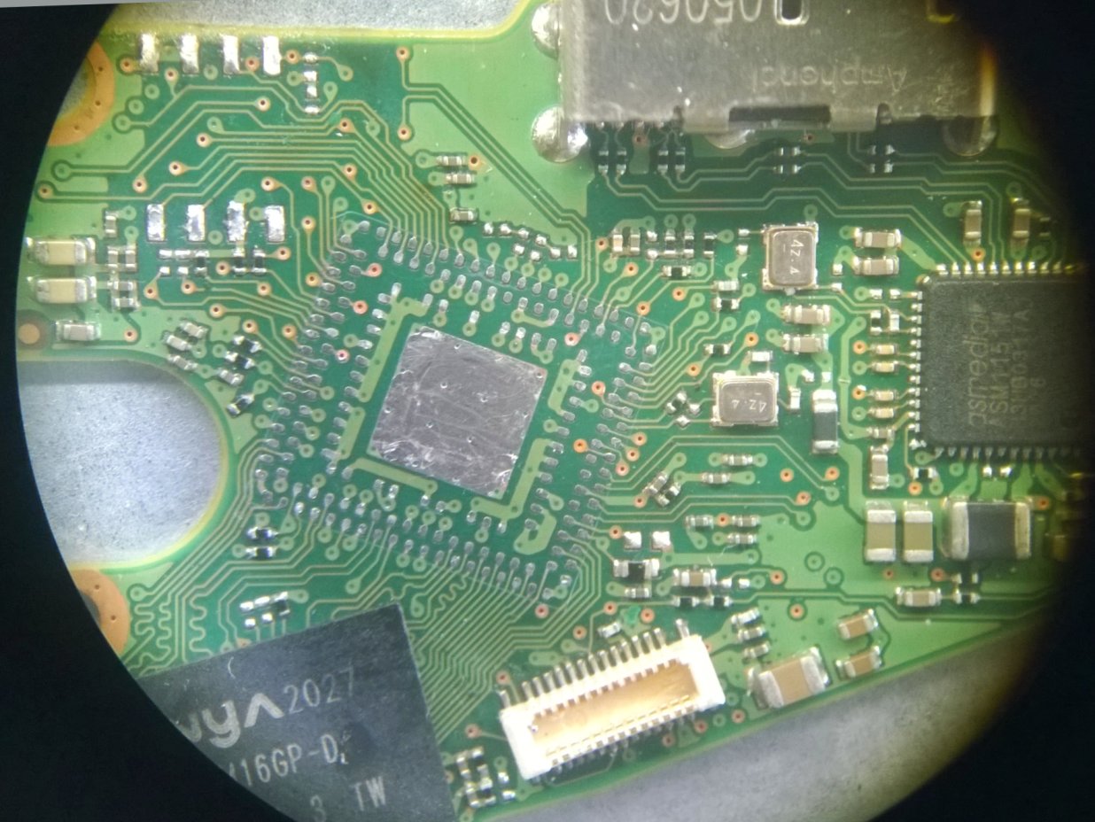

 Post subject: Re: WD50NDWZ-11A8JS1 with physically broken circuit board
PostPosted: August 29th, 2023, 4:54
Joined: July 7th, 2014, 6:44
Posts: 225
Location: Switzerland

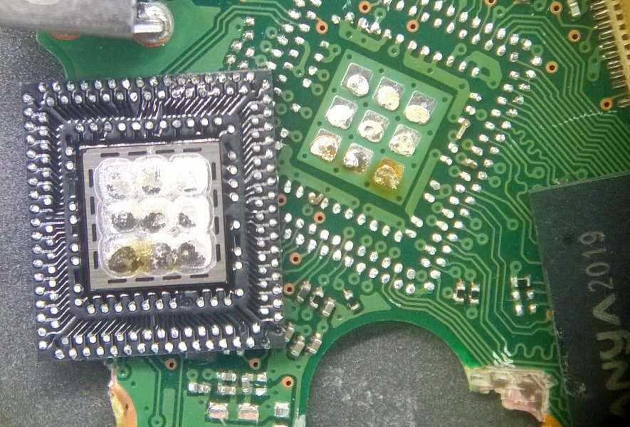

File comment: Marvell MCU unsoldered from PCB Western Digital 2060-810035-000 REV P0
I received the replacement PCB and started the work to transfer the MCU that contains the encryption key.
Appart from the solder balls on the edge, I am not sure about how to tin the central part with the the nine square-shaped welding points.
On the MCU, when cleaning the old weld, I cannot distinguish nine pads, but a single tin lake that covers the whole central zone.
For now, I assume the square-shape pads on the board are only for heat dissipation. Can someone confirm?
(I didn't check yet the MCU datasheet.)
I wonder which is the best way tin these square pads to ensure uniform brazing thickness throughout the MCU.
Should I place a number of solder balls on the sqare pads?
Or renounce to reballing and just leave enough smoothed weld on each solder point of MCU?
PostPosted: August 29th, 2023, 5:12
Posts: 1303
SOSdonnees, They look to be ground- confirm with continuity check to a screw hole. You can just leave a small pillow of solder on each.

I think you should concentrate more about the tore off data lines...
PostPosted: August 29th, 2023, 8:36
Posts: 225

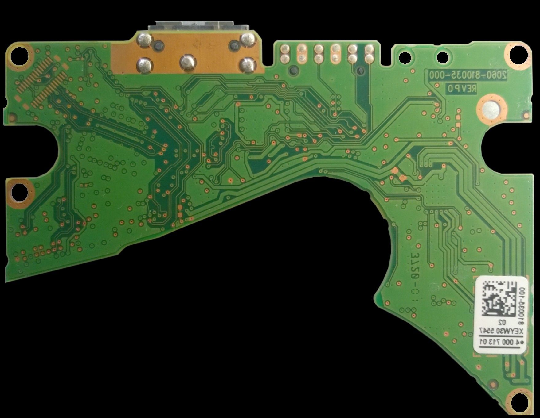

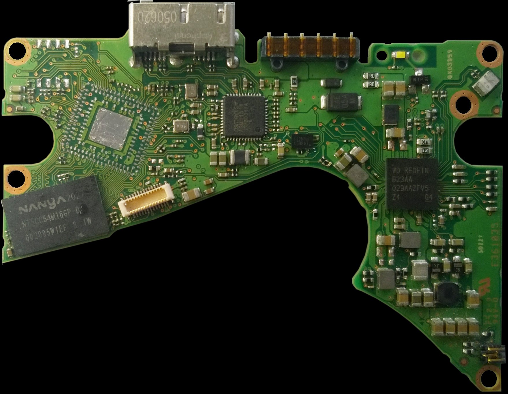

Yes, you are right. The MCU is a Marvell 88i1054-NXZ2 . So far, I could not find its pinout datasheet.
I prepared two pictures of the 2060-810035-000 REV P0 donor board, front and flipped back face, that I cropped and scaled in Gimp before exporting to Jpeg format. They can easily be reimported as overlaid layers in Gimp and after adding an alpha channel, their opacity can be modified, to facilitate the understanding of the tracks.
(I still have the Gimp .xcf image, but it is 13MB with PNG layers.)
I don't have time to study this case further today.
File comment: Detail of WD 2060-810035-000 REV P0 PCB at MCU location (MCU removed)
PCB-2060-810035-000-REV-P0_donor-board-detail-MCU-location.jpg [ 198.54 KiB | Viewed 4483 times ]
File comment: WD 2060-810035-000 REV P0 PCB, back face, flipped horizontally
PCB-2060-810035-000-REV-P0_donor-board__flipped_cropped_image_verso.jpg [ 196.65 KiB | Viewed 4483 times ]
File comment: WD 2060-810035-000 REV P0 PCB, front face
PCB-2060-810035-000-REV-P0_donor-board_cropped_image_recto.jpg [ 300.93 KiB | Viewed 4483 times ]

Sorry to say, but this looks like a dead case for me now.
Can't imagine, that all four torn off data lines are unimportant and someone is able to fix the pins.
For sure a very difficult case, but I cannot consider it as dead yet, because tracks can possibly be repaired.

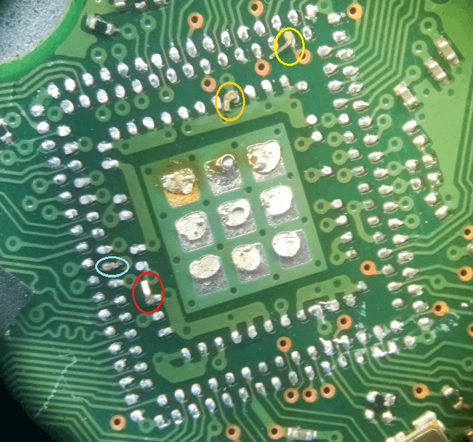

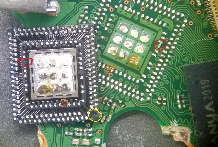

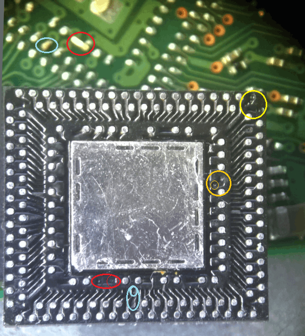

Here are two more pictures of the MCU and tracks on the board from the patient drive.
Regarding second picture showing the MCU, for the pin circled red, I can reach the end on the copper track relatively easily.
Within the orange circle, things are more difficult, but the end of the copper track is still visible and can be further "excavated".
The thin tip of my Weller MLR-21 microsoldering icron is a giant as compared to the thickness of the tracks, but repairing them at those two locations still appears doable to me.
The tracks within the blue and yellow circles are currenty not visible, and removing some coating appears tricky because of the wrinkled topography of the "monolith" with deep canyons and because the copper tracks appears to be very thin.
File comment: PCB tracks below MCU on Western Digital patient board 2060-810035-000 REV P0
Tracks-below-MCU-on-patient-PCB-810035_annotated.png [ 250.51 KiB | Viewed 4402 times ]
File comment: Controller Marvell 88i1054-NXZ pinout side (bottom side)
Controller-Marvell-88i1054-NXZ2-pinout-side-annotated.png [ 210.1 KiB | Viewed 4402 times ]
The relatively poor quality of the pictures is because they were taken with a smartphone through the 10x eyepieces of the stereomicroscope.
My microscope is a Nikon with 3x magnification and 10x or 20x eyepieces. I will likely use the 20x eyepieces for this job.
