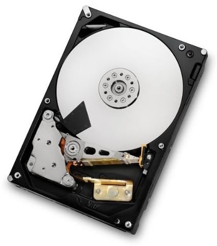

Yes, 5 thin platters and it does have a ramp. Well, that is assuming they put the correct picture in the technical docs;
Also: "The upper and lower magnet of these drives are connected and can't be disassembled by classical methods. This means that heads must be disassembled together with the magnets. This support tool secures position of heads in relation to both magnets during heads replacement process".
I won't be opening the drive myself.

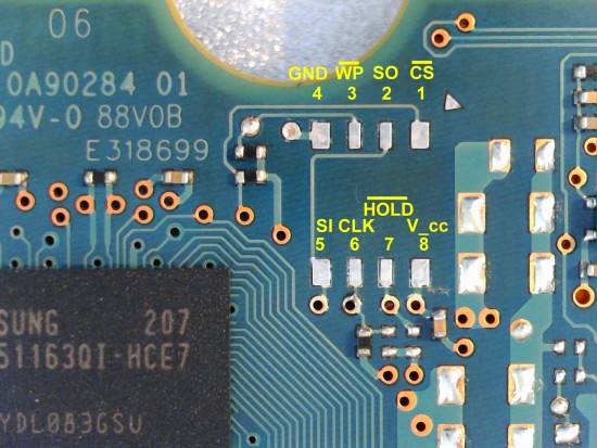

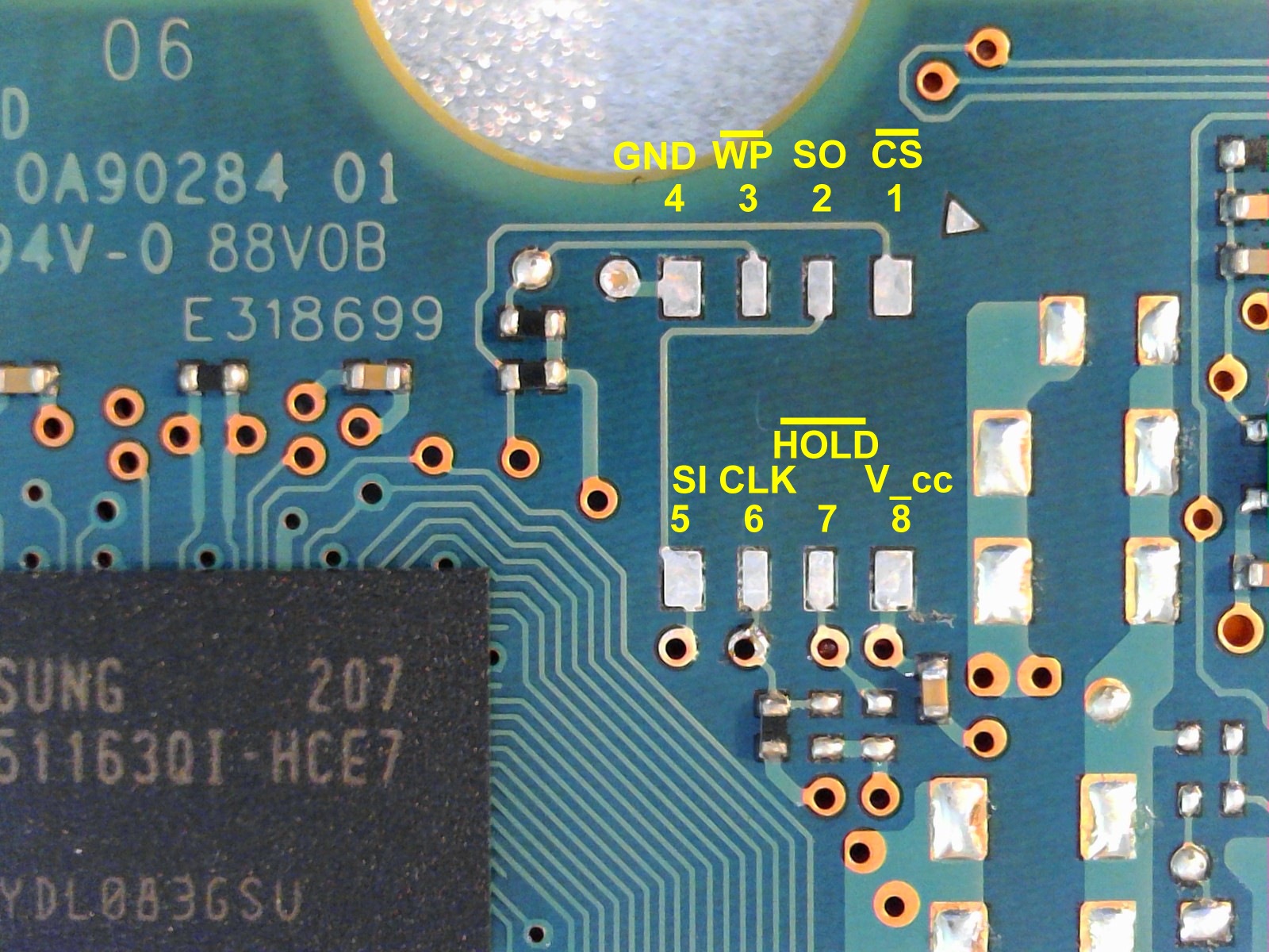

Wonder if it'd be possible to dump the ROM while it's soldered to the board. Pins 2 (serial data out) and 5 (serial data in) are connected to each other on the PCB. Does this make sense?
 Post subject: Re: Dead Hitachi HUA723020ALA641 2TB 3.5" 7200rpm (Jun-2012)
PostPosted: September 18th, 2023, 18:02
Posts: 17335
I guess that would be OK if the MCU were using the one GPIO pin in bidirectional mode, but it's not something that I would expect. Is there actually a direct physical link between the two pins?

Yep, there's a direct trace between the two pins, right under the chip;

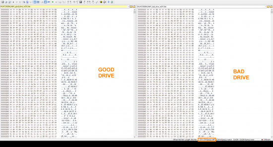

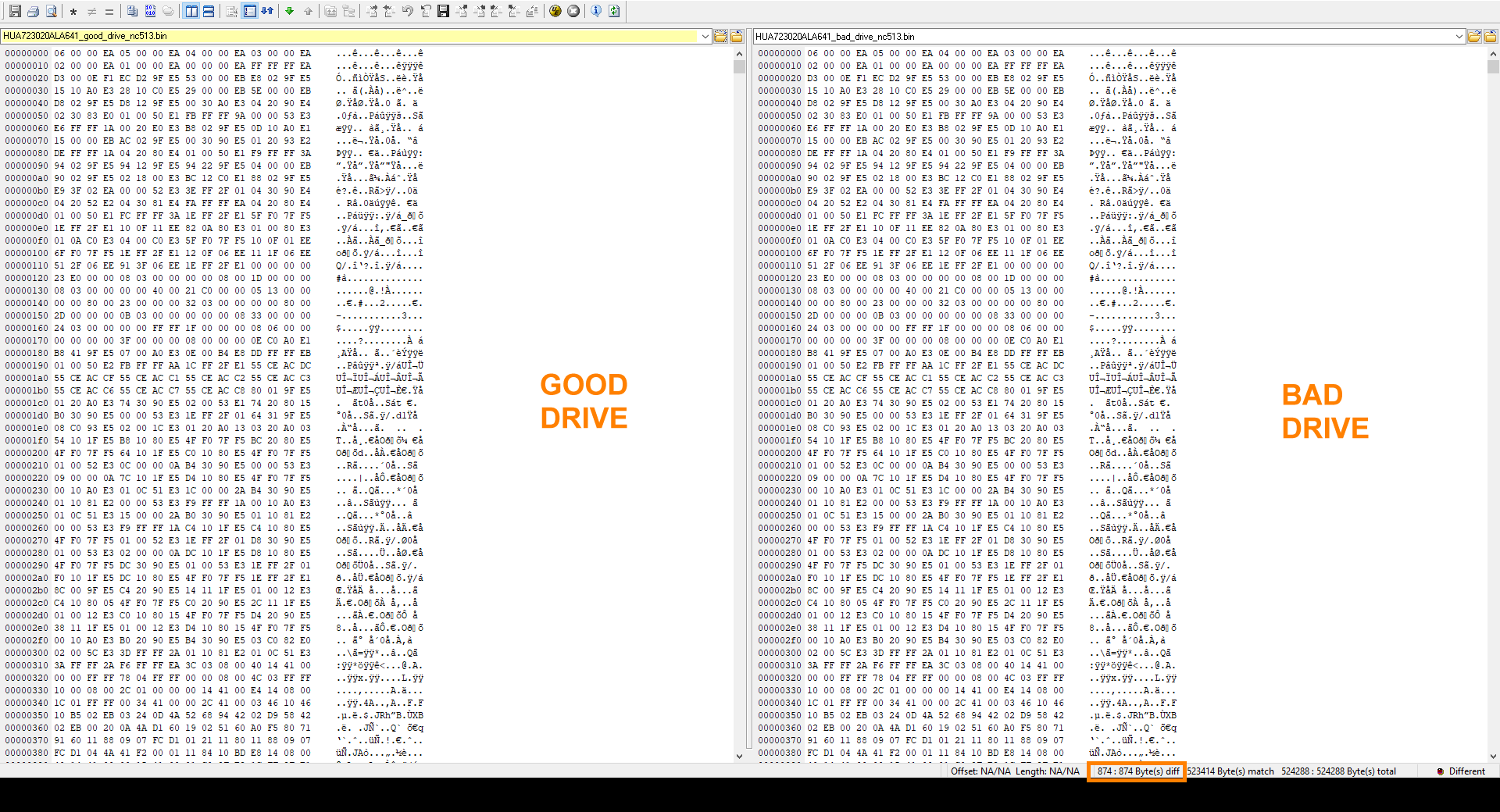

Well, I've now dumped the ROMs (out of circuit) of my two Hitachi drives; both the bad and the good one. Would anybody be able to tell if they look like proper drive firmware and if the way in which they differ seems logical? Zip-file with .bin images attached.

The structure looks OK to me. They differ in the NVRAM data, but that's because this data is unique to every drive.

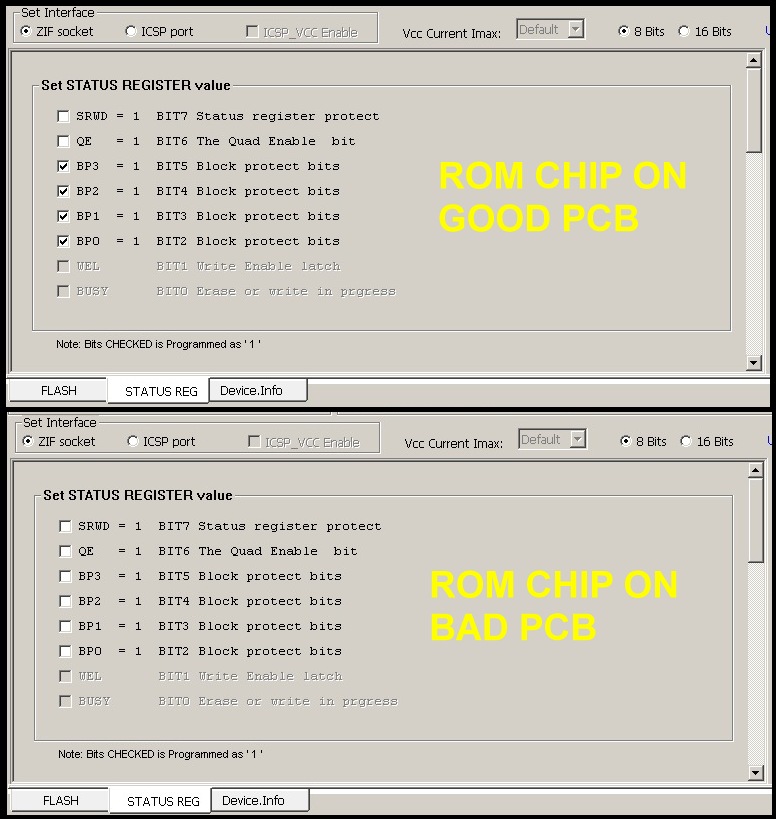

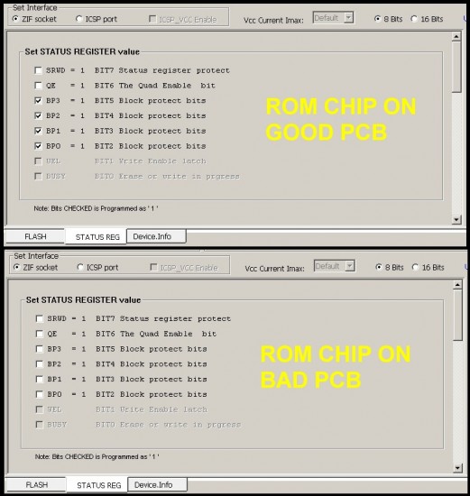

Ok, that's good. What about these differences; anything to worry about?

I would think that protection bits would only be of concern during a firmware update or a write to NVRAM. One instance of an NVRAM write that would occur during normal operation would be if the user were to enable Power Up In Standby (PUIS). In such a case the PUIS flag would be written to NVRAM. I can't think of any others.
I think you are wasting your time looking for a problem in the ROM.
