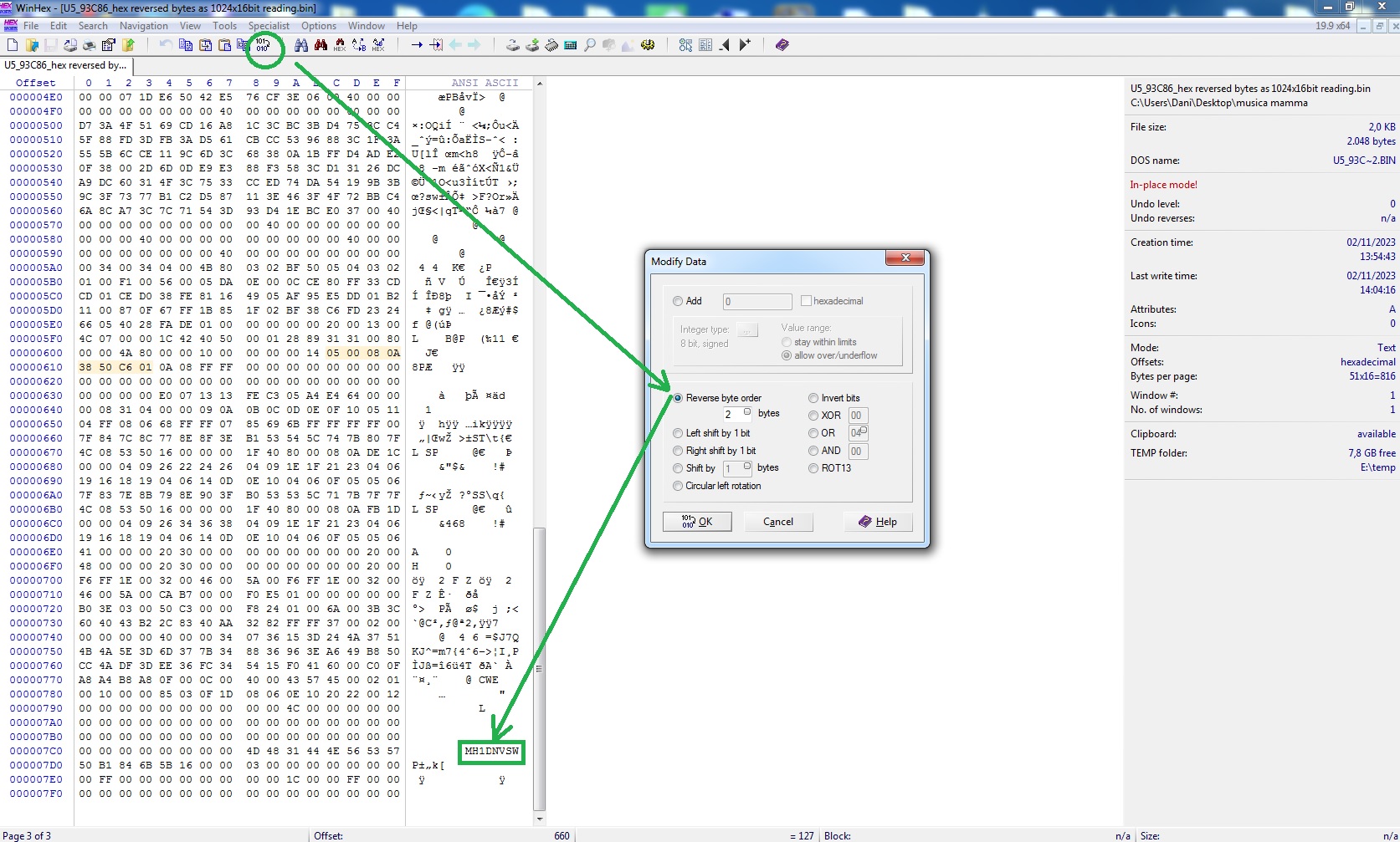

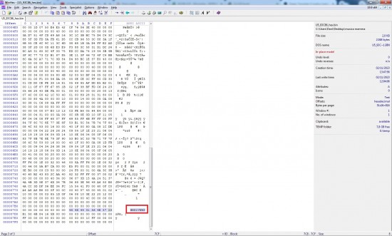

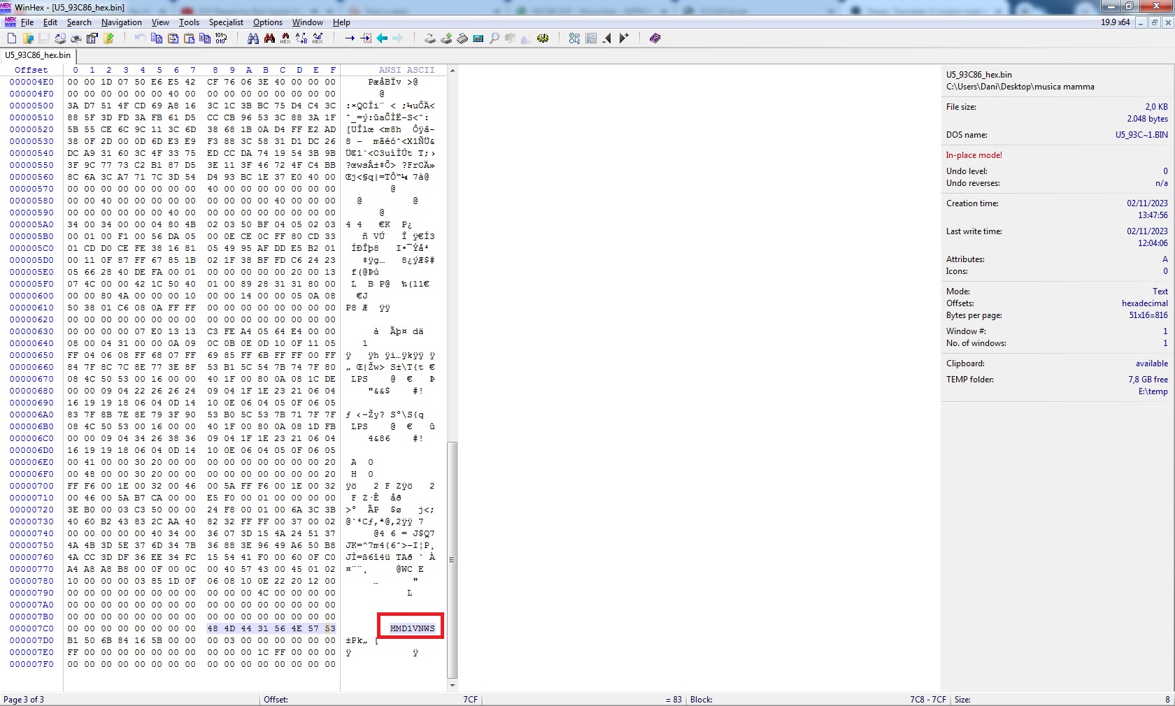

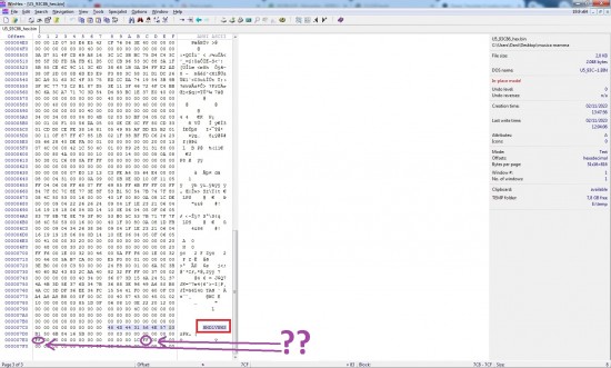

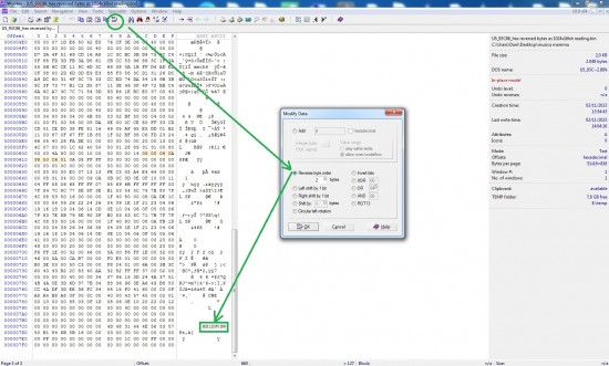

Re: HDT721010SLA360 - where a problem might be
November 2nd, 2023, 9:33
John1 wrote:Or is it 1024 x 16-bit organization?
Yes, i believe it should be read as 1024x16bit, because i see in hex editor that your nvram dump has flipped byte order.
As you can see at the end of the BIN file, the serial number has flipped chars.
Read it as 1024x16bit or just reverse bytes by 2 in WinHex... well i already did it for you.
This is the nvram file as should be

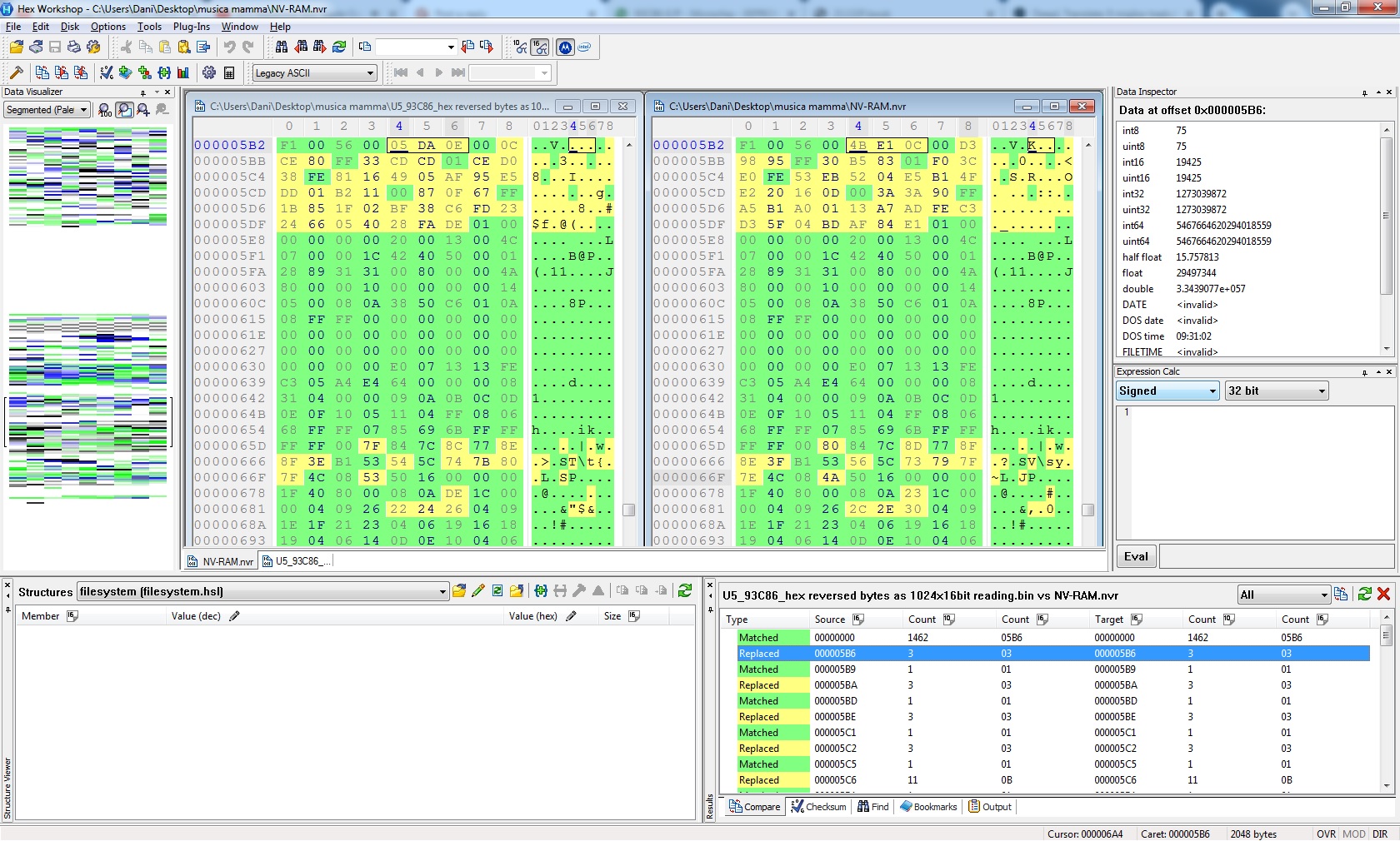

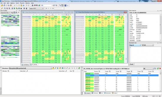

I compared your "fixed" nvram file with the one inside the fw resourse i've posted yesterday from fw version ST6OA31B... they're very similar so i think that the structure of your nvram is ok... but someone who has better experience than me maybe could see something wrong... i don't know.
Of course they can't be identical, nvram has unique data... i can show you the differences
the picture is not complete, but you can check in log the offset where bytes are different (called as "replaced"), but that is normal because portions of nvram are unique
Content comparing.txt
(2.62 KiB) Downloaded 634 times

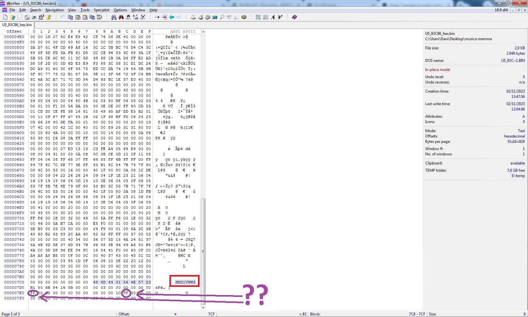

November 2nd, 2023, 9:54
WAIT !
I see at the end of your nvram those 2 "FF" bytes, on nvram from fw resource i posted yesterday those are "00"
I think those two FF should be 00, but i don't know if that can affect on hard drive power up, it's better to ask an opinion to Frank or Pepe about it.
