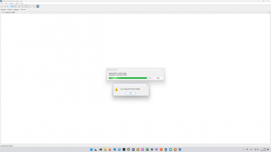

Doing what exactly?
After "Click 'all found / virtual file system' > pure FS".
It is shown in "Screenshot (188)"
Oh and, what happend to 3rd disk anyway? It failed you said, but how exactly, is it dead?
Yes, it's dead
the heads are broken

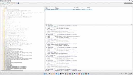

Avenge7058 wrote:
Also, when I look at MFT between LUN#0 and #1, on LUN#0 it shows file names etc.
However, on the LUN#1, it's not
How did you get there, just scroll MFT?
Yes

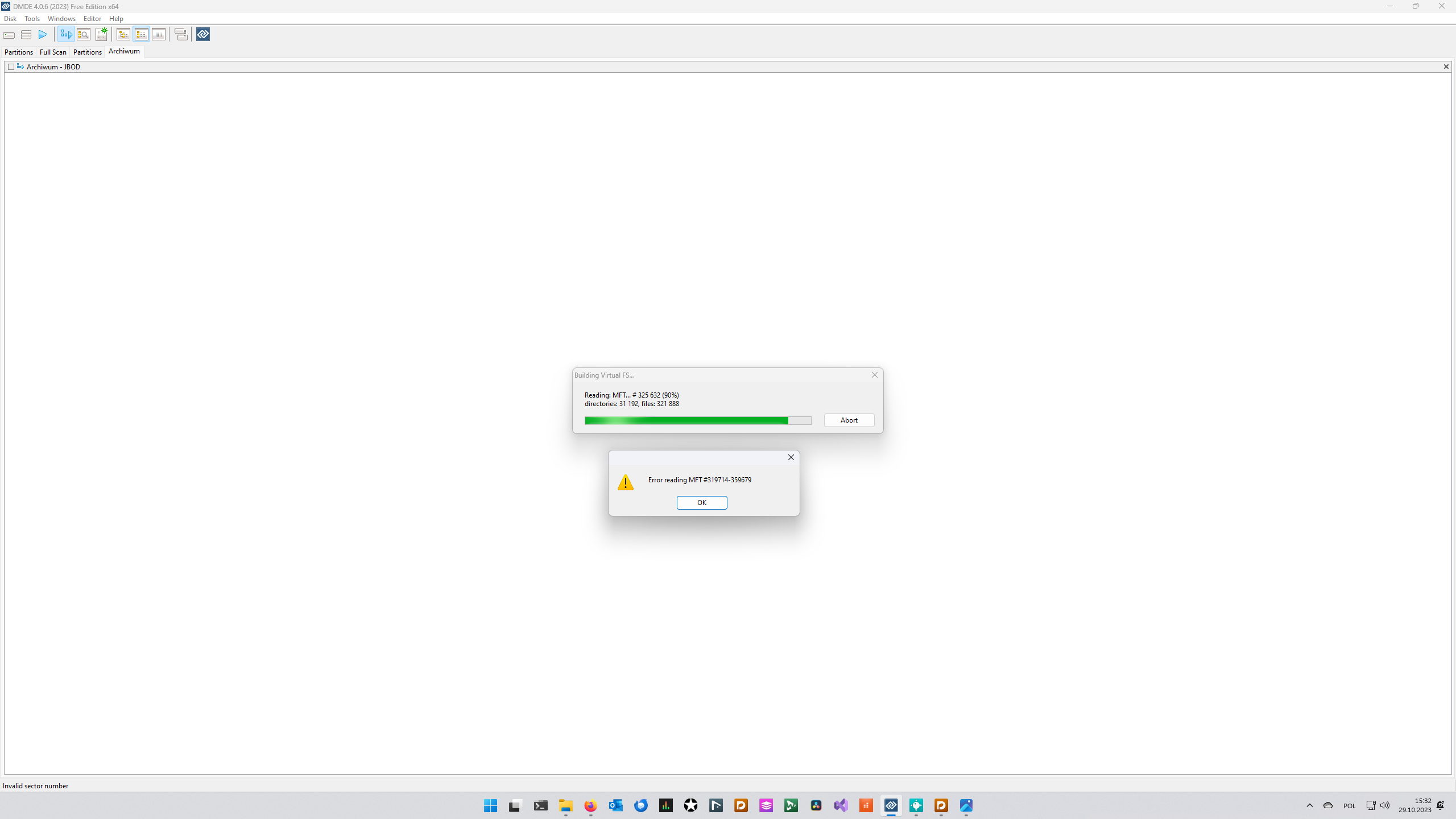

Just occurred to me we see MFT break at record 204928 but pure FS reconstruction complains about record 230945 which suggests it may be physically unable to read location where it expects 230945. Did you add that null disk again? If not it suggests part of MFT was on drive 3.

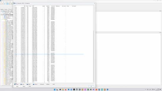

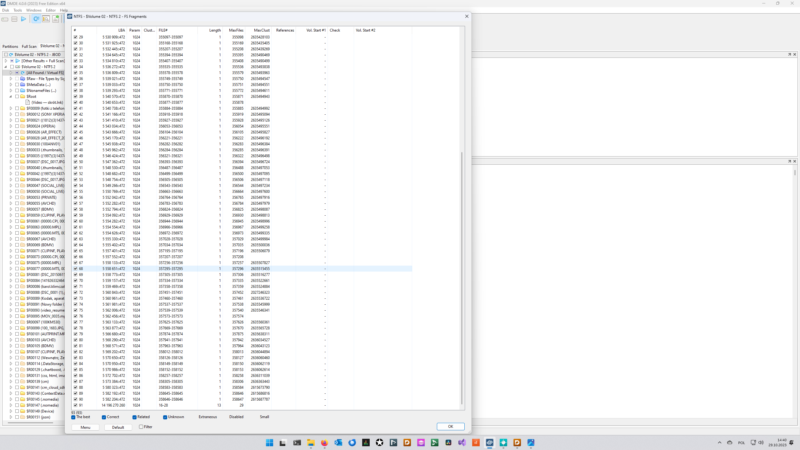

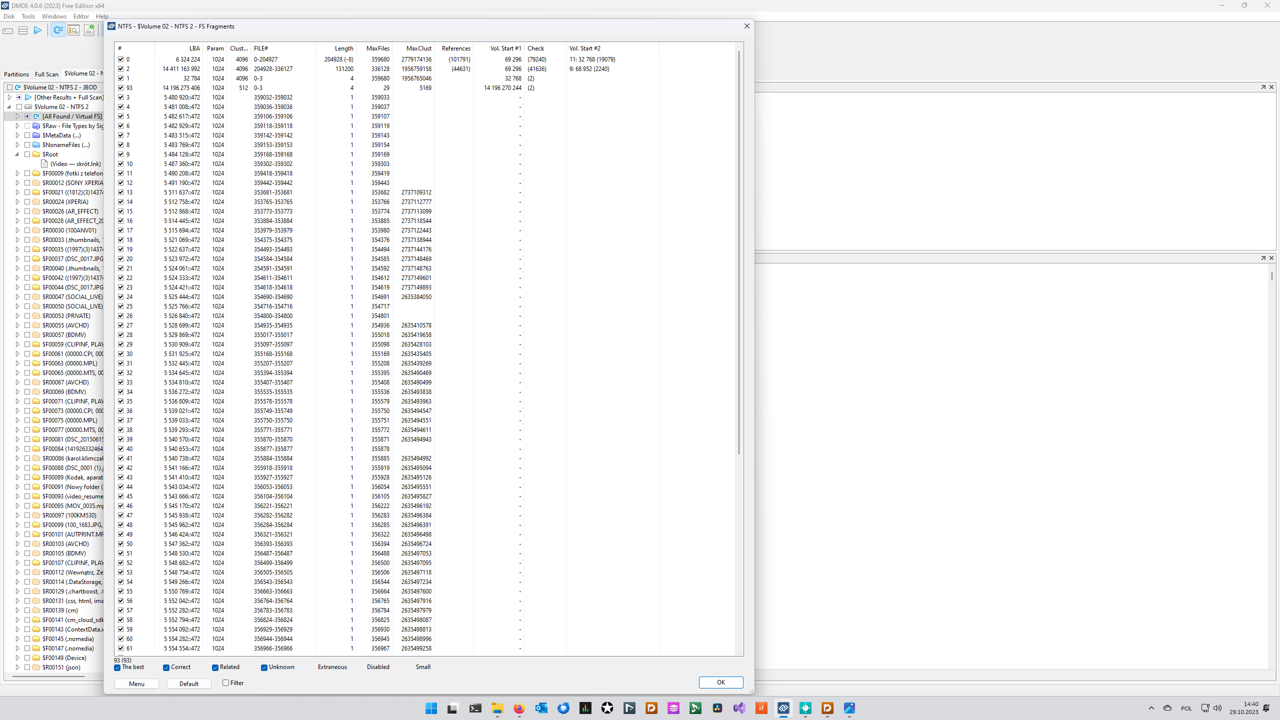

I can see something like this:
 Post subject: Re: Help me assembly JBOD/spanned in DMDE with missing drive
PostPosted: October 29th, 2023, 10:01
Joined: October 28th, 2023, 10:28
Posts: 23
see if MFT chunk is found that starts with 204928
Yes I found it
it's the second one on a first screenshot
It was just one of many

It found it @ LBA 14411163992 while 'we' expect it @ LBA 14411094669 + we need to consider you reassembled with offset 0 rather than 32768. So it basically found it at 14411163992 - 32768, right? So 14411131224.
So we're 14411094669 - 14411131224 = -36555 sectors off, right? .. I don't get it, you?
@fzabkar, you see it?

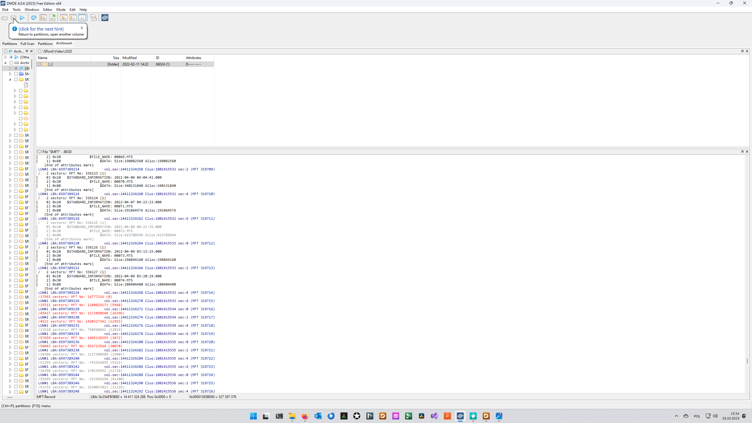

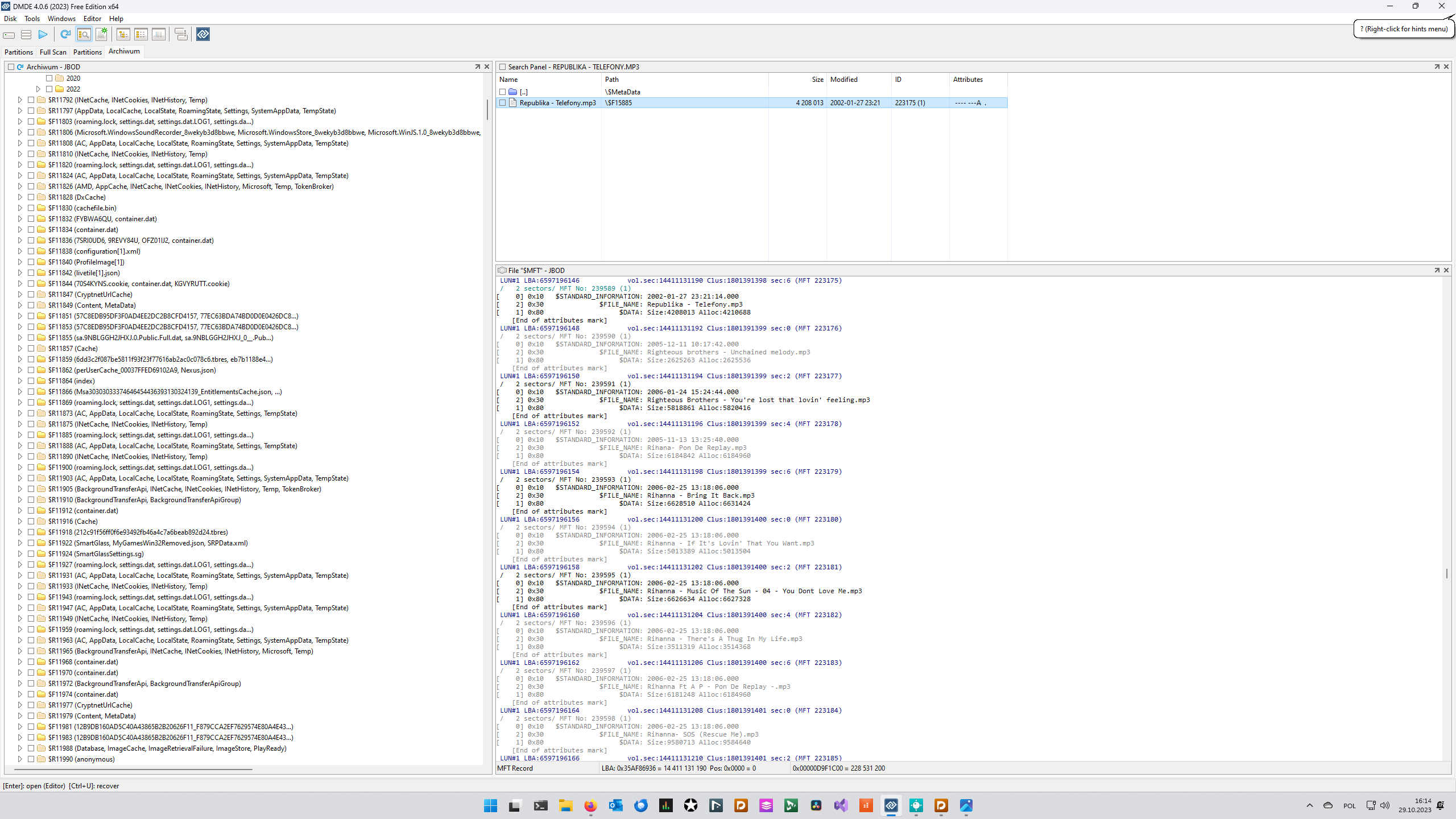

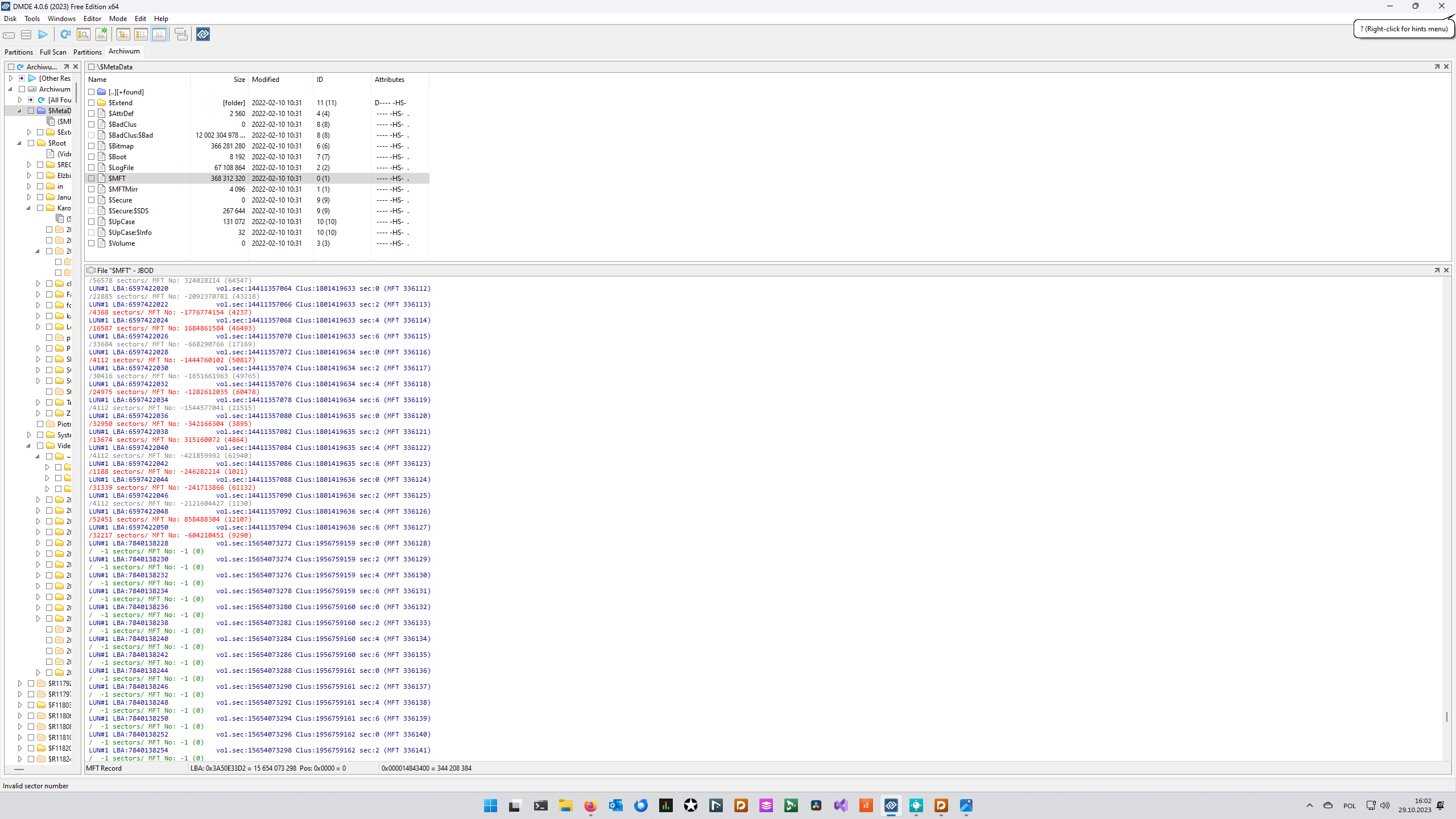

Arch Stanton wrote:
You could try make first member 36555 sectors smaller., we're just 8 clusters off, somewhere. Use my offsets, not zero.
It made it better!
now it complained only once while building virtual FS, and we have some entries on LUN#1
PostPosted: October 29th, 2023, 10:48
Joined: May 13th, 2019, 7:50
Posts: 1167
Location: Nederland
But you need to check some files. Okay it and then preferably check JPEGs that were written recently. See if you can preview them.

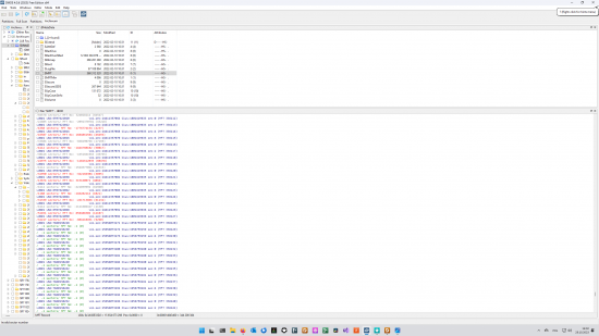

No, the files are broken which is logical since I think that if we still don't have a full MFT it means that we have offset somewhere so files will be read incorrectly?

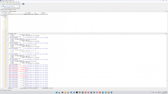

And I don't know if it's helpful, but when I scroll down on this MFT file further it changes to something like that:
PostPosted: October 29th, 2023, 11:07
Posts: 1167
Location: Nederland
Whether we have full MFT or not does not matter for files we have. If you have MFT entry for a file you have everything, but offsets become important then. MFT references clusters, cluster addresses and an address makes sense only against correct offset.

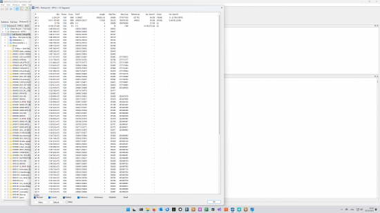

What I can add more is that these files from LUN#1 are in this wiried folders outside off myoryginal FS structure
PostPosted: October 29th, 2023, 11:29
Posts: 1167
Location: Nederland
At this point I'd try a full scan with offsets I gave.
