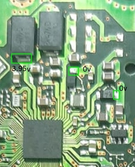

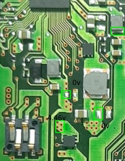

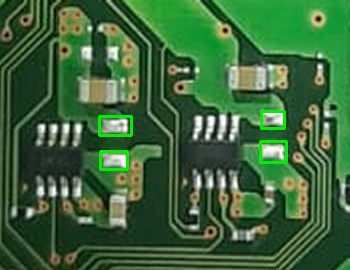

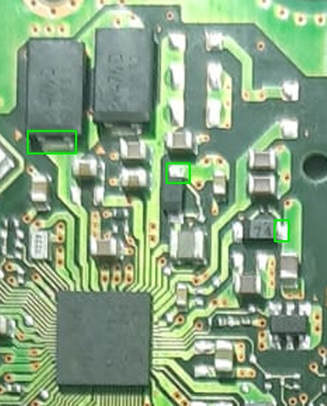

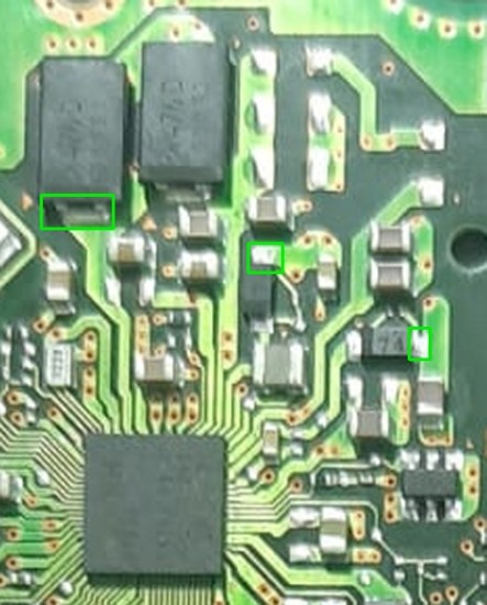

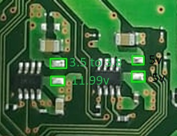

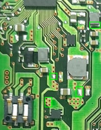

Can you measure the voltages at the marked test points?

pls find the volts measurement

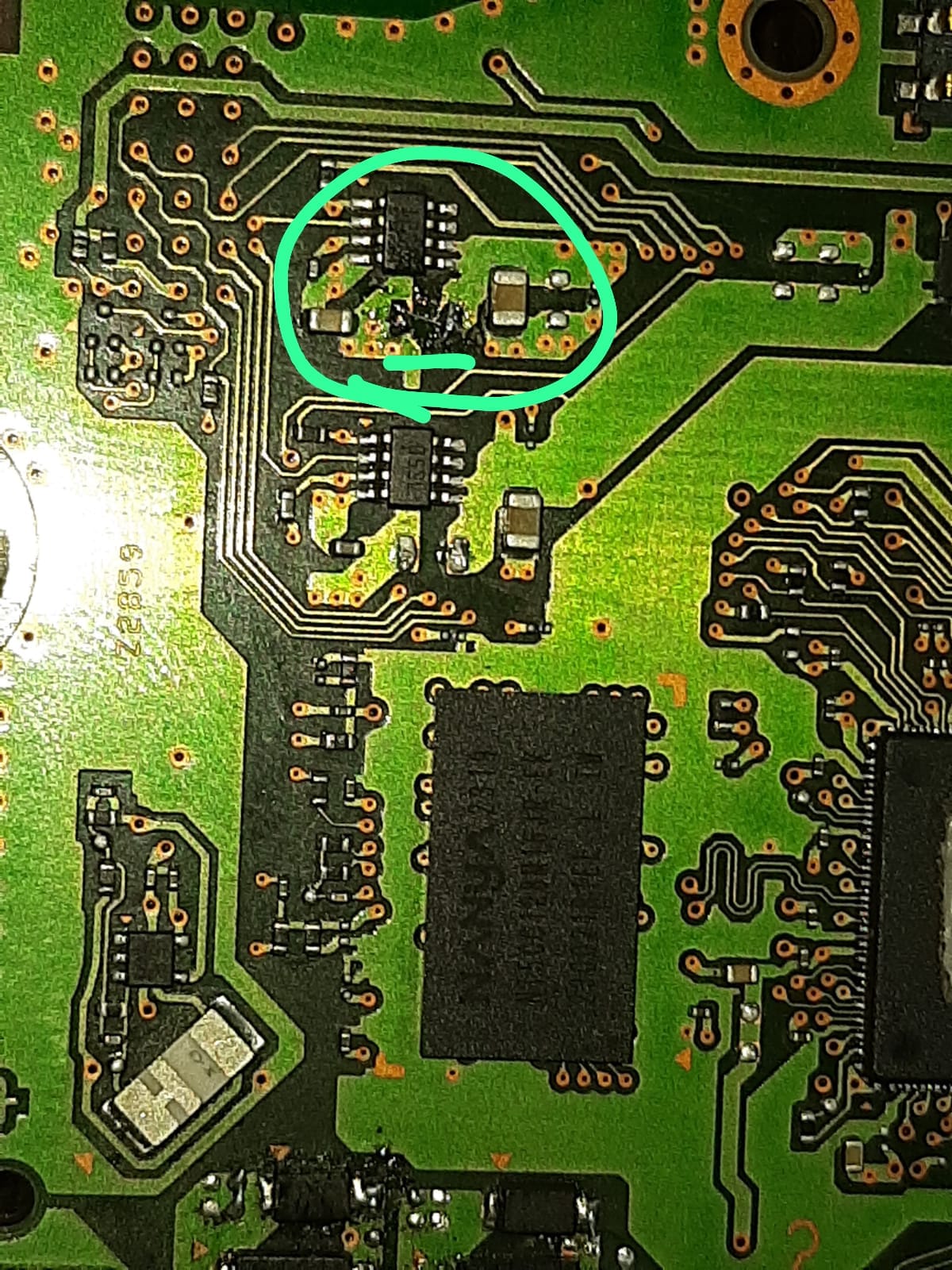

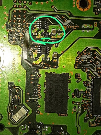

the12v efuse is open connect vin to vout hopefully this will fix the patient pcb
Can you kindly mark vin and vout
 Post subject: Re: Can somebody help me fix this rom its WD80EDBZ-11B0ZA0 D
PostPosted: February 20th, 2024, 9:19
Joined: July 11th, 2018, 10:55
Posts: 43

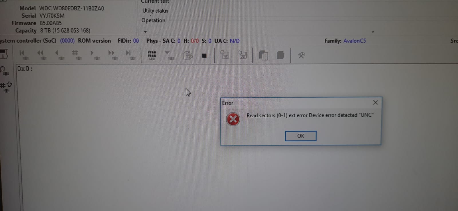

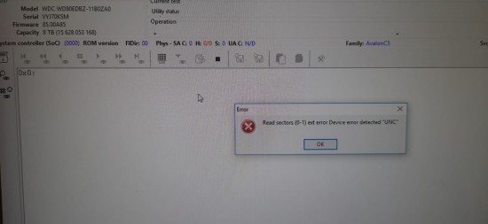

Hi Fzabkar i have connected vin and vout and patient pcb spins with patient rom i get full id in utility but no sector access i have attached the same for your reference

Hi fzabkar am also attaching the vin and vout which i connected and patient pcb power ups with patient rom comes with full id but no sector access as i already told roms get modified

this drive appears to have come out of an 8tb my book The Symptoms Are Consistent With The User Having Overvolted The Enclosure With A 19v Laptop Adapter THE USUAL RESULT IN SUCH CASES IS A SHORTED 12V TVS DIODE AND OR AN OPEN FUSE since neither u nor the other guy possess the basic skill to diagnose and repair such a trivial fault u should consider finding a different line of work what should have been an easy job requiring no more than an hour has now turned into a total data loss for ur client i will no longer respond to ur thread until u desist from offending me with ur unintelligible smsese rubbish please construct proper sentences with proper punctuation as befits a professional adult not some pretentious teenager

My sincere apologies Mr Fzabkar am extremely sorry for that, I do realize my mistake by the way of my text, Thank you for the support and time you seriously nailed it by bringing back the patient PCB to work again. You know as am not related to electrical or electronics, I get support from a laptop chip level service person for soldering and removing components from PCBs, When ever I get any hard drive with power related problems I seek help from them in order not to screw the patient drive as I value the importance of clients data. I would appreciate your skill so much. You did not even had the faulty PCB physically in hand you brought back the PATIENT PCB to life which my service person failed to do so. This hard drive was initially sent to another data recovery center before it arrived me, They have already removed both the ROMS(left and right) and I don't even know whether they put it back in original position. But am not trying to say I have got sufficient knowledge in handling these drive even I screwed the 1st Donor by reversing the order of the ROMS(left and right), now even DONOR 1 has the same problem like PATIENT DRIVE, that is (PATIENT AND DONOR 1) both drive will spin up with native PCB and ROMS Drive will come ready but no sector access in PC3000 Utility.
But DONOR 2 here DONOR 2 means second donor, after learning from DONOR 1. I carefully kept the orders of the ROMS(LEFT AND RIGHT)properly and also took the ROMS backup initially with ROM Programmer. Here as I have the initial backup for DONOR 2 ROMS(LEFT AND RIGHT) I noticed placing the LEFT ROM TO RIGHT AND RIGHT TO LEFT, ROMS values get modified, But with initial back of the ROMS I am able to get back the drive work by writing the initial backup of ROMS.
