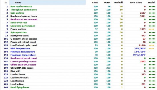

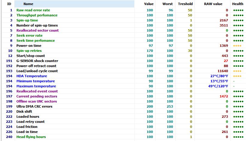

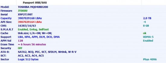

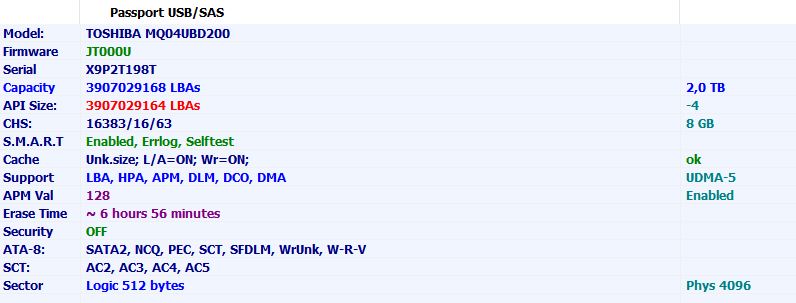

Now, my progress : I have used a donor board and programed a new ROM with the dump I made. And... it spins ! Hooray ! The disk appears in the explorer but cannot be opened. Back to stage 1.
I tried getting the SMART status with Victoria : Unknown :?
The details are in the screenshots atteached.
To be rigorous, what is the next move I should make ?
Thanks again, Masters :wink:

You see? You have a problem with the surface or heads or both (ID 197), probably due to a fall or something else (ID 191).
You can try making a binary copy to another disk or image, maybe reverse the copy (you can't mount the partition, so that suggests a defect to begin with).
If you don't have professional tools, we recommend using DDrescue (linux).
Be prepared for the fact that it will not be possible to create an image at home, you cannot create a heads map that can be turned off for reading (due to a weak head for example)...
Replacing the PCB was completely unnecessary.
