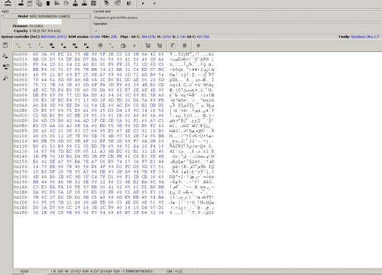

that means to me that decryption is not activated with the foreign mcus at all in this case...

I would see what happens to the patient when you import those 4 modules from a donor, one at a time. Or perhaps you could zero out the signatures one by one, or flip one of the bits.

1B0 is not unique, 1B6 is only unique from 001E-009E, 1a2 is unique, related to SED lock, 181 is not unique, servo params.

Looks like the encryption was not inited properly.
Data decryption depends on ASIC keys, Flash modules and SA modules. Changing any of these will result in decrypted data showing different patterns (there are no ways for the drive to tell if the keys are original), unless the encryption engine was not initialized.
The two donors would have different ASIC keys, so wouldn't you expect that they would produce different encrypted data? Since they produce the same data, doesn't this suggest that the "encryption engine was not initialized", and doesn't this then suggest that they rejected the ASIC key (because that is the only thing that is different), which in turn suggests that they know that the key is foreign?
absolutely
very likely
No, it's probably HOW the drive was initialized is the culprit here, not which PCB was used.
I know for a fact that there is no way for a drive to check if the keys are original.

einstein9 wrote:
I wrote the same ROM without any modification to those USB pcbs and as i said before and others too
Unique encryption key is located inside MCU (original pcb) not related to the ROM itself only
I understand you but you don't understand me. I'm saying that, if you want to know which ROM module is responsible for your observed behaviour, then disturb each of the possible culprits by invalidating one of its "signatures". @pepe has now told us which areas are unique, so I would concentrate on those.

Doomer wrote:
DDDD is a security overlay for initial security initialization and digital signature (of code modules) checking
how do i double check this process? or how to tell tell if its init. properly?
as i mentioned, i tested this on SpyG2 Ultra, looks like need to try another family to verify
so, the enc. pattern is supposed to be different here right (sec0 for example as i uploaded) ? when we write Original (none patched ROM) to any other none-native usb?

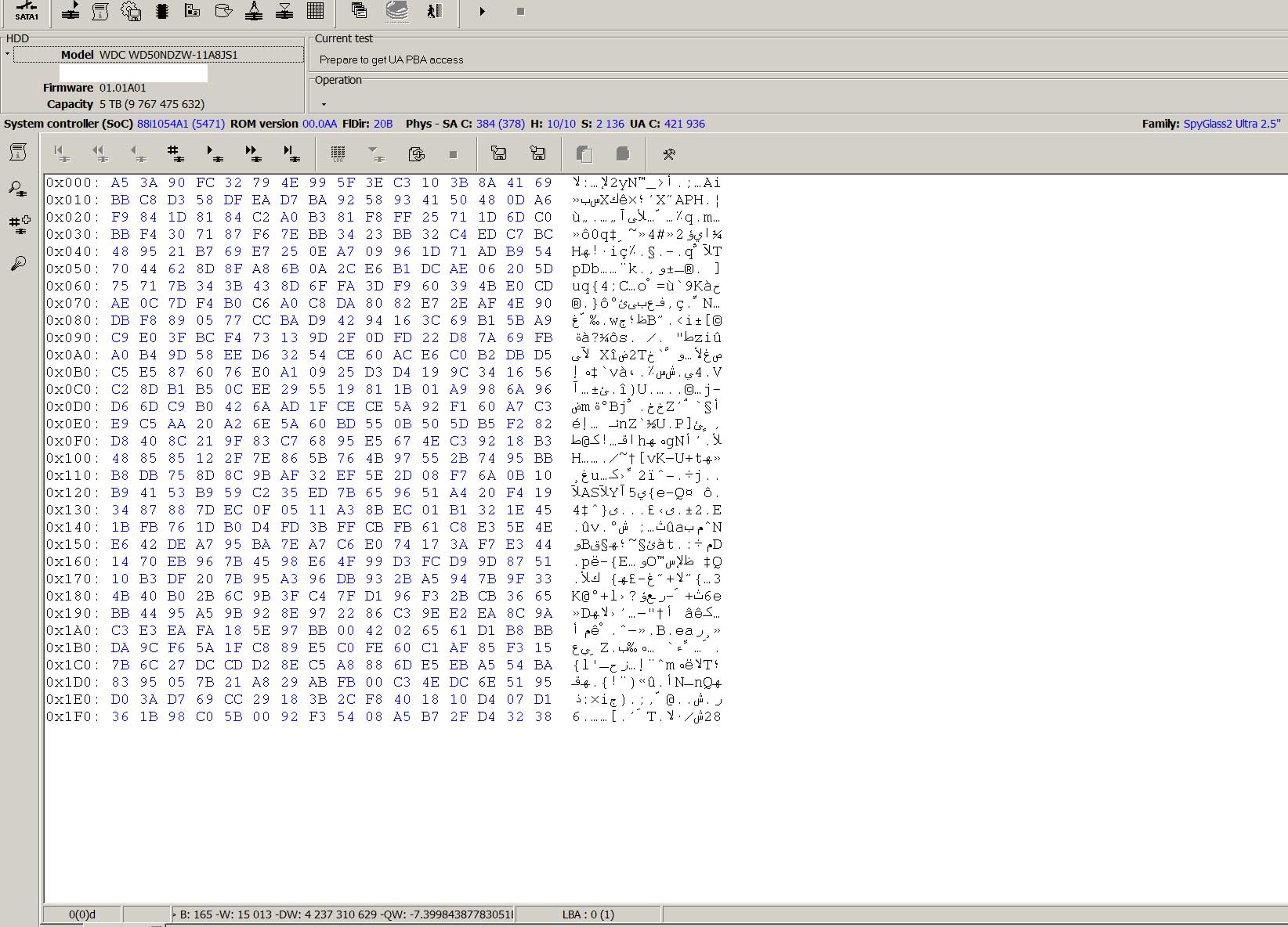

Here is sector 0 again with SATA pcb results is Same Enc. pattern
Am not sure if this exception is related to the Case itself or family?

The capacity reported via SATA is the same as is reported via USB, namely 9767475632 sectors. The full IDEMA capacity of a 5TB drive is 9767541168. That's a difference of 65536 sectors. I usually find that removing the bridge hardware exposes the full capacity of the drive. :-?
As for the pattern being the same, that would be expected since the area where the USB key is stored has not been decrypted by the MCU key.

fzabkar, Those NEW MCU locked pcbs are completely different than the old encryption types... totally new
something (unique key probably) stored inside the native MCU (USB3 pcb)... without it NO DATA
My point here or question is: Why the hell no matter what pcb i use (sata/other usb3) the data is encrypted with the same pattern?
does this means something????
Doomer says: "encryption engine was not initialized."
that's what i was trying to say, pattern is the same no matter if SED is on or off, this means decryption is not active and you see the encrypted data with whatever pcb you try.
you need to find the reason why.
